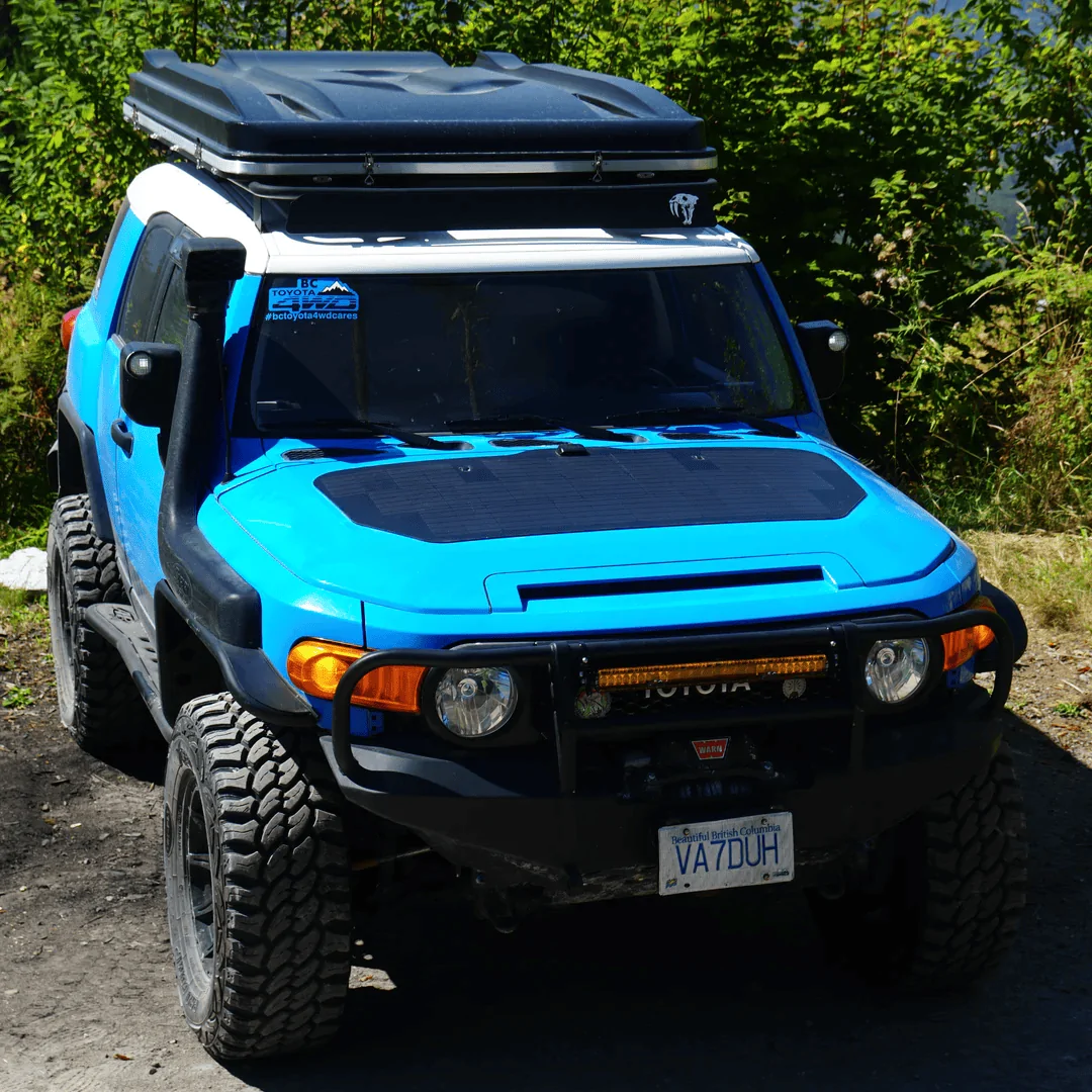

If adding a trickle charger to the onboard 12v system, I'm assuming one would need to add an isolator to allow for 2 charging sources (DCtoDC and then solar).
Anyone done this yet?
Additionally, maybe something like this would be useful for minimal aero impact:
Rivian R1T R1S Solar charging while camping? "thoughts" 1699938594278
