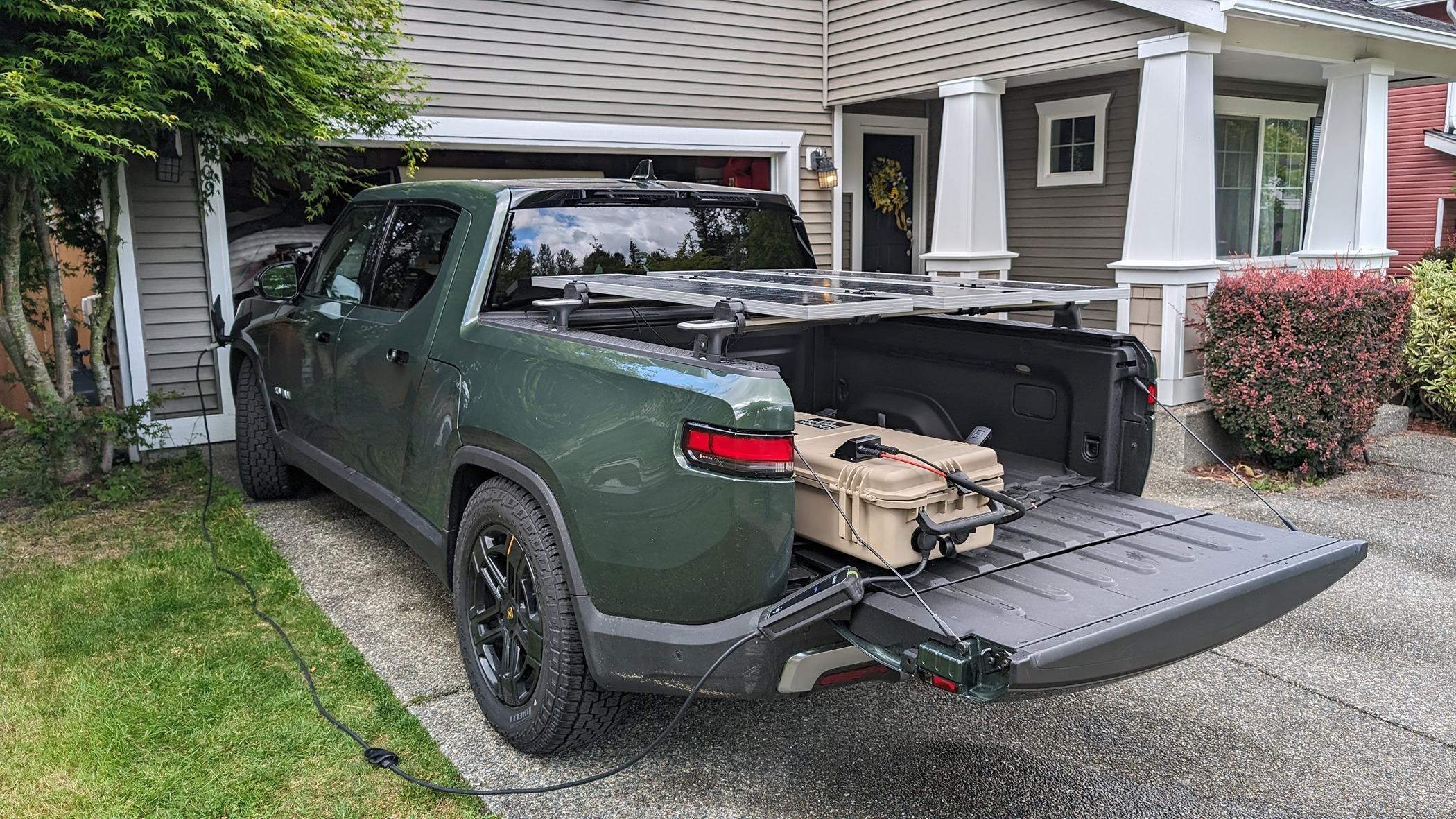

There is potential for very limited vehicle solar charging in the right solar situation. As an example, I carry an Ecoflow Delta Max with two smart batteries (6 kWh total storage) in my ICE truck (RAM 2500). 320 W of solar on the truck cap (two thin film panels, no wind resistance) charge the power station. I use this 6 kWh to supplement our Airstream power station when boondocking. (The Airstream has the same power station with 700 W of rooftop solar). It would take about 20 hrs of ideal solar conditions to recharge the truck power station. Practically speaking, figure twice that. I have used the power station to charge our Polestar 2, and gained 10 miles of range in three hours, depleting the power station. So yes, one could add range while boondocking, but you’d need a lot of solar and patience. Still, it’s fun to experiment.

200 Watts, in a perfectly sunny location, always aimed perfectly, would produce enough energy per day to drive about 4 miles assuming perfect energy transfer. It won't. realistically, you'd add about a mile of range per day. You'd be better off just charging up an EcoFlow or similar to run your camping gear off and leave the truck in low-power mode.
To be useful, you'd need significantly more solar panels - and that person acknowledges that the solar panels mounted on top to travel cause about a 20% decrease in range. Basically offsetting any power they could add.
Your math checks out!
