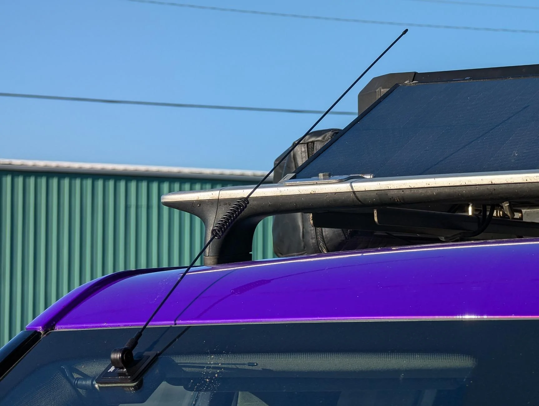

I have one mounted to a bracket between the cargo bars on the roof that acts as a fairing for the RTT, but also can lay down flat if the tent isn't on .

I wouldn’t attach one to my Rivian since the miles lost due to drag would probably be higher than miles added. Plus the cost of a solar generator, mounting setup and wiring. The solar generator would need to be in the open bed of the pickup due to its cooling needs. I would also secure the generator to avoid it being unintentionally donated to those that believe they deserve it more than me without paying for it. Additionally one would need to religiously monitor the solar generator state of charge to know when to plug in the vehicle. Today my two 500 watt panels added 5 miles to my T but I could have added 2 more (ended up with higher charge in the solar generator than started with). This is the about the best day of the year. One panel would probably net 200-400 miles per year but aero drag would probably be more than that. If I still haven’t talked you out of it, I would use aluminum square tubing to mount it to the crossbars with minimal overhang in the front. Mounting it that far back would put it above the bed and would make the bed less useful.
