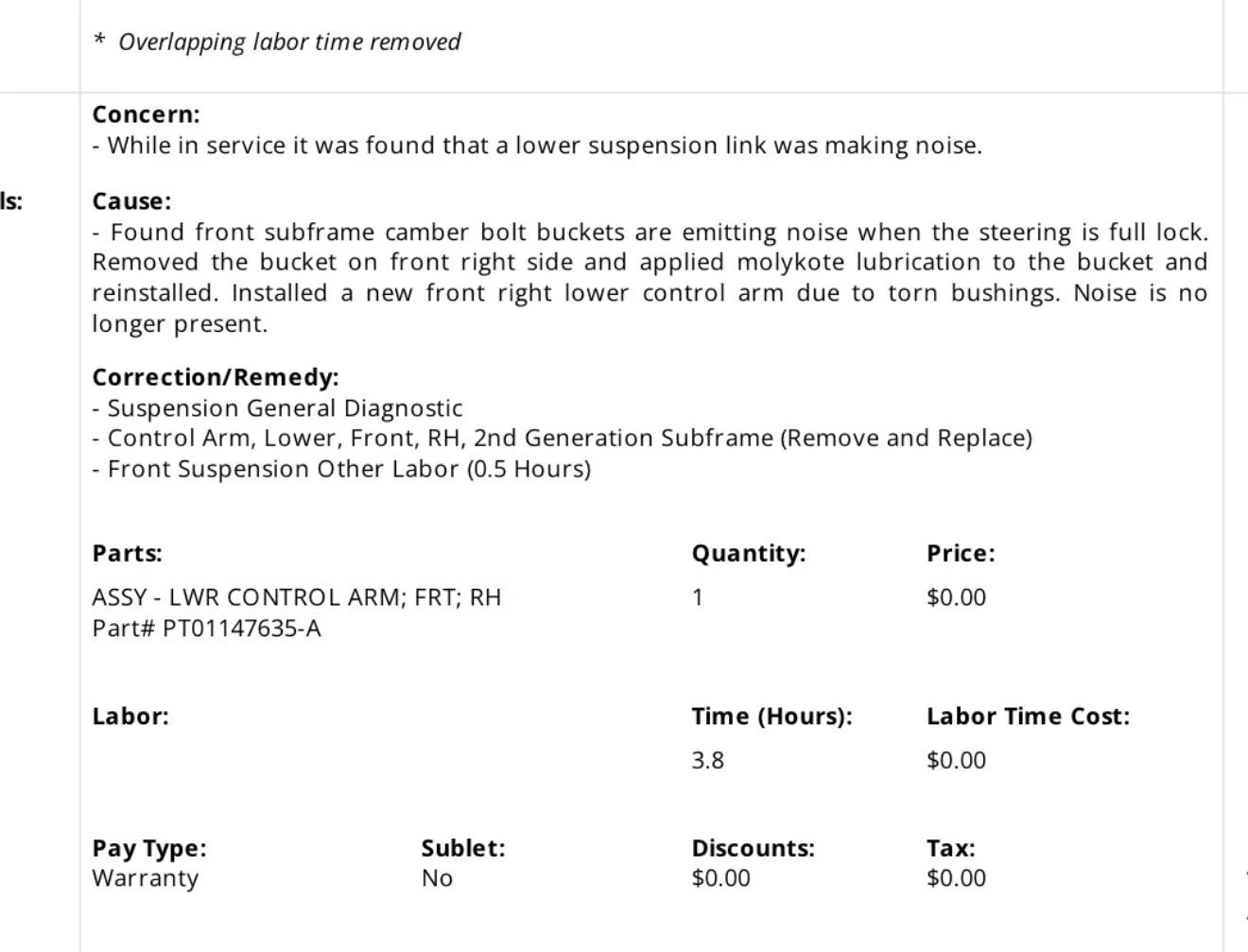

Love it how everyone thinks they know the issue even though this OP with 7K miles knows it isn’t the brakes.
That’s because it isn’t the brakes. Mine did the same thing. Only starting from stop and only going forward. And guess what…not the brakes.
