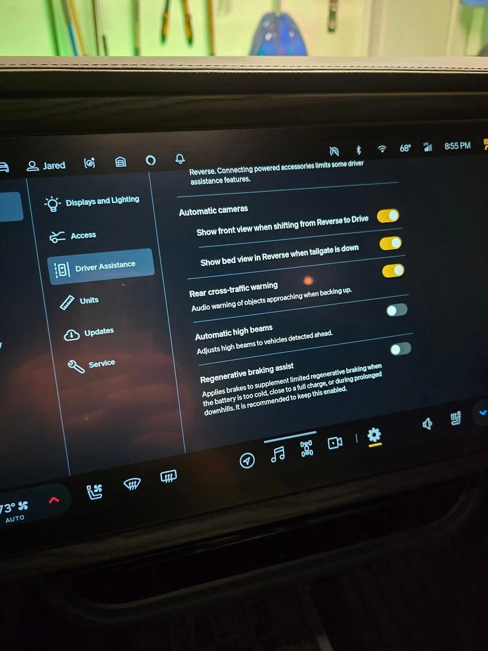

It's definitely the assist, as regen braking doesn't use the hydraulic brakes. ACC and HWA will, however.
Rivian R1T R1S Squeaky Regen Braking - Help 20241007_205523

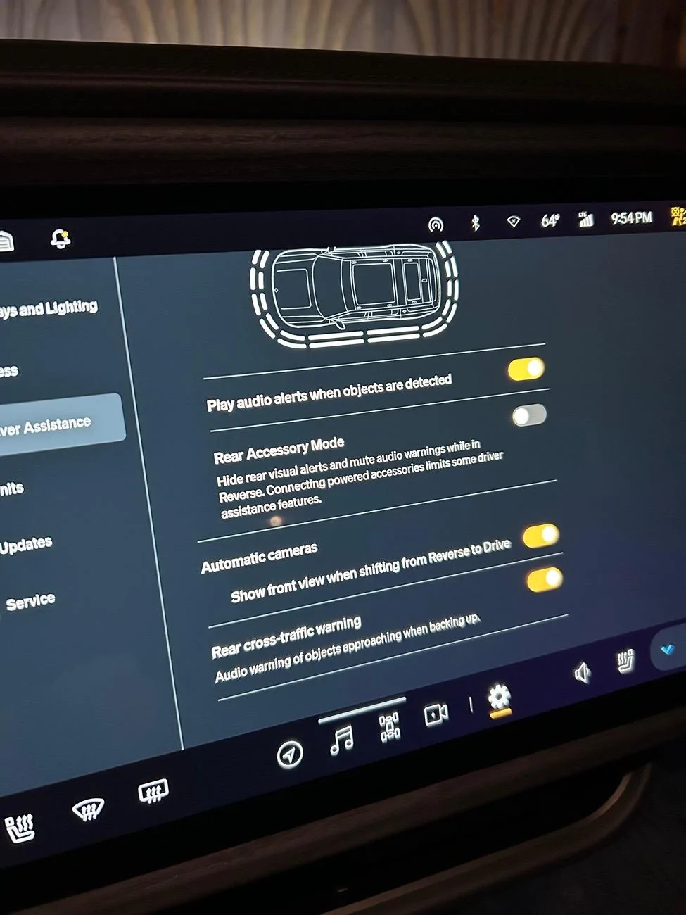

Turned off ACC & HWA and still getting the squeaking. Also my Driver Assistance doesn’t have the Regenerative Braking Assist option your menu has. Is that ur current Driver Assistance Menu? My menu has less options. Could this be the bird chirping noise that others have also pointed out (not related to locking the door)?
Rivian R1T R1S Squeaky Regen Braking - Help IMG_6664
Can you not scroll down further on that screen?

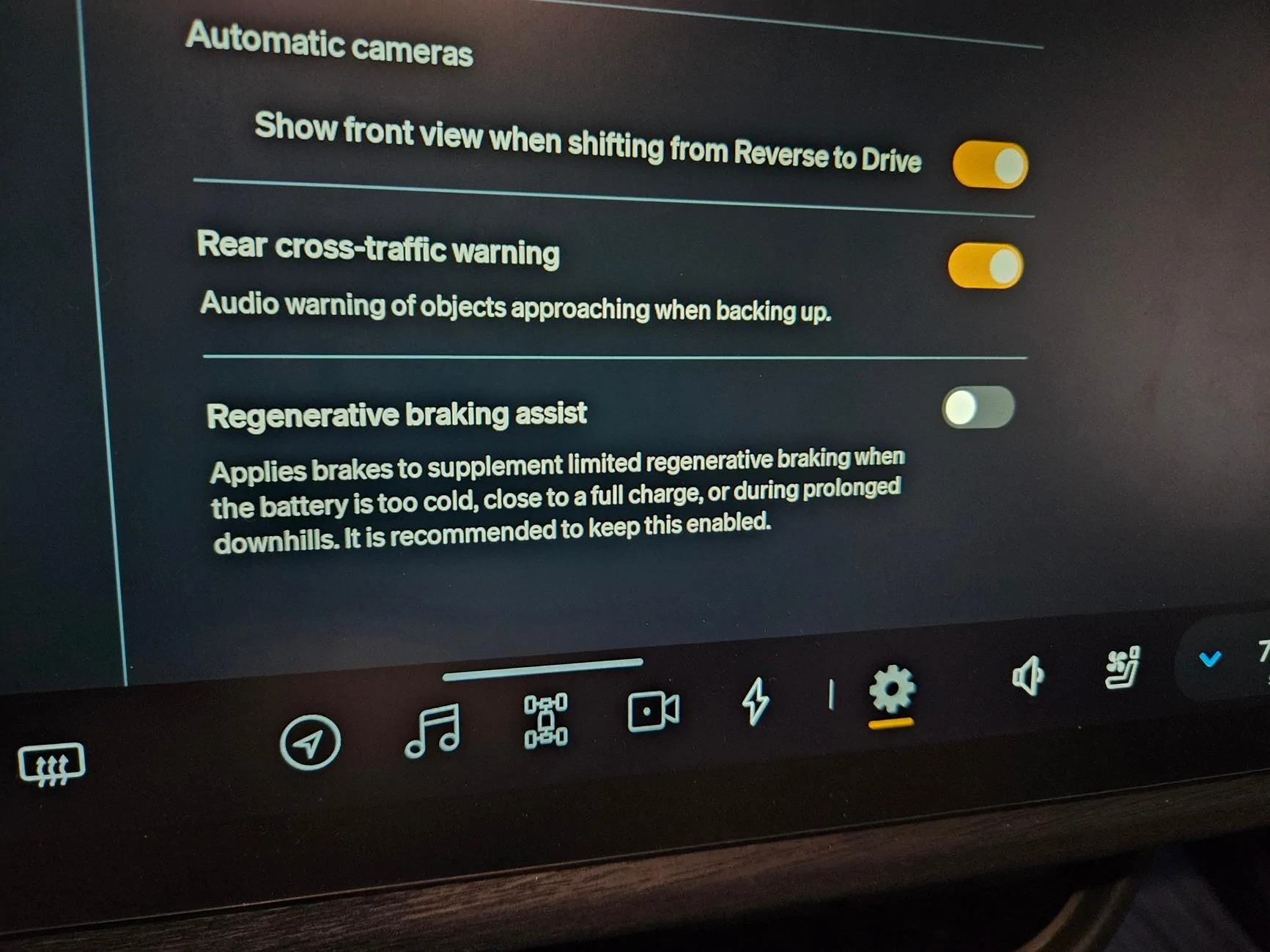

Regen braking assist is an option on my 2025 Dual Max. Which battery do you have? Maybe it's a battery dependent thing? If not, possibly an error that it's not showing for you
Rivian R1T R1S Squeaky Regen Braking - Help 1000013720
