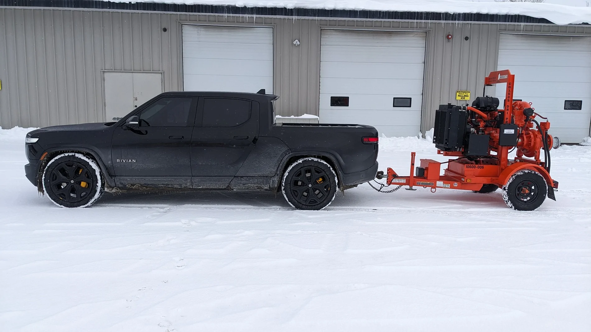

How are you going to drive your truck 350mi to the SC if it won’t get back up from kneel?
Rivian R1T R1S 2024 First gen R1T Quad - HVAC - 3 way valve location? Help? 1000009532
250mi with this on the back. 3800lbs the rest 100mi without.

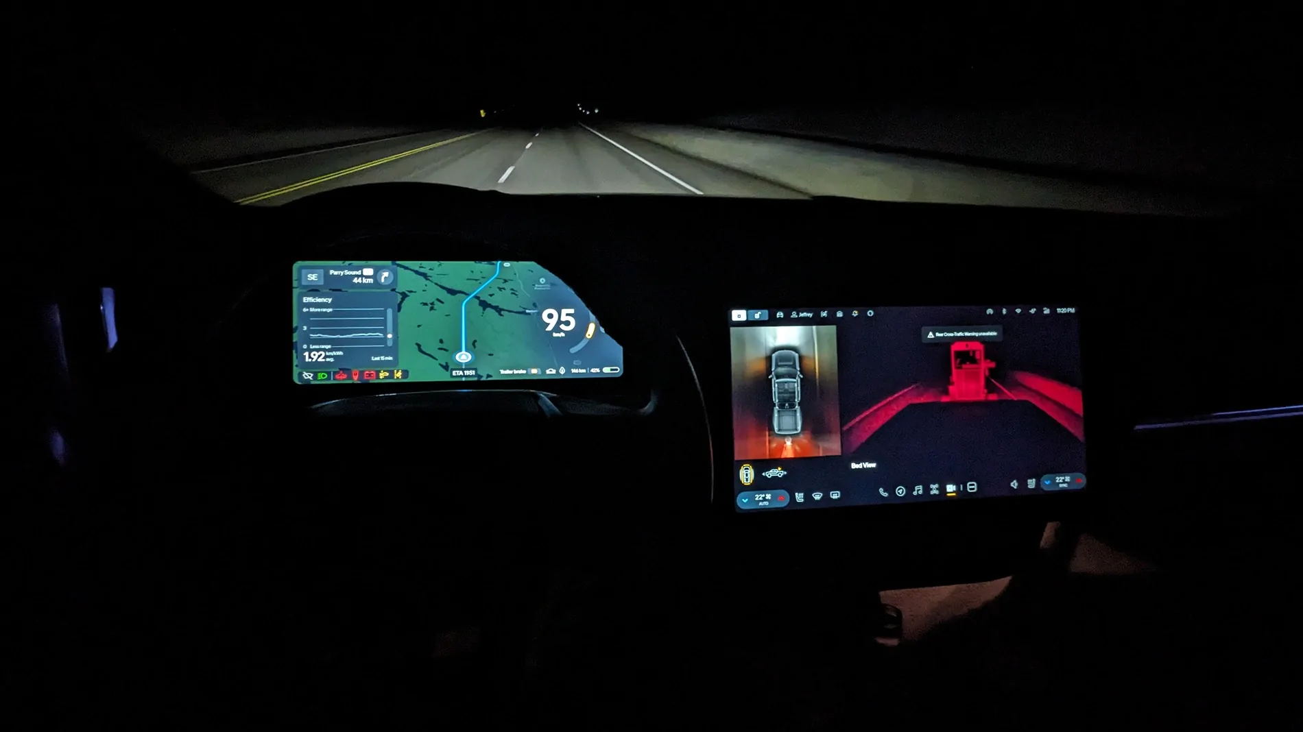

I like this guy
did a test run with that photo. was hoping plugging in the trailer would at least give me quad motor instead of just fronts.
sadly did nothing. just a boat anchor to tug down.
100 mi completed averaged 2km per KW. Or 1.25 mi per KW. Averaged 55mph.

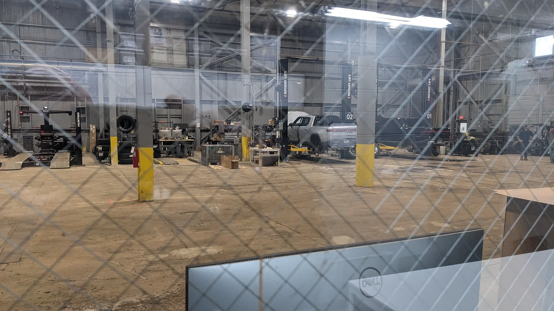

my truck passed the salvage inspection
tomorrow they will write up the quote to diagnose the slow charge, over heat, air ride and alignment
