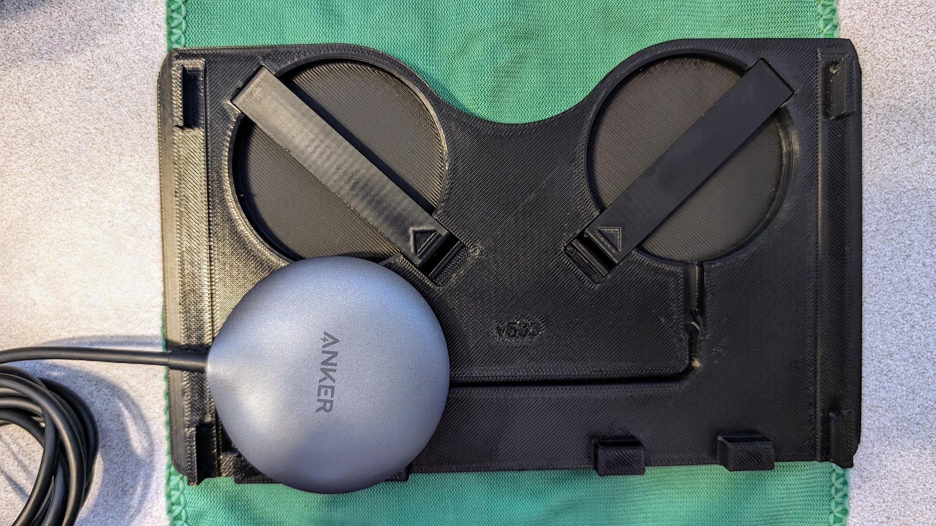

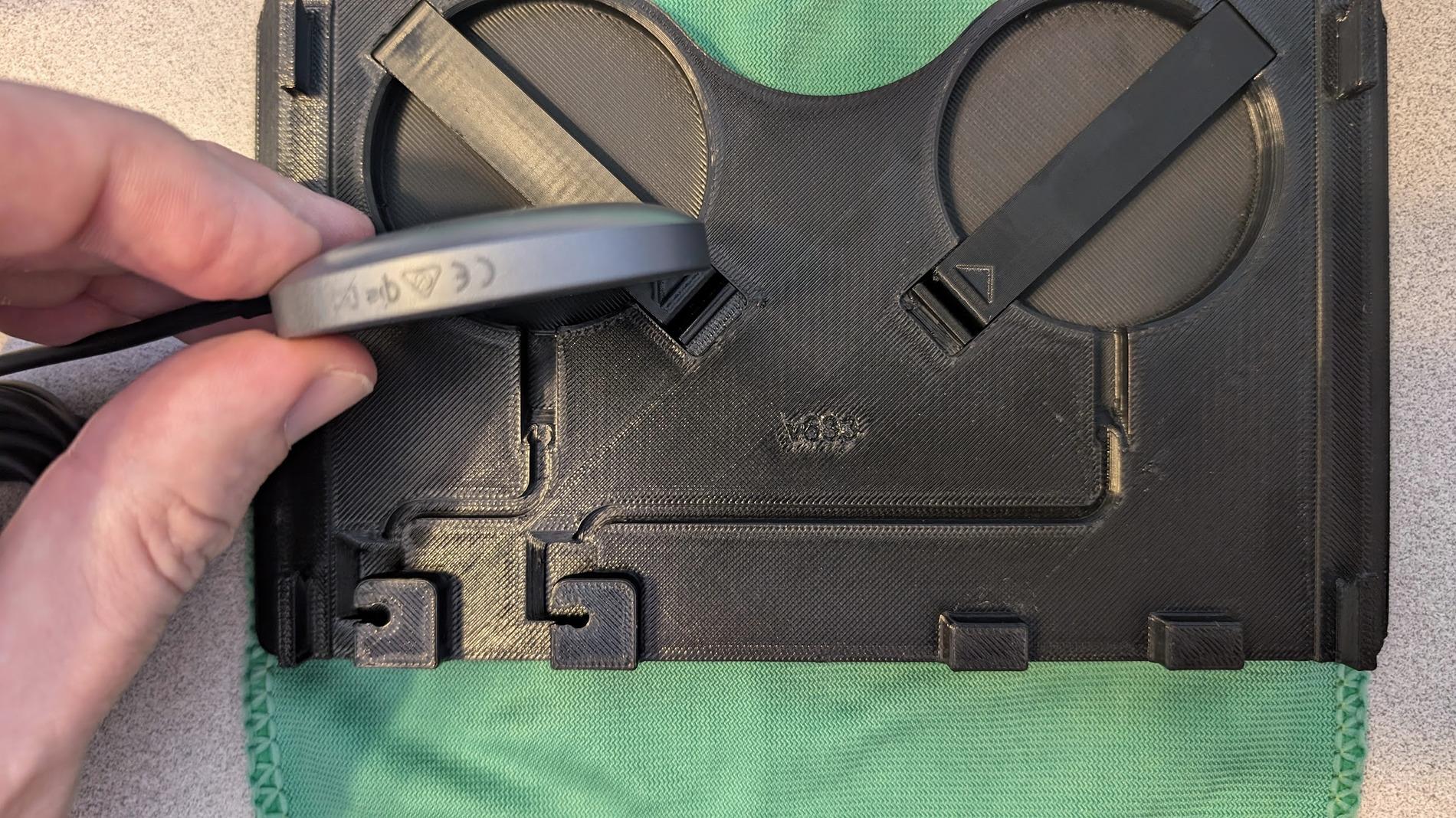

Received my StowNCharge today. Looks really nice. Unfortunately the pucks I bought separately on Amazon are too large to fit. I've reached out to the vendor for suggestions, but figured I'd post here as well for any ideas.
Was trying to use these: Anker MagSafe Charger Compatible, MagGo Magnetic Wireless Charger (Pad), Qi2 Certified 15W Wireless Charger https://www.amazon.com/gp/product/B0CMH2JVMM/
Rivian R1T R1S StowNCharge by Adventure High Tech - Out Now! 1722282616494-78
Rivian R1T R1S StowNCharge by Adventure High Tech - Out Now! 1722282630498-7m
Any suggestions for Qi2-compatible pucks that work with the latest Google Android phones such as Pixel 8 Pro, and are physically compatible with the StowNCharge? Tia! ☺
Edit: I've already bought a "MagSafe" case for my phone so am invested in the ecosystem now. Would like to make this work, LOL. ?

Just buy Apple pucks: they are recommended. Side note: why did Anker make them with a curved bottom? That’s a utility breaker in general.

I use one official Apple puck and one "RAVpower Qi" puck that appears to no longer be available on Amazon.
The "ESR Qi Puck" should work fine, though: https://www.amazon.com/dp/B0CKXKYSMY
This one should work, and charges faster, but I'm not 100% if the included removable cable will fit properly, you may need a slimmer-connector USB-C cable: https://www.amazon.com/dp/B0CSSQD4ZC

Thanks! I saw that second one, but didn't think the removable cable would fit.
I've tried sitting my phone on top of someone's "MagSafe" puck at the office and it did nothing. The phone didn't even recognize that it was on a charger. So not holding out much hope for the "official Apple one" working.
A shame the Anker's didn't fit. They charged really well.
Regardless, going with the option that always seems to work best for me on Amazon: Order every single product available and return whatever doesn't work. Starting with these. ??
