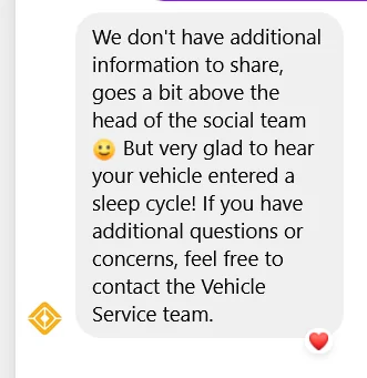

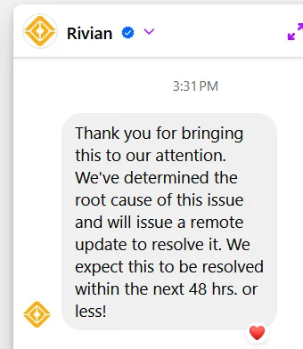

From their Facebook chat:
Rivian R1T R1S Tail lights keep blinking 1752694596421-j
I gave up on trying to chat with them through the app but they responded on social media.
I followed up to ask the nature of the issue. Let's see if I get a response. 😉
Edit:
Rivian R1T R1S Tail lights keep blinking 1752694811509-6l
