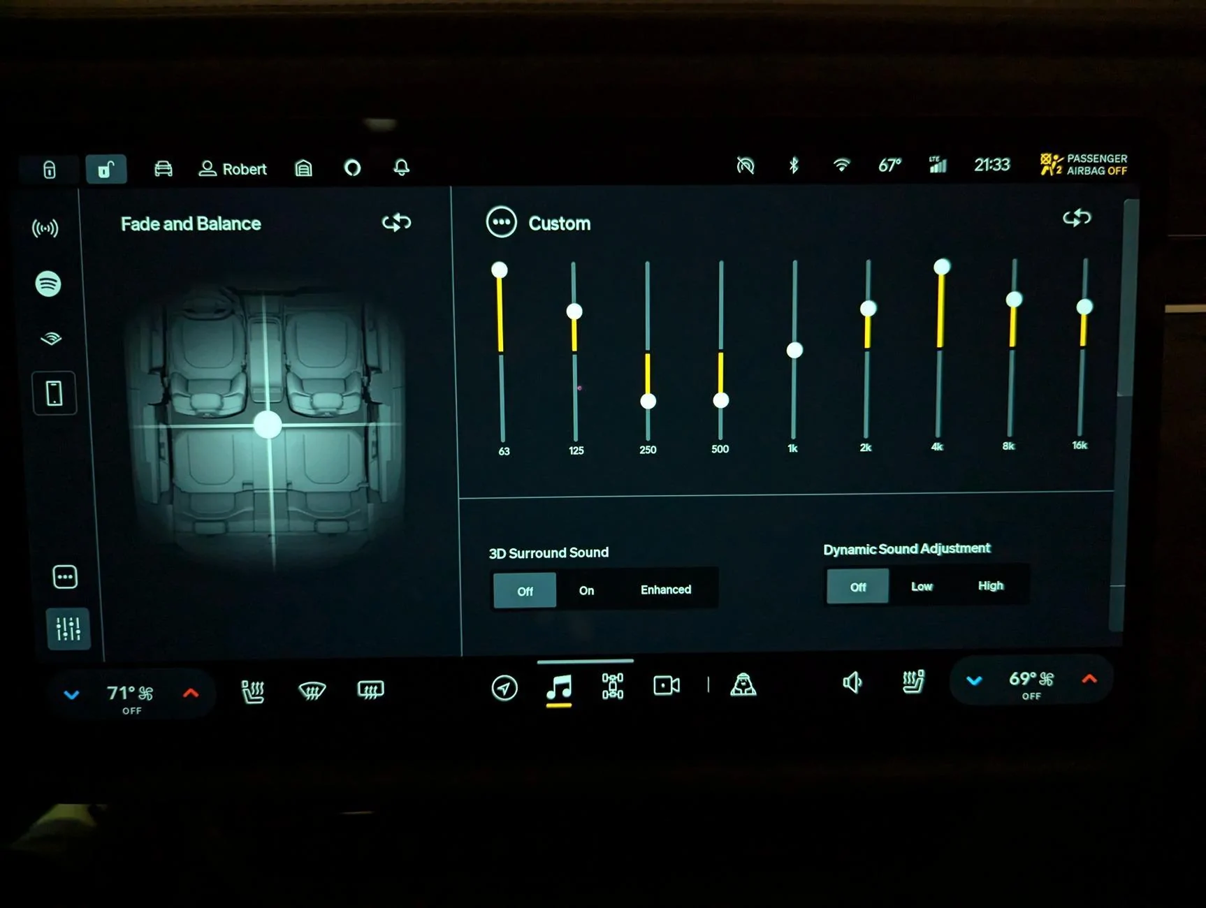

These are the settings I'm using thanks to another person who posted on these forums and they are the best I've heard so far on gen2 premium. I can't find that thread otherwise I'd link to it. Thanks "Robert"

That was me. I connected my Android phone via BT, then used this app to play Pink Noise:
https://play.google.com/store/apps/details?id=info.vazquezsoftware.whitenoise
Then I put my phone near my head and used this app to analyze the sound trying to make the bars relatively flat, using A-weighting:
https://play.google.com/store/apps/details?id=com.dom.audioanalyzer
There isn't anything special about these apps, but that's what worked for me.
Edited to add link to other thread: https://www.rivianforums.com/forum/...sound-eq-post-your-settings.31962/post-632017
