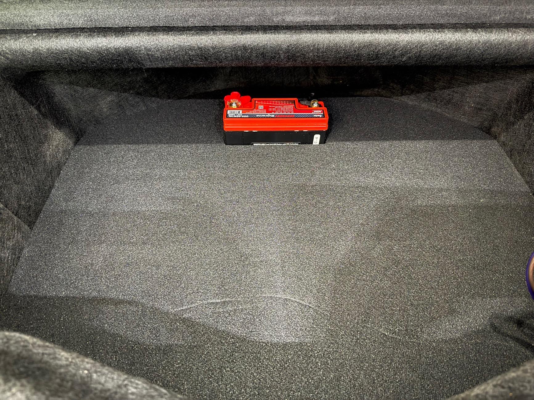

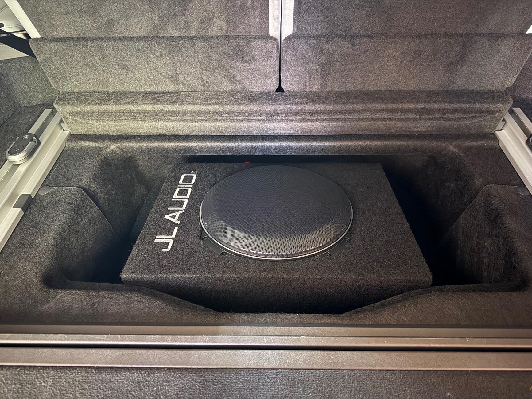

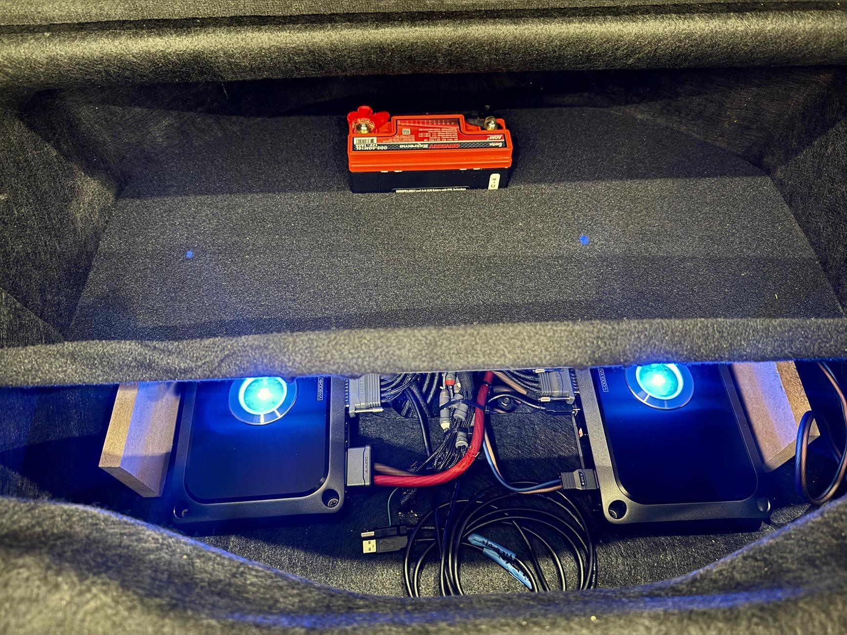

3 Way Focals Front / Rear, JL DSP AMP VX 600/6, JL SUB AMP VX 1000/1 with a 13” JL shallow mount sub along with an extra battery.
Everything is wired into the stock head unit. Nothing is noticeable as it’s all mounted in the spare tire area.
You can modify to your liking but it really transforms the vehicle to a whole different experience.

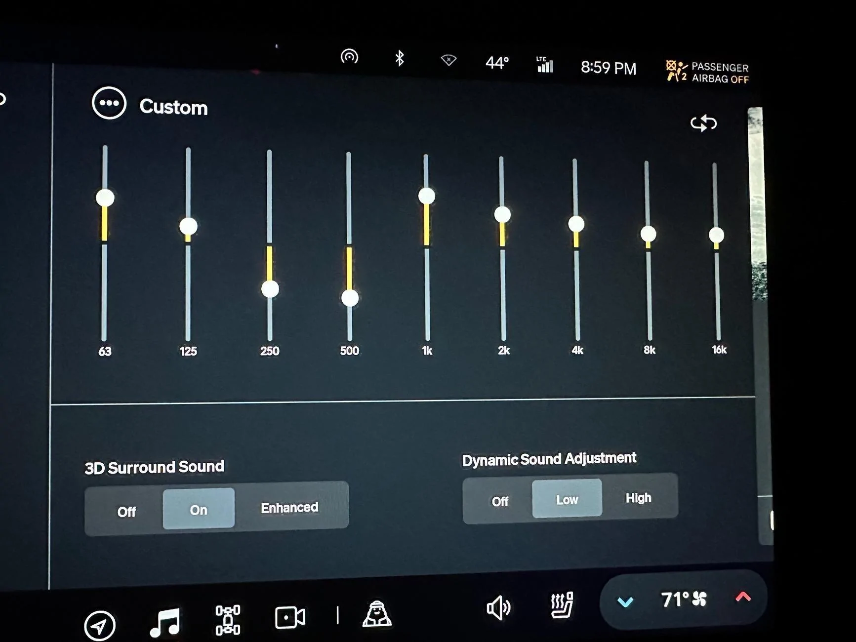

I will say, after the last few updates and using these EQ settings posted recently, my Gen2 standard audio sounds pretty solid finally!

I bet that sounds great! Looks like a really clean install, too. What happens with the over-the-air updates that Rivian pushes? I know they are always messing with the audio, and I worried about going aftermarket because of this.

Yeah, very happy with it. As far as updates I haven’t noticed anything. The original amps and head unit are all the same, the stock amp is now just used as a low level line out.
I suppose worst case if Rivian made a change I didn’t like to the settings I could have it re-tuned.

I agree, after latest updates it sounds good
