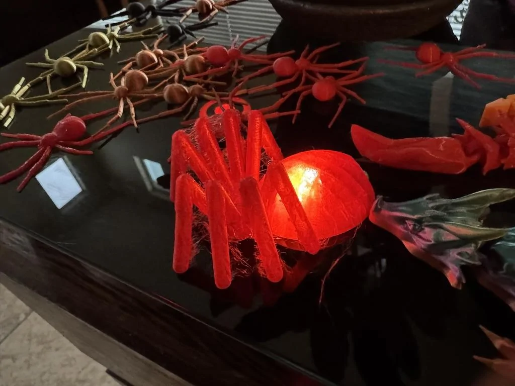

That would be awesome as my design skills are comparable to a brain damaged howler monkey. I'll go try some possible positions today. I haven't looked yet, and my printer is still making kid's stuff for halloween.
Neighbor texts and asks “what are you doing.”
I’m in the shop drilling buttholes into 3D printed rubber spiders.” <silence>
