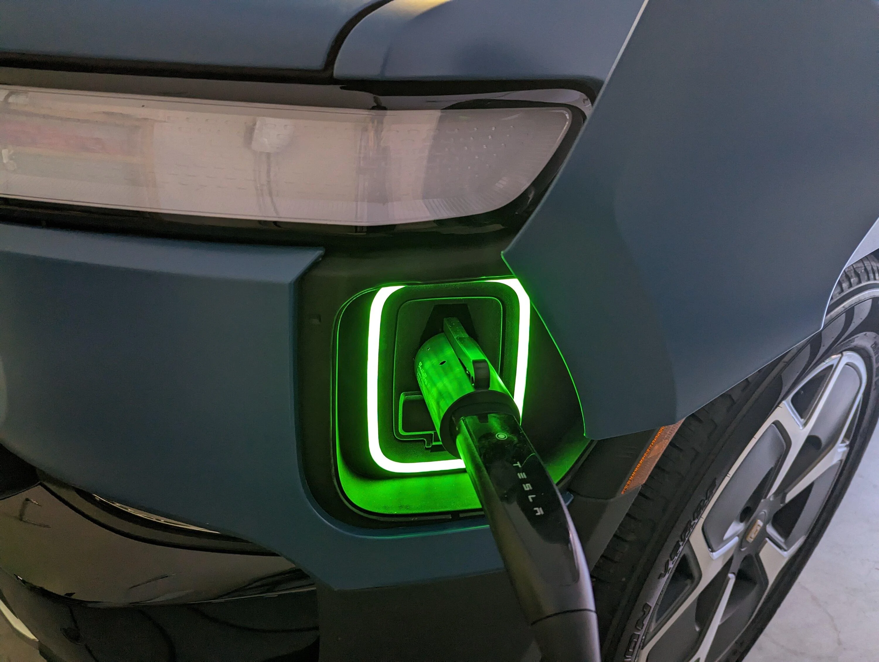

Update on my side, TeslaTap arrived, hooked it up, and it started charging immediately.
Rivian R1T R1S Tesla Universal Wall Connector home charger - it's here! 1000005543

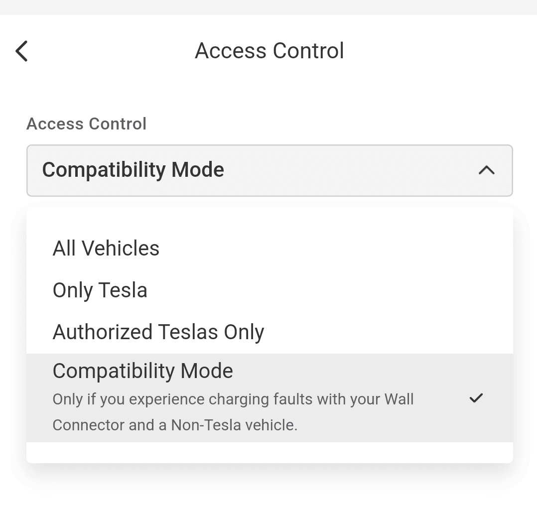

So based on this it seems like your charger is not set properly for non-Tesla.
The Trsla tap is handling the communication, the dual charger has a pass through adapter and the charger handles the communication.
I would make sure the dual charger is not set for Tesla only. That seems to be the issue, if it is set to both, try changing it to Tesla only and back to both and see if it corrects itself.
This. Sometimes the “default” shown setting isn’t really what the config is. Set it to something else, save, set it back, save, and you could see a change in behavior

I've tried every mode except "Authorized Teslas Only" No dice.
Rivian R1T R1S Tesla Universal Wall Connector home charger - it's here! 1000005545
Same here. Went through every setting. Rebooted the wall charger, the R1S, went through Tesla Pro settings, everything now multiple times. The wall charger remains in standby mode and when it plugs in the R1S charge port light is white for 10 minutes or so then I get a charge error and the light turns red.
