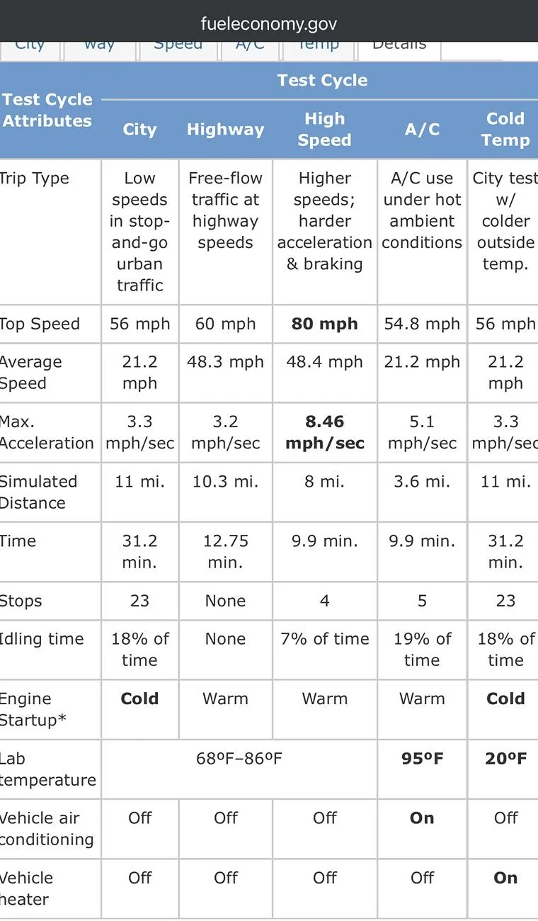

Rivian should advertise "range" as measured at 70 MPH at 40 degrees F, with automatic climate on.
That's not the EPA Test Cycle.
Rivian uses the same EPA STANDARD TEST CYCLE everyone else uses which makes it a meaningful comparison so you can judge vehicle efficiency vs other vehicles. If the EPA changes their test cycle parameters (which is probably due) then Rivian will adhere to the new test cycle parameters. Rivian is not going to use some off the wall test cycle parameters when everyone else is using the standard EPA cycle.
OT- @ThirteenElectrics, you know you're on a Rivian forum right?
It seems like you come here looking for a fight in every new thread you start. While there are some here who might happily oblige and throw down with you at length, many will just start ignoring your posts or just put you on their ignore list. Better to choose your battles over time which will not impact your credibility as a forum member vs just posting everything that irks you no matter how minor it may be.

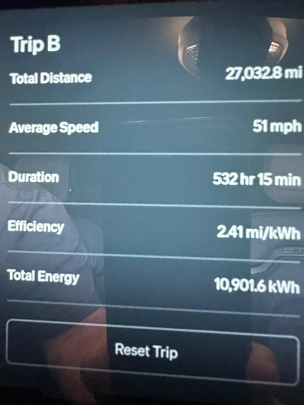

Efficiency in an EV just like in ICE vehicles is all about how and where you drive. I know when I was driving around in southeast MA with a lot of long flatter back roads and 35-45 mph speed limits my gauge was usually over 3 m/kWh.
Around my house in SoCal with higher speed limits, lots of stop lights and shorter trips of 10 or 15 minutes, I can struggle to see 2 m/kWh. The longer the trips things warm up and it goes higher.
My Model S is 2k pounds lighter and has lower drag than my R1S, I usually see 3 m/kWh in that so I had zero expectation my R1S would be around 3.
I have done enough road tripping in my R1S to know the trip meters are not 100% but they are pretty close. A few legs on my trips I would reset the trip meter and log the miles that leg then compare how many kWh the trip meter said compared to how many the next charge took.
I’ve never reset trip B so lifetime for my R1S is around 2.41 (there is a discrepancy in the readout, if you divide the miles by kWh used it is 2.48 but I went with the lower 2.41), at 2.41 my large pack with 22s gets me 313 miles.

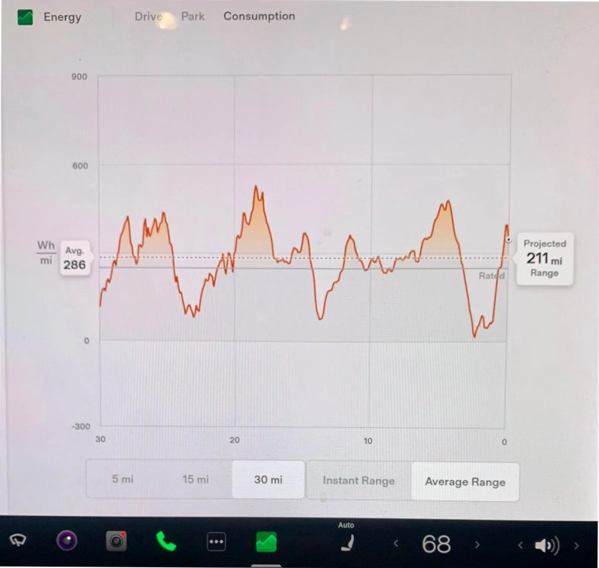

Not sure why they can't make it more useful like the Tesla graph:
Rivian R1T R1S The efficiency history gauge is propaganda 1733864055304-ry
This is the full screen graph and not the one in the cluster, but the principle is the same. Have the baseline horizontal line correspond to the rated EPA range for your vehicle and go from there. Some might be 2.7mi/kwh, some might be 2.9. Don't baseline on an arbitrary 2mi/kwh. When I got my R1T I initially thought I was always doing better than rated range until I realized they put a rose colored filter over the graph.
Whether the EPA range is ever achievable, reasonable, or needs to be changed is irrelevant. Right now the trucks are advertised with a given range estimate and it's useful to be able to easily see at a glance how you're doing against that estimate.
