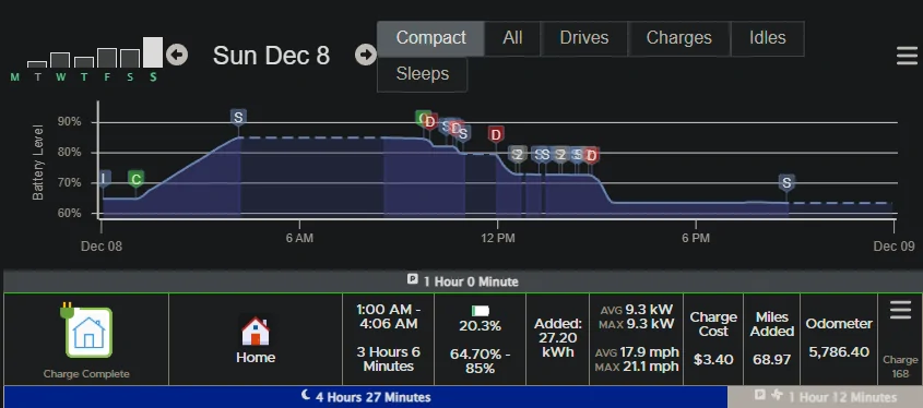

Is your R1 "sleeping" after it hits the limit of SOC you set? My Tarkus does not go to sleep even after it hits the limit I set (currently 95%).
Yes, sleep starts right after the charge:
Rivian R1T R1S Third 12v system failure in 7 months without warning - 2023 R1S 1734085586322-n8
It didn't sleep right after I got home that day for some reason, but it was sleeping even while I was on some of my errands. Phantom drain for that day was only 0.68kwh.
ok & thanks for the screen shot... looking at the 9.3kW charge tells me this is a Level 1 Charger at your home & not the "110v Kit" that comes with the R1's & only trickle charges at 1.3kw & that's probably why mine will not sleep. I can swap out the 110v connector for the 50amp connector cable that comes in the same kit & connect it to the 50amp RV Service plug at the pedestal serving my travel travel & maybe Tarkus will "sleep" while charging. I'll give that a go after Mondays visit to Rivian Svc Center to swap out my "now" dying 12v battery :cool:
The truck should still sleep after finishing a session, regardless of how fast that session charged, but I supposed it's free to experiment.
It's possible that the truck is not sleeping because it has a dying 12v battery. If the battery does not keep a charge, the truck has to engage the HV battery and keep it awake more frequently - perhaps constantly - to keep it topped up.
