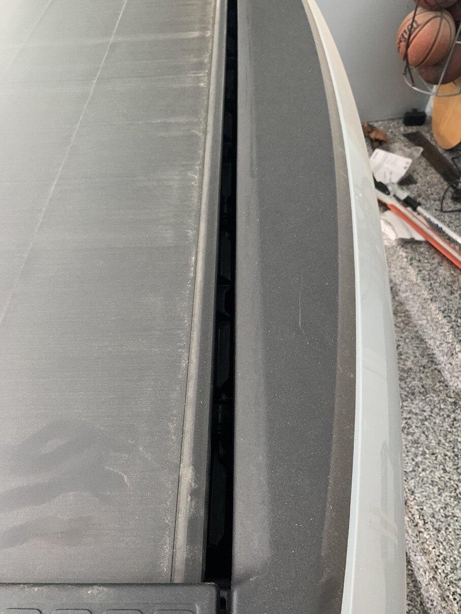

Spoke with a service tech yesterday (he was working on my bricked truck due to 12v drain issue). He recommended keeping the top of the cover clean before retracting and using a dry, graphite based lube in the rails.
If careful cleaning and graphite are needed, should be some sort of service bulletin/email from Rivian to current owners, and may eliminate a lot of service calls. Maybe Rivian should just include a recommended graphite product to use on the rails, versus trial and error by owners???

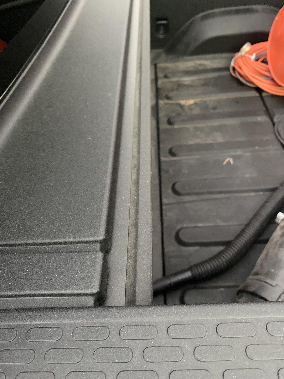

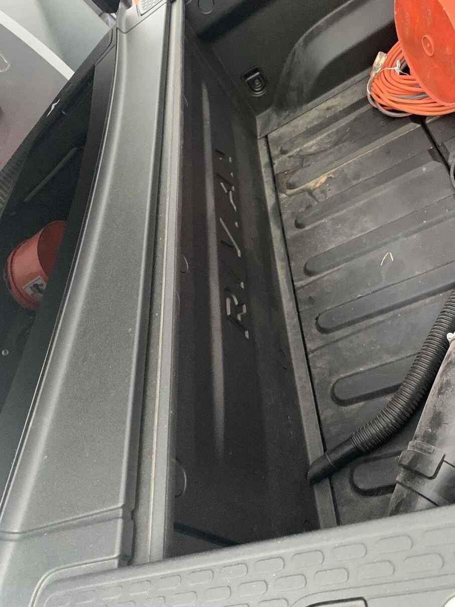

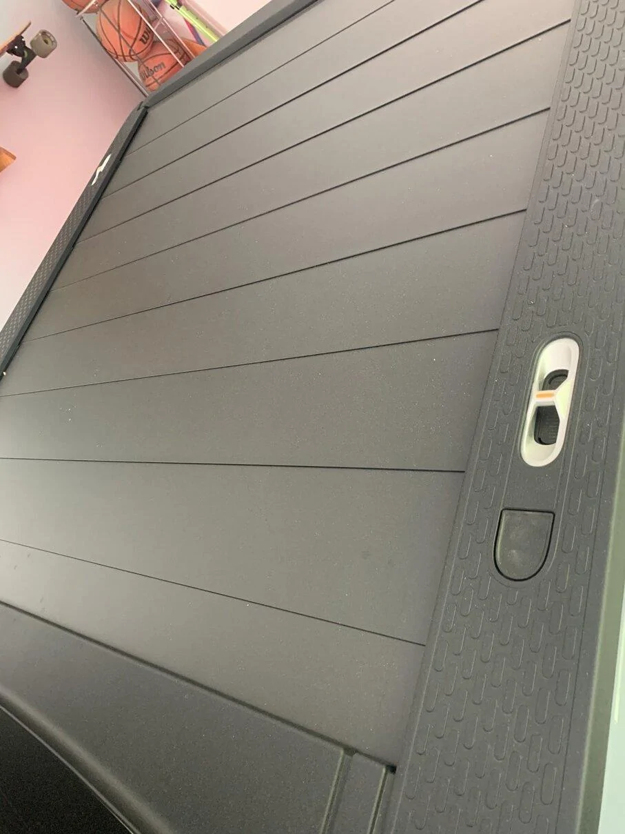

Well, interesting behavior. Been back from service for about a week after tonneau replacement. Open/closed tonneau maybe 4 times since service. Decided to try it today with my son watching behavior of the 1 inch overhang on open thing and it decided to not close completely. Brand new cover as of a week mind you. The slowing toward the end of closing behavior turned into slowing to a stop with about 1 inch left open. We were able to open/close it and pull the cover towards the back at the end to get it to close completely. Calling service again.
Well mine is having the same behavior. Pushing and holding the button it will close all the way but just pushing the button it stops short about 1" on each open and close.

A mobile tech was at my house today for some other issues, and I asked about the tonneau problems. He said I definitely don't want to join the "tonneau club" and suggested spraying the track with dry lube. That's what they do, but he didn't have any in the truck. I picked some up at Home Depot, but unfortunately, it dried white. Need to find one that's clear or black.
