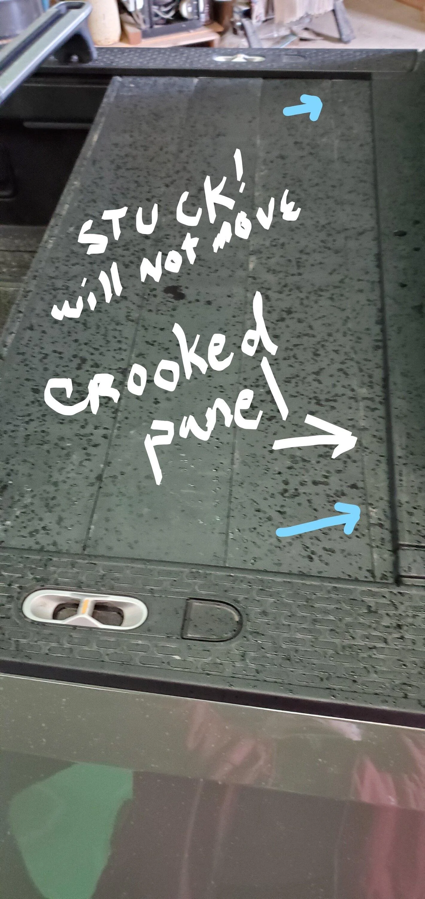

Same issue with ours!! Ours is now stuck solid and won't budge. Problems started the first week we got it and got progressively worse. I contacted support a couple of weeks ago and was told they'll get back to me with a recommendation...crickets. It would at least sort of work back then, and we could live with it. Then a couple of days ago, it got stuck solid and will not open move at all. Called support again yesterday and was told to send a photo and they'll get back to me with repair solutions.
He also said they are working on replacing the bad covers with a new and improved design.
We're over 200+ miles from the Bellevue WA service center, so getting this fixed will probably be difficult. I hate the idea of being without it for any length of time. At this point, I'd be happy to just leave it open all the time until they can get a new version figured out and installed. But can't even do that at this point.
I'm rootin' for you Rivian to figure this out and get it fixed!!
" He also said they are working on replacing the bad covers with a new and improved design. "
This part at least gives me confidence they are working the issue and an iterative design change.
