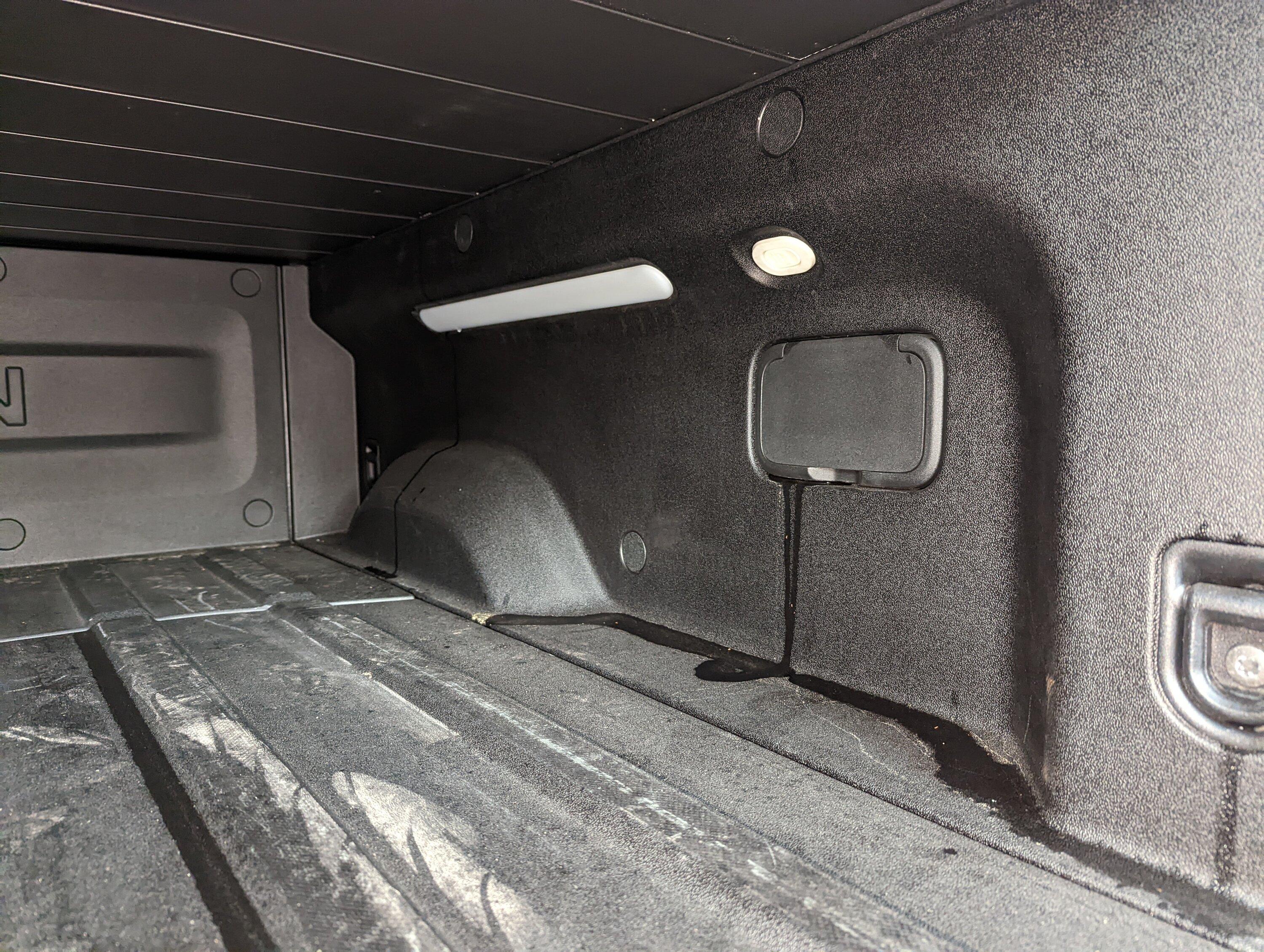

Had a heavy rain come through Chicago this week. Tonneau closed, this was all the water right after it ended:
I always cringe when I see the water coming out around the bed outlets on my truck, there is just something that doesnt sit well inside me with this...water...electricity.

The spare compartment is weather stripped and the bed has drain provisions.
And the question is of course, "Are they effective?" Has anyone actually been in a downpour witht he tonneau open and then checked?
? I do have a hose....
