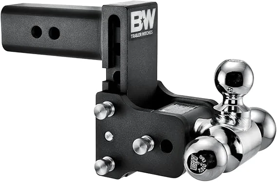

Does this look too close to the vehicle? Will be towing a T@b400 with it. I don't think I need a hitch extender but wondering if this is ok or I need to try and find one with a longer shank. Thanks.

Ok I'm gonna drive it over to the camper this wknd and hitch it up and may post again cuz I'm paranoid lol. I read somewhere if too close could hit your vehicle if on a tight turn. Need to check the height too I guess. This is the one I use on the Ranger which sits up higher (although she was in kneel mode when I took this pic). Thank you!
I would definitely buy a longer hitch. I had the same experience with the T@b 400. The problem is the diamond plated storage tubs on the front of the T@b (if you have the newer one where the tubs are standard) - it will make backing up almost impossible without the tubs hitting your tailgate with just a moderate turn(speaking from first hand experience). My advice would be to buy a longer one - I did and makes a difference.

I have a longer adjustable-height-ball-hitch for my T@B 400. But that's mostly because that's what I had for my prior trailer. I've used a "three ball" that's about the same distance away from the bumper in a pinch, and it worked fine. The "flange" on the front of the trailer coupler did get close to the bumper, but it didn't rub (when I was lined up right.)

Check your hitch for a second set of cotter pin holes farther from the ball. I found that on my bike rack, which I thought was too close to the car. The other set of cotter pin holes gave the rack more space away from the bumper. Like the one in this photo.
