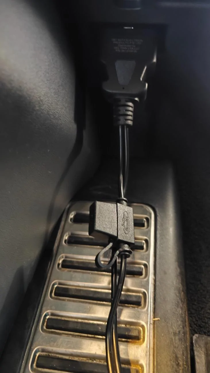

I use an OBD 2 port adapter to my Battery Tender for my Gen 1 (single 12V battery) R1S. Prior to connection, my R1S would have a VD of 1 to 2% (sometimes more) per night and would wake up every few hours. Now, it sleeps for 12-24 hrs or more and the VD is around 0.2 to 0.4%. This method works great if the vehicle is garaged.
https://www.amazon.com/Battery-Tender-081-0154-DL-Connector-Maintainers/dp/B007KJ2RZK
There is a very LENGTHY thread (29 pages!) discussing all the possible solutions to resolve VD, keeping the 12V battery topped up (even when new) seems to be the solution for Gen 1 vehicles.
https://www.rivianforums.com/forum/...ly-solved-or-hacked.31506/page-23#post-621430

Thanks @Tim-in-CA! I had a chance to try both of these Battery Tender products (3 Amp tender and OBD adapter) and it appears to work with my Gen 1 with dual 12V. Over last night I only lost 1 mile over a 12-hour period, whereas otherwise it is typically a 2-3 mile loss overnight at these temperatures. The best part was that it just took under a minute to setup and similarly quick to remove. I'll monitor this over a few more nights.
Out of curiosity, I also tried a 30 watt solar panel with MPPT behind my windshield, which also seems to work through the OBD adapter and showed a full charge within 10 minutes. This was also super easy to setup, and the panel stays securely tucked behind the A pillar, without the need for any additional securing. This took under a minute to setup and take down.
Here's the solar panel in case anyone else is interested.
https://a.co/d/f2J3cSJ
Assuming this works well, I plan to use the 3 Amp tender + OBD at home, and the solar+OBD on camping trips.
