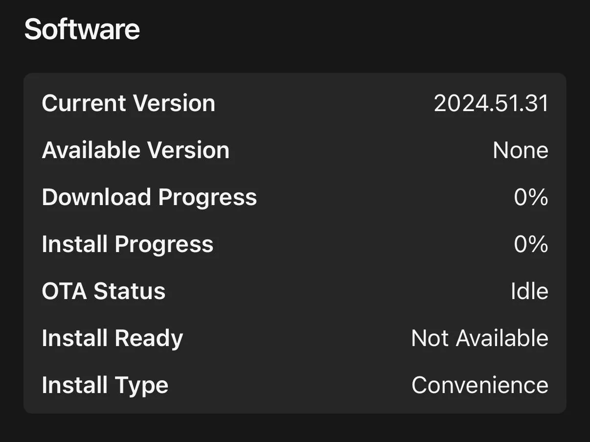

Do that and check from your center display to see if it's already been pushed but stuck while downloading (vehicle settings > vehicle > updates). OTA download in the background when parked. You driving it, or connectivity interruptions, will cause download to pause. And you do not get notification (or awareness of update being available to install) until download is complete. If you want to be less in the dark, use a secondary email of yours, invite "yourself" as a driver, then use that email to link your account to rivianroamer. Once linked, the dashboard will provide visibility over some things.

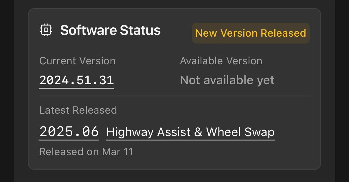

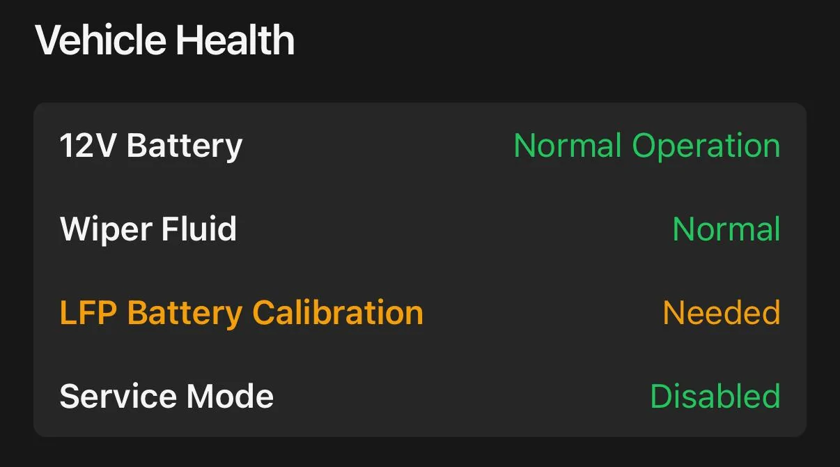

Ok I’m in Rivian Roamer, what can you decipher from this if anything? (Note I haven’t charged to 100% this week)
Well, apparently your battery needs calibration.
Though it does sound like your vehicle just hasn't been flagged yet.

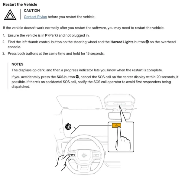

Did you try a full system reset? (Left steering wheel button + hazard lights)
Rivian R1T R1S Update 2025.06 is out! 1743078252722-j1
What you described with left + right paddles was an infotainment reset.

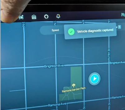

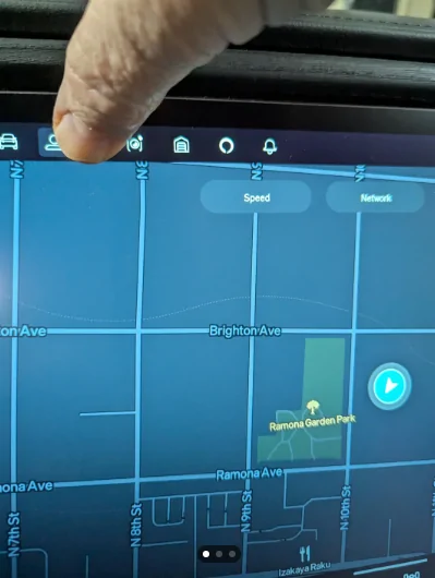

No need to postpone a reset for fear of losing diagnostic data, it will still be there.
Future tip, if you want to flag an event/time for Rivian service diagnostics, long press the user profile button or hazard button to log it.
