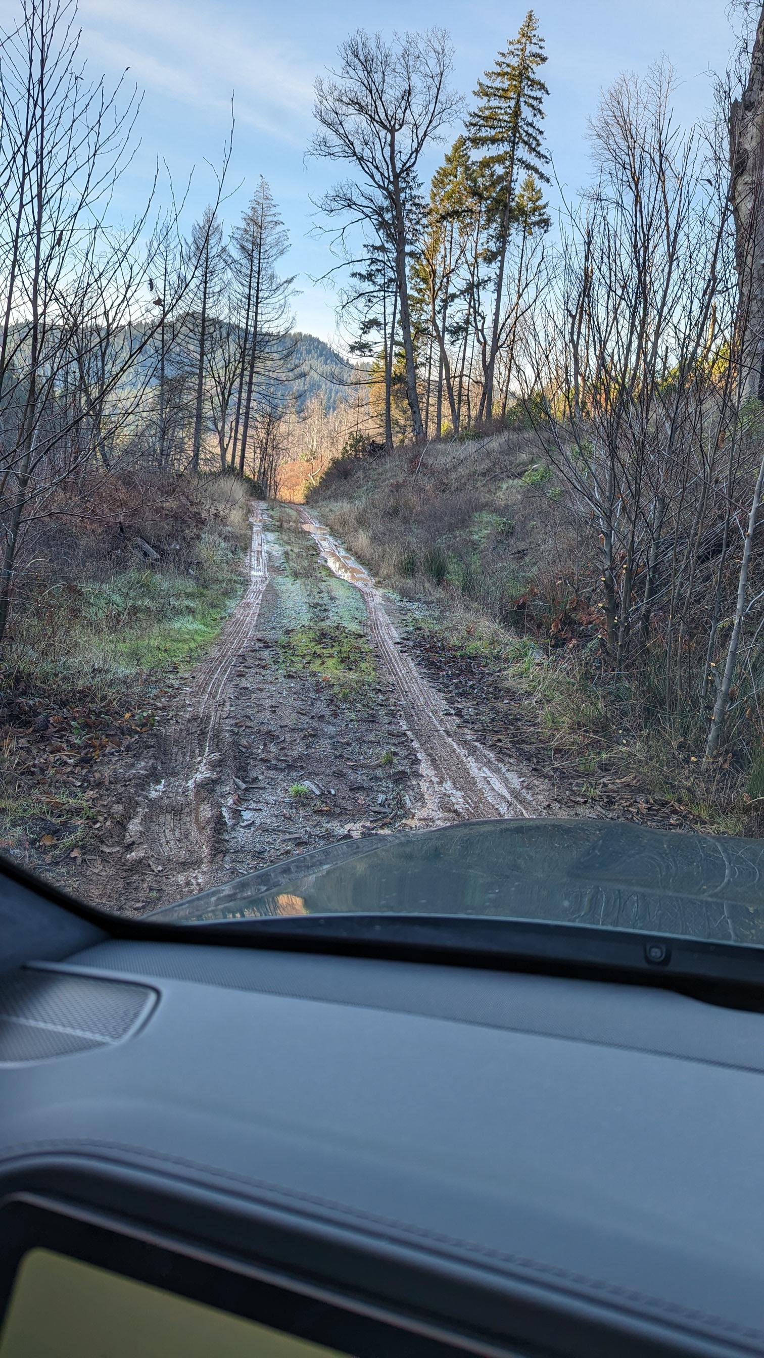

Galice Oregon. The park is 200 acres of private, that borders millions of acres of BLM.
The valley is known as Rogue Indian Hills, Blue Canyon and Hellsgate locally. The park itself is for our private amusement, testing and to train guys that want to come on trips that might need a primer. It is 100% use at your own risk of course, and by invite only (I have invited anybody from here that would like to use it).
Run a class? Sure, but 1-on-1 is usually the best. This is Oregon, so how the individual feels about "Oregon Pinstriping" is going to effect trail choice, as is whether the vehicle has underbody protection. Even for somebody that wants to avoid any possibility of body damage, however, it is a worthwhile venue. It gets crazy steep really quickly, and if wet at all, gets really slick.
I will tell you up front, that QMs have to be tied off at multiple points on even the easier trails to keep them from going sideways over the edge when wet/snowy. Where a bone stock F250 or a DM will just drive across it, the QMs (and the Yoda spools) tend to lose lateral traction really early and will move sideways as soon as they start to slip, and there is no way to stop it (no "unlock" switch on the dash) except to tie them off on the uphill side for those portions of the trail. See my "quads vs lockers" thread for some of those scary experiences.

If not a physical locker, I would at the very least like to see Rivian improve behavior at low speeds. In technical situations, combined with novice experience, the answer is not to give it more beans—to brute force up the obstacle. That could very well cause a chain of unfortunate mistakes. Those operating Rivian-owned vehicles can afford to make mistakes more than we can, because cost of those repairs are not coming out of private pockets.
They did. The Enduro, with it's excellent traditional traction control is very mannerly with almost anything you throw at it; including most low speed obstacles. It needs no "modes" to try to tell a computer how to act, it just acts like any other 4x4 with good torque vectoring.
Once lockers are added, it will be as capable as any other off-road machine this heavy (yeah, hard to get around that one), but seriously, it is very good even without them. I am taking it to some very remote sites, with significant challenges even with the street tires on it at this point; it is that good.
Once Atomic gets me my 20's, it will be wearing Toyo Open Country MT's again and will be a great 4x4; no fuss no muss.
