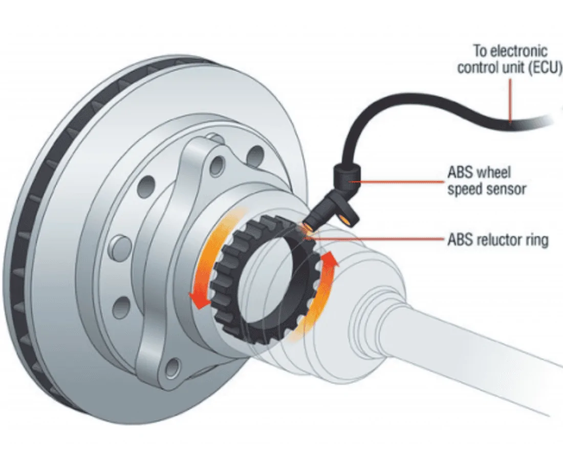

I wonder if they could add more ‘poles’ to the wheel speed sensors to get better resolution on when a wheel is slipping? I haven’t seen details on the current implementation.
edit: eg if they only have 4 poles, the wheel needs to rotate as much as 90 degrees to provide the next input to the software.
In theory, they already have much finer resolution to detect wheel spin. If Rivian uses a typical design of ABS, there is a 20 to 50 tooth ring and sensor that is used to detect wheel lockup. That sensor creates a pulse train. Rivian in theory could use that signal to detect wheel spin, or lack thereof, for a locker algorithm.
That would still be between 7 to 20 degrees of rotation of the wheel (between 2-5” of tire circumference rotation). Seems that even finer resolution would help them sort out control algo’s better with quads to allow better behaviour crawling and in slipping situations.
But this still wouldn’t address RIP’s point around amount of power/torque you can direct to one wheel - Dual with a locker wins that one.
