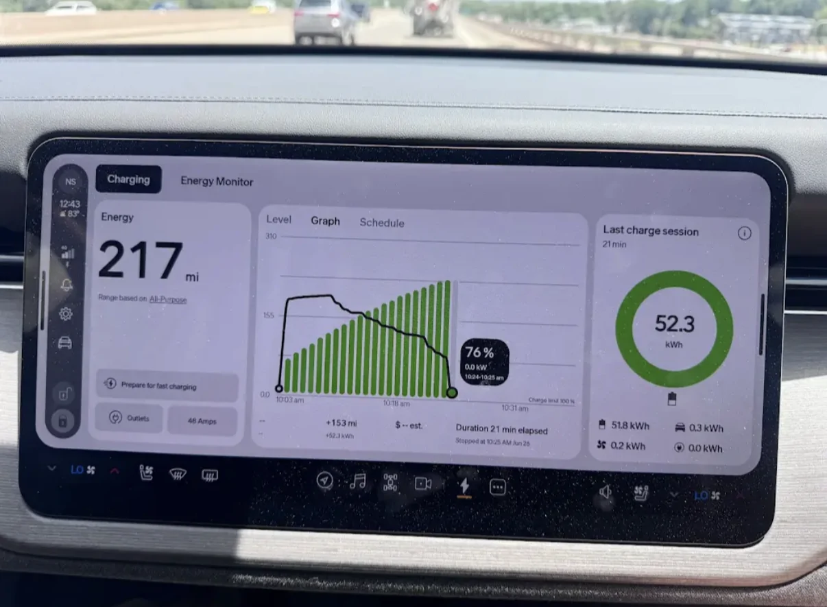

What's up with the axes on that charging graph? There is no SOC axis label, so I'm assuming the major grid lines are 25/50/75/100, but why is the left axis scaled to 310? Also, where are the units?! It wouldn't be hard to add "kW" after the axis labels, or add a vertical text label with "charging rate (kW)" to actually label the axis properly.
Given the R2 has a max charging speed of 210kW, it seems like that left axis should be scaled to 0-250 (to leave a little margin) to better utilize the space. And the "charge limit 100%" text label in the bottom could have been shown as a threshold line on the graph so it is clear when the green bars reach the line that the limit is reached.

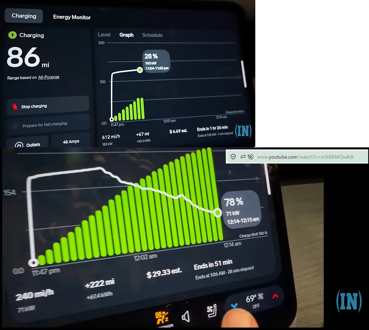

This R2 video from a couple weeks ago shows a 28 min charge from 6% to 78% with the full charging curve.

Thanks for posting. This is a bit lower than what I expected: adding 54% in 22 minutes (180 EPA miles). Fwiw almost identical to the Subaru Trailseeker recent video posted.
The gap with the shorter range 800V systems like the Volvo P10 EX60 would add 225 miles in 16 minutes. The long range 800V systems (iX3, Volvo P12) add 280 EPA miles in 19-21 minutes.
Until 800V this is pretty much what we're gonna get. Are there any 400V vehicles that add more kWh per 10 minutes that this or are we at the theoretical limit?
Because The graph is showing two different data points on the same image. It's showing charge rate (black line), and state of charge (green bars). The vertical axis therefore shouldn't have units on it. The bottom axis is time.
If you tap on a particular part of the graph, it will show you what the SoC and charge rate were at that particular point in time.
I don't think the solution is to remove the units from the axis entirely, it would be much better to have a primary and secondary y-axis each with proper labels and units. i.e. "charging rate (kW)" on the left and "state of charge (%)" on the right.
This is just a poorly presented graph that would have points deducted by any grade school math teacher.
I both agree and disagree, as I like having all the data where it should be (multiple axis labels), but being able to tap on a part of the graph and see exact values kinda negates the need for axis labels (Rivian's implementation here).
It should get a bit better. Rivian is aiming for 70% add in 29 minutes so a 54% add in 22 minutes is a little slow but +/- 3 minutes, yes this is 400V for everyone.
Dual dataset Cartesian graphs with a common x-axis unit (e g., time) are nearly always shown with the differing y-axis units respectively labeling independent y-axes on the left and right.
No y-axis labels at all would be exceedingly uninformative, although in a space-constrained display where one dataset's min/max values could be reasonably assumed (e.g, SOC from 0 to 100), having only a single labeled y-axis would not be crazy.
