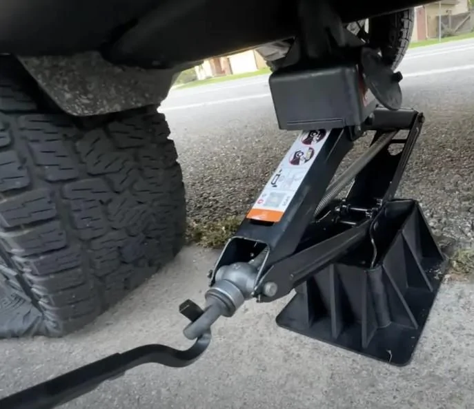

No, it doesn't work with a bottle jack. It is soley designed to work with what you see below. I found this out very quickly, hence why I built these for my R1T.
Rivian R1T R1S Wait.. we really don't need the jack pucks? rivian oem tire change kit

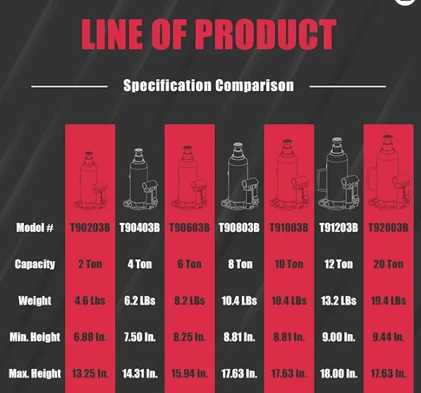

@Mark_AZR1T , Any reason to go with the 10 ton vs 8 ton - both seem to have same travel height of 17.63 inches?
Rivian R1T R1S Wait.. we really don't need the jack pucks? 1704647039369
Two main reasons. 1. The 10T unit makes lifting the vehicle that much easier. 2. The robustness of the 10T unit seems to be better.

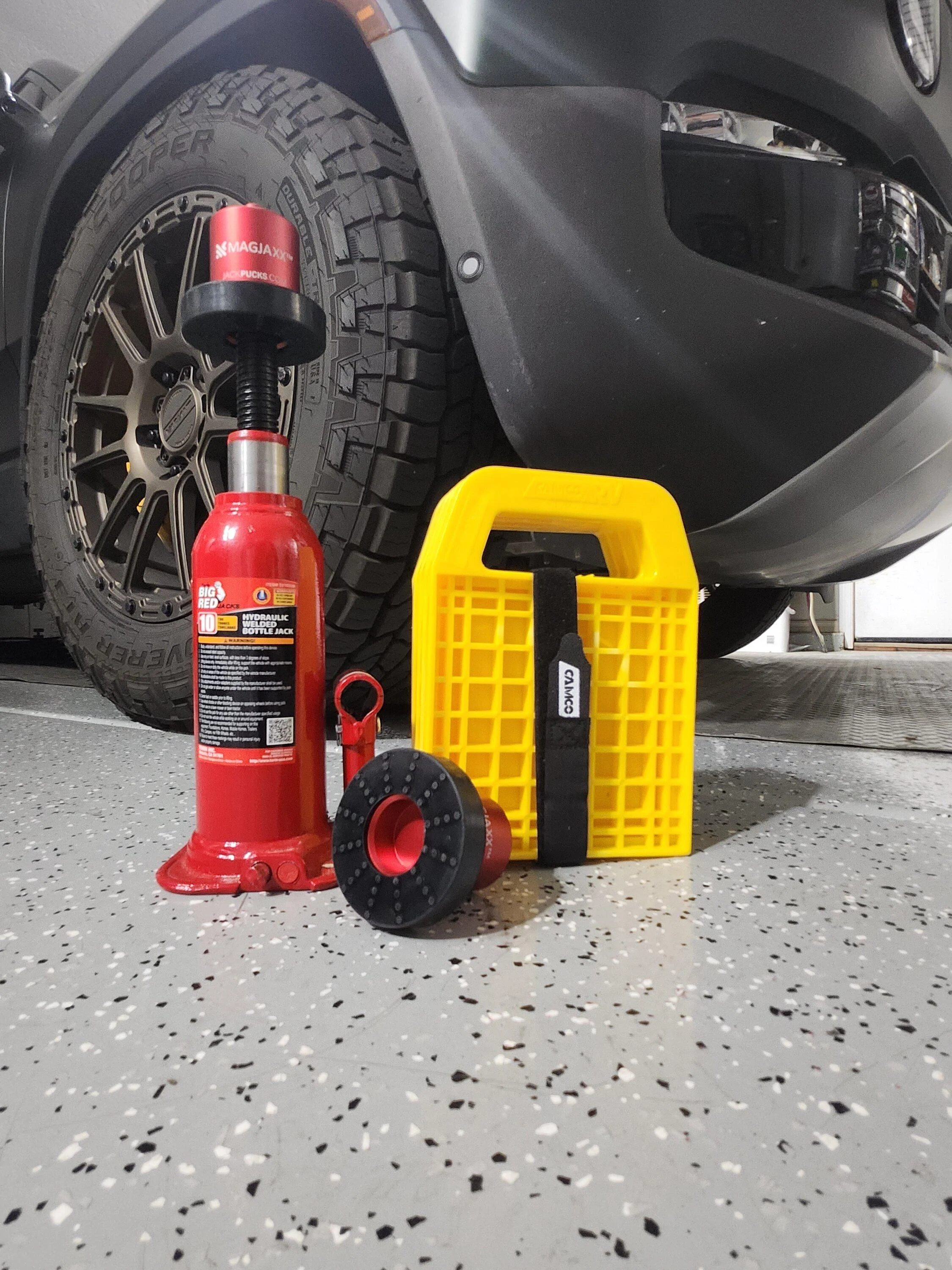

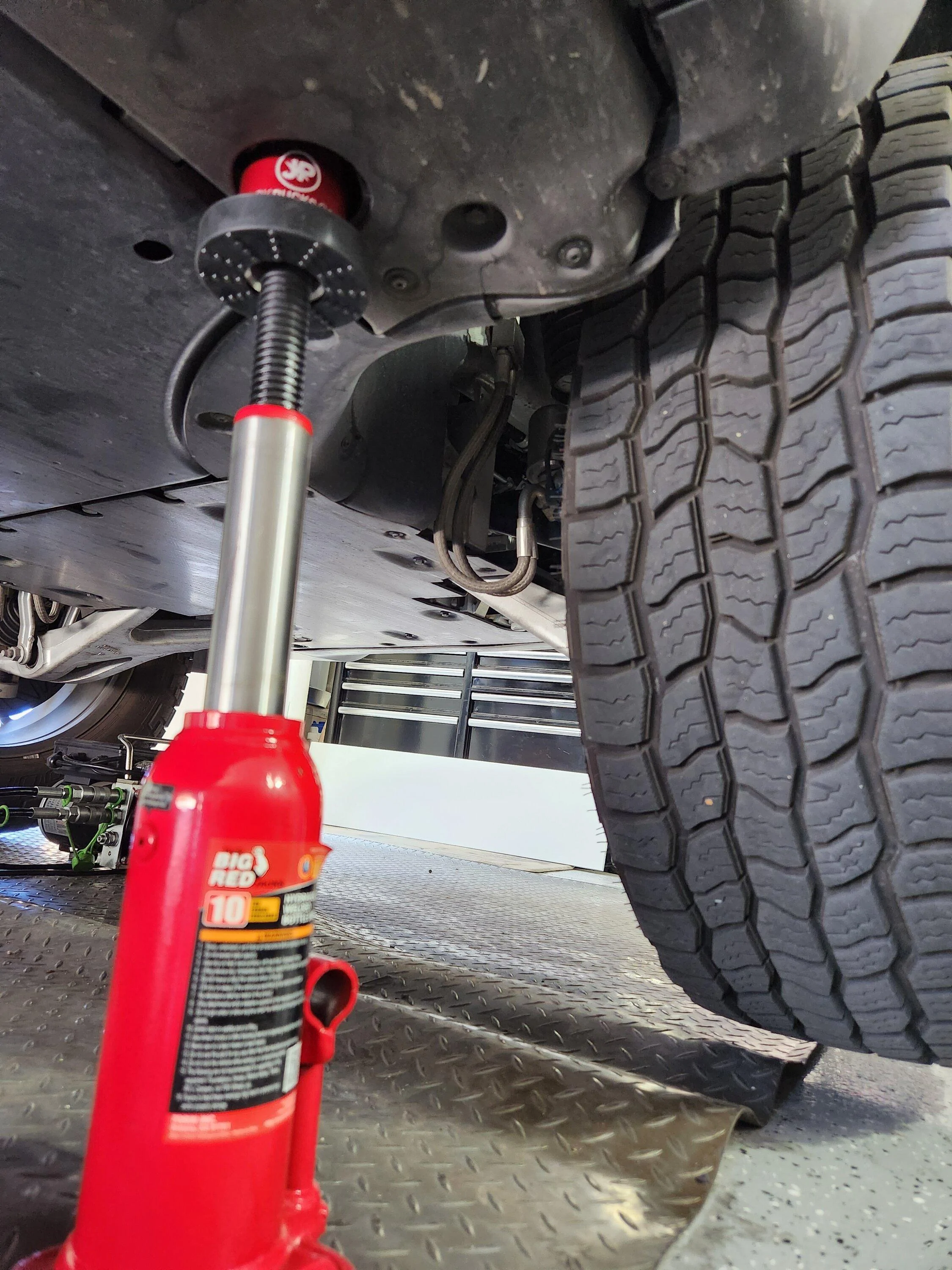

The 10T has enough height to do the job with just 1 puck?
In the front it does with room to spare, in the rear it's hit and miss (because the suspension droop in the rear is 2" more than the front) and best to stack or purchase our XL. I carry a complete kit of our magnetic jack pucks, an XL, 10T Bottle Jack, and a support pad for sand. This covers all your bases.

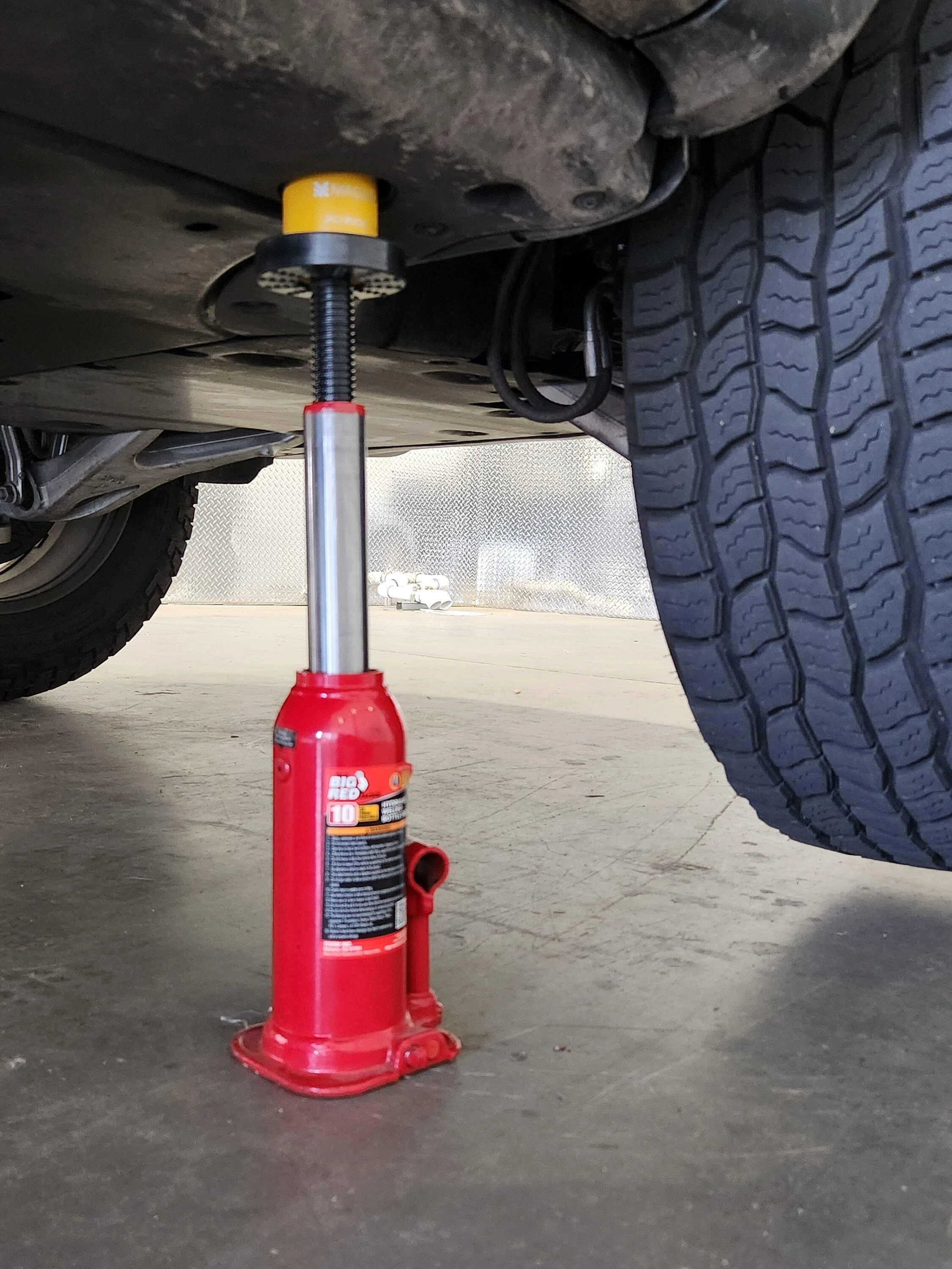

Front on our standard puck
Rivian R1T R1S Wait.. we really don't need the jack pucks? 20231007_083727

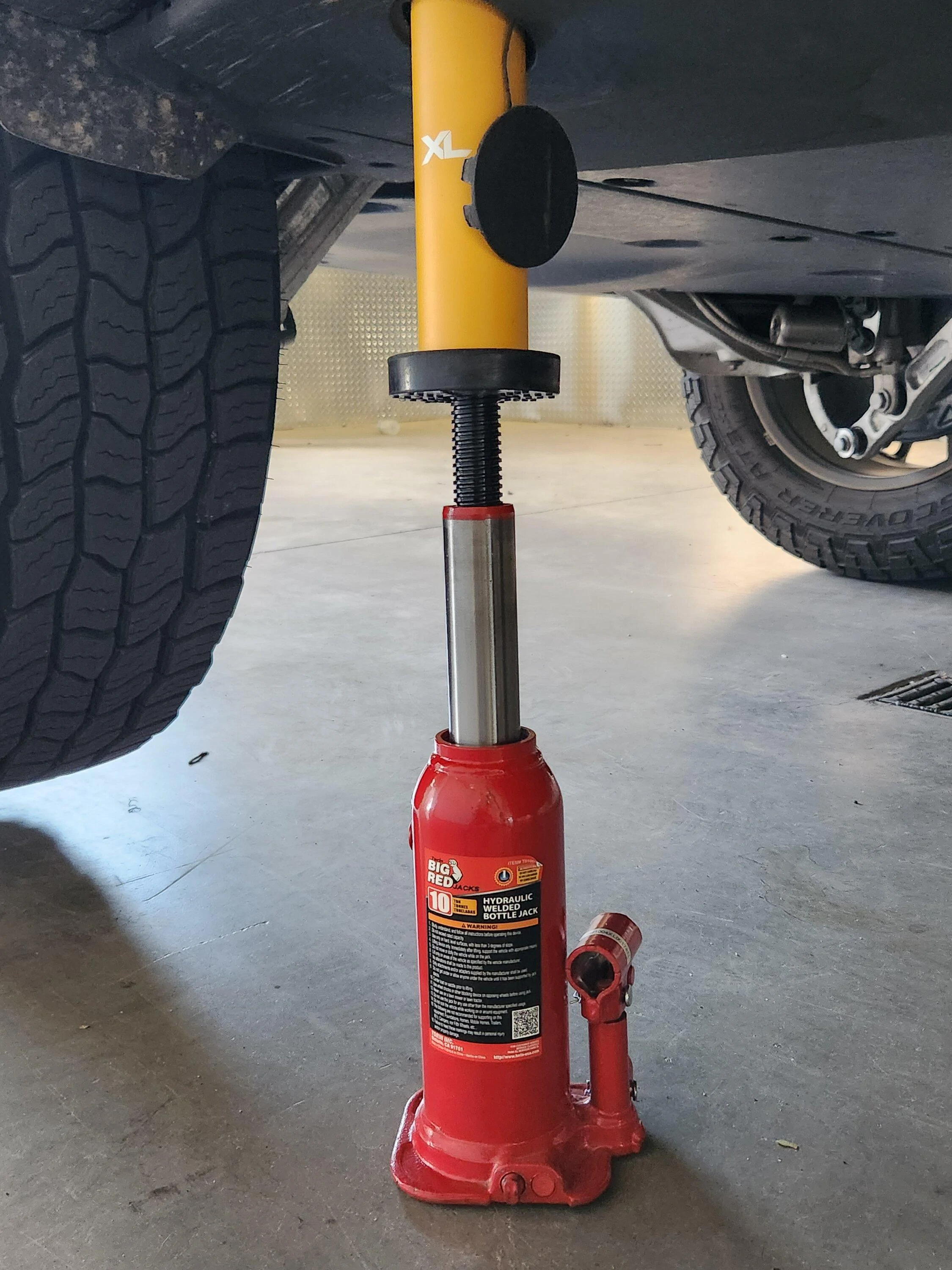

XL Below on the Rear with 20's
Rivian R1T R1S Wait.. we really don't need the jack pucks? 20231007_084504
