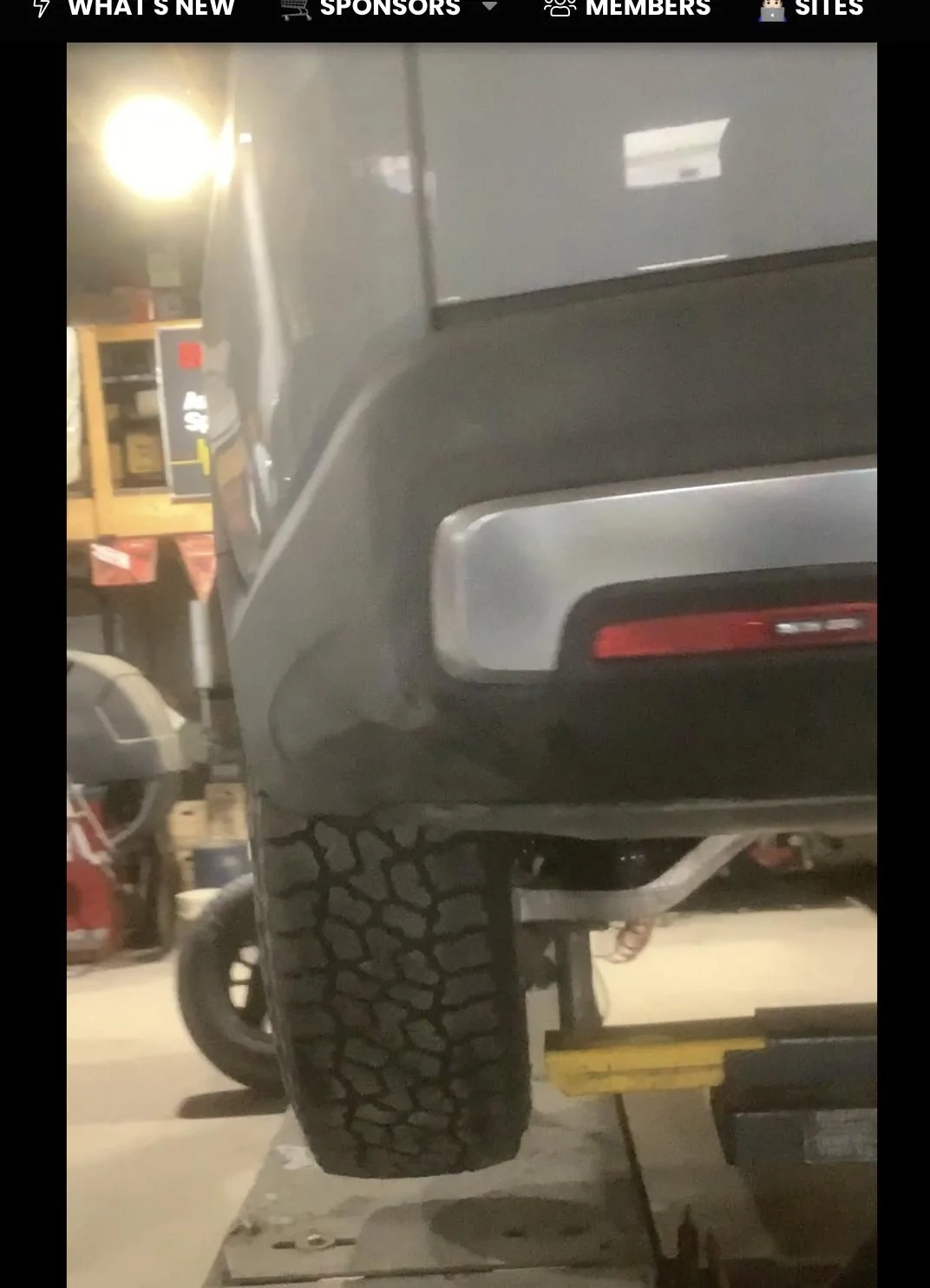

I hate the jacking pucks because they introduce two more potential pivot points, which is dangerous. Used with a floor jack on a nice flat concrete garage floor, this is unlikely to be a problem. But on the side of the road or off road, where the surface can be sloping and/or soft, this could be a huge problem, especially if you’re using a bottle jack. I have the EV Sportline bottle jack & puck in my spare tire kit, but if I ever have to use it I’ll be very careful. Removing the panels and jacking at the control arm will also be considered.
As shown in this thread, Rivians can also be jacked up at the control arms. I’m thinking about doing it this way with my floor jack next time.
Rivian R1T R1S Wait.. we really don't need the jack pucks? IMG_1290
When I got new wheels & tires, I didn‘t have any pucks, but I had read the manual and knew that I could jack up the truck by removing the panels. Before going to the tire shop, I removed the panels at home. When I got to the tire shop, the manager met me in the parking lot asking if I had jacking pucks. I said no, but I’ve removed the panels so you can jack it up like a normal vehicle. He claimed to have been trained about EV’s, and that he was not allowed to jack it up without pucks, because there are wires & hydraulic lines in the area that could be damaged. I knew this wasn’t true because I’d just been under the truck looking at the exposed frame. But he wouldn’t even look & refused to install my wheels. So I did it myself at home, without any issues, and won’t return to that tire shop again.
Thank you. This was my next reply. You beat me to it! LOL. Tire shops I've been to have just used the lower control arms to jack it up. Much easier. In fact, I do the same when Jacking up my truck at home. Again, much easier. Depending on the lift at the tire shop, they might only be able to do one end at a time, either both fronts or both rears. In either case, they don't need pucks. I simply educate them on how to jack it up and so far, each place has done it successfully.
