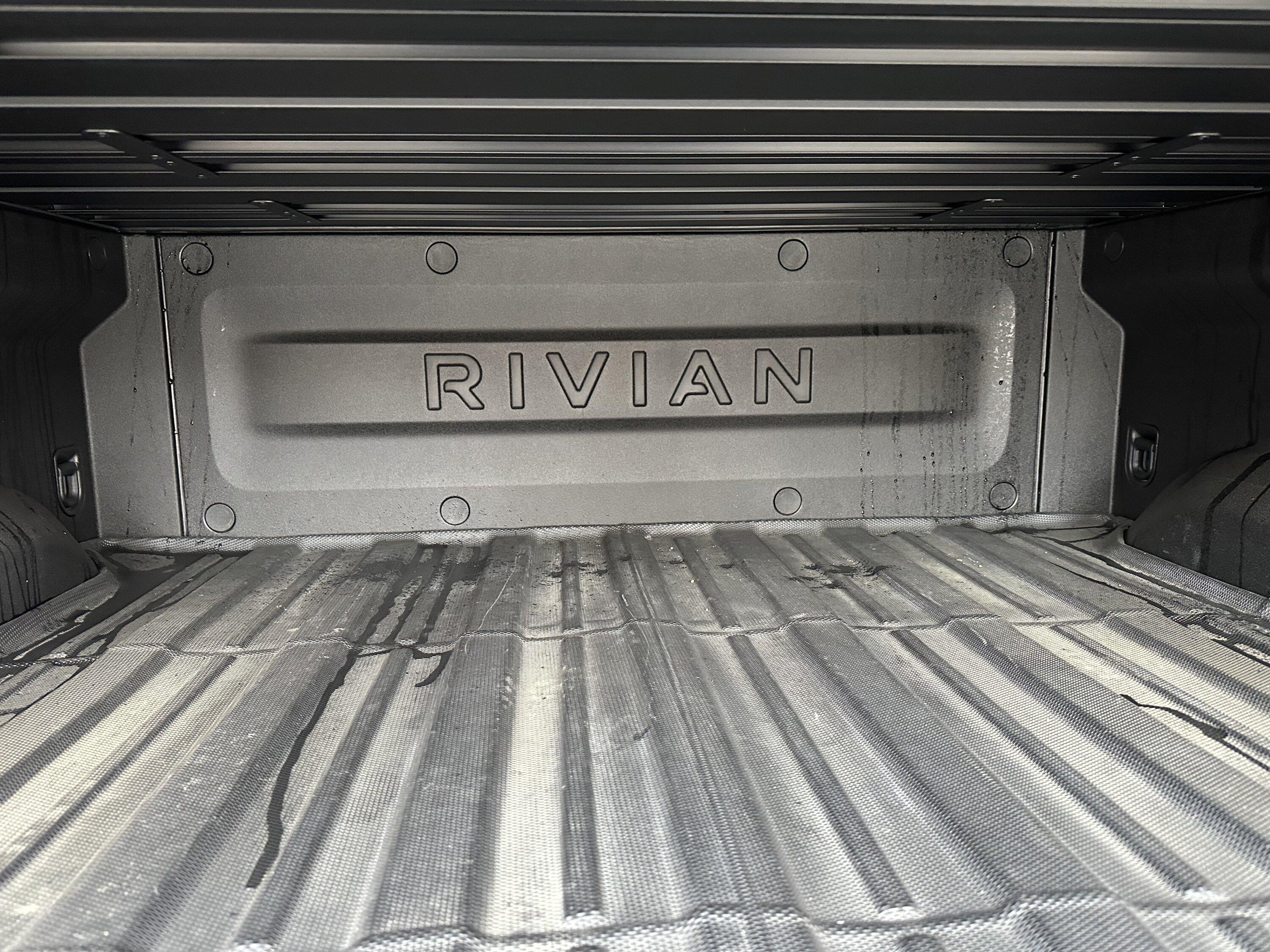

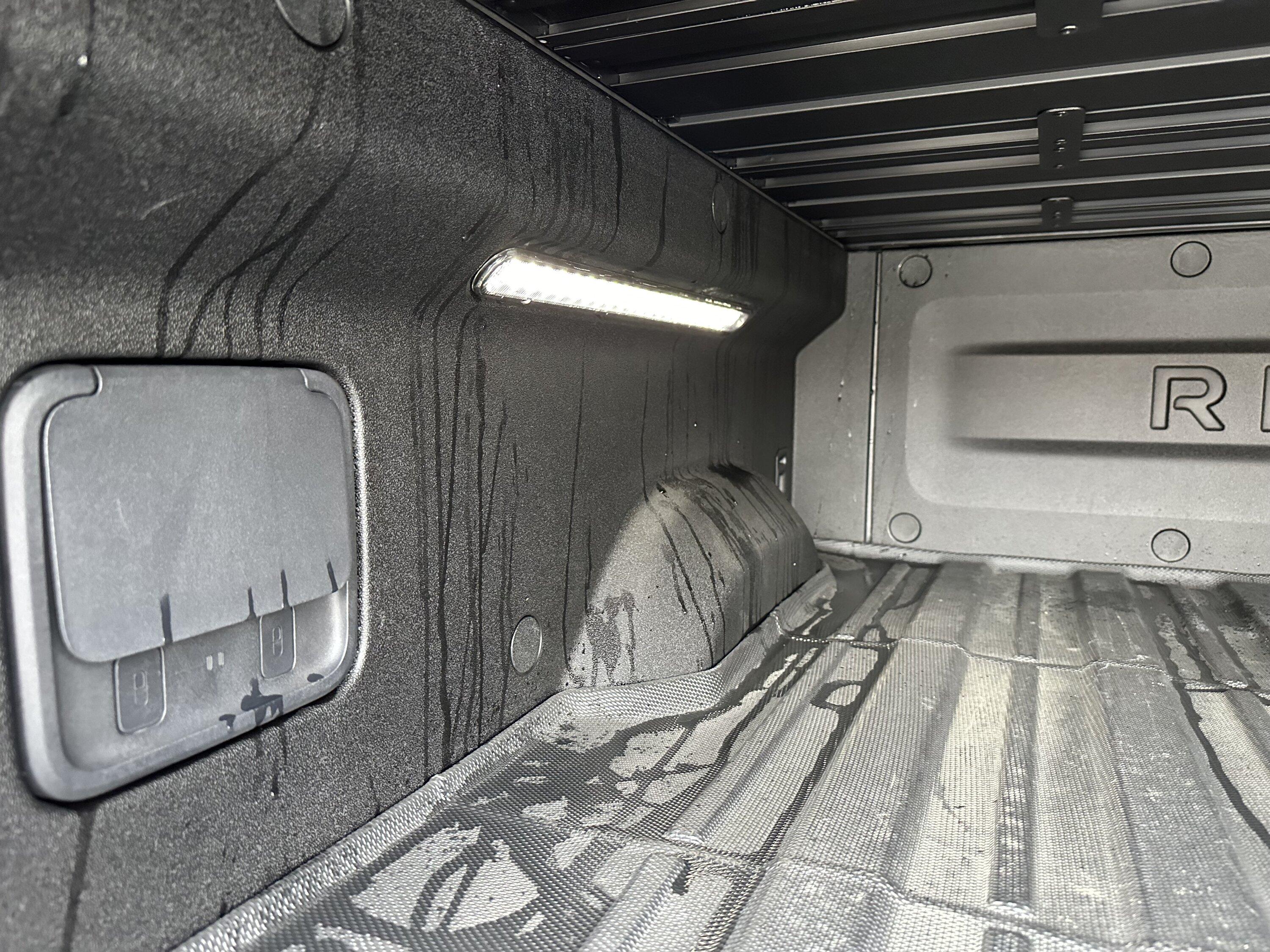

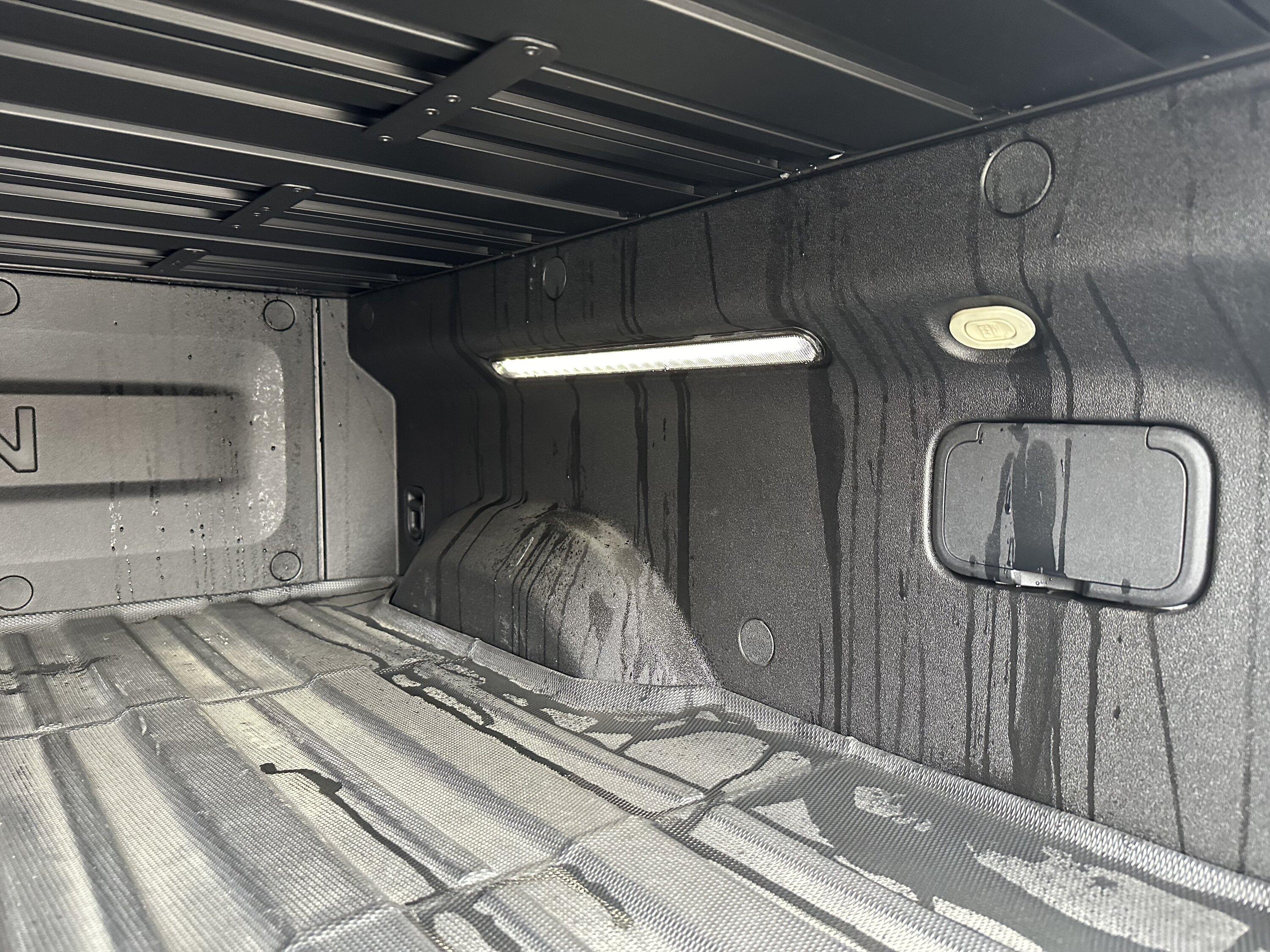

I’ve been pleasantly surprised with the water resistance of the manual cover, especially in snow. Have driven in 2 pretty wet snowstorms over the past week with zero water intrusion. Went to the touchless car wash today to get off the mag chloride and absolutely soaked it - photos below are of the water penetration, pretty minimal overall. This is going to work great at least for me. So happy to have it.
Rivian R1T R1S Water tests on manual tonneaus IMG_4294
Rivian R1T R1S Water tests on manual tonneaus IMG_4293
Rivian R1T R1S Water tests on manual tonneaus IMG_4292
