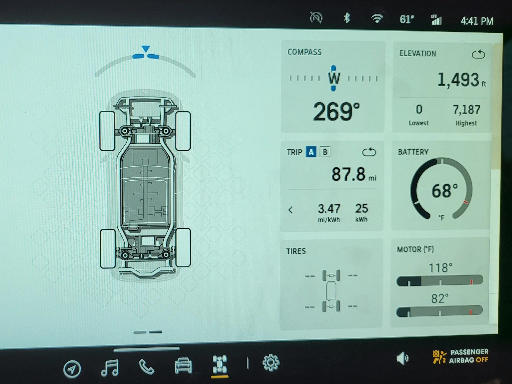

The efficiency doesn't jump to "infinity" as the car still consumes power going downhill but I've seen 8mi/kwh over extended distances when you do the math. Here's a good one where I drove 88 miles and averaged 3.47mi/kwh.
