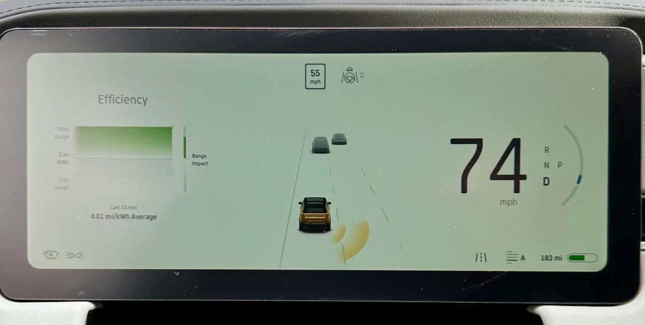

Why is 4 mi/kwh the max in the Efficiency screen?
Jabbahop
Michael
Sep 5, 2021
190
300
utah and vermont
‘14 BMW i3, ‘19 BMW i3, ‘22 R1T -> ‘24 R1S Max
Seems like there is a hard limit @ 4 mi/kwh on the efficiency screen no matter how slow or how much you descend. That screen and the max efficiency was the same for our R1T with 20” AT as it is for the dual motor R1S with 21” AS tires.
Anyone know why?

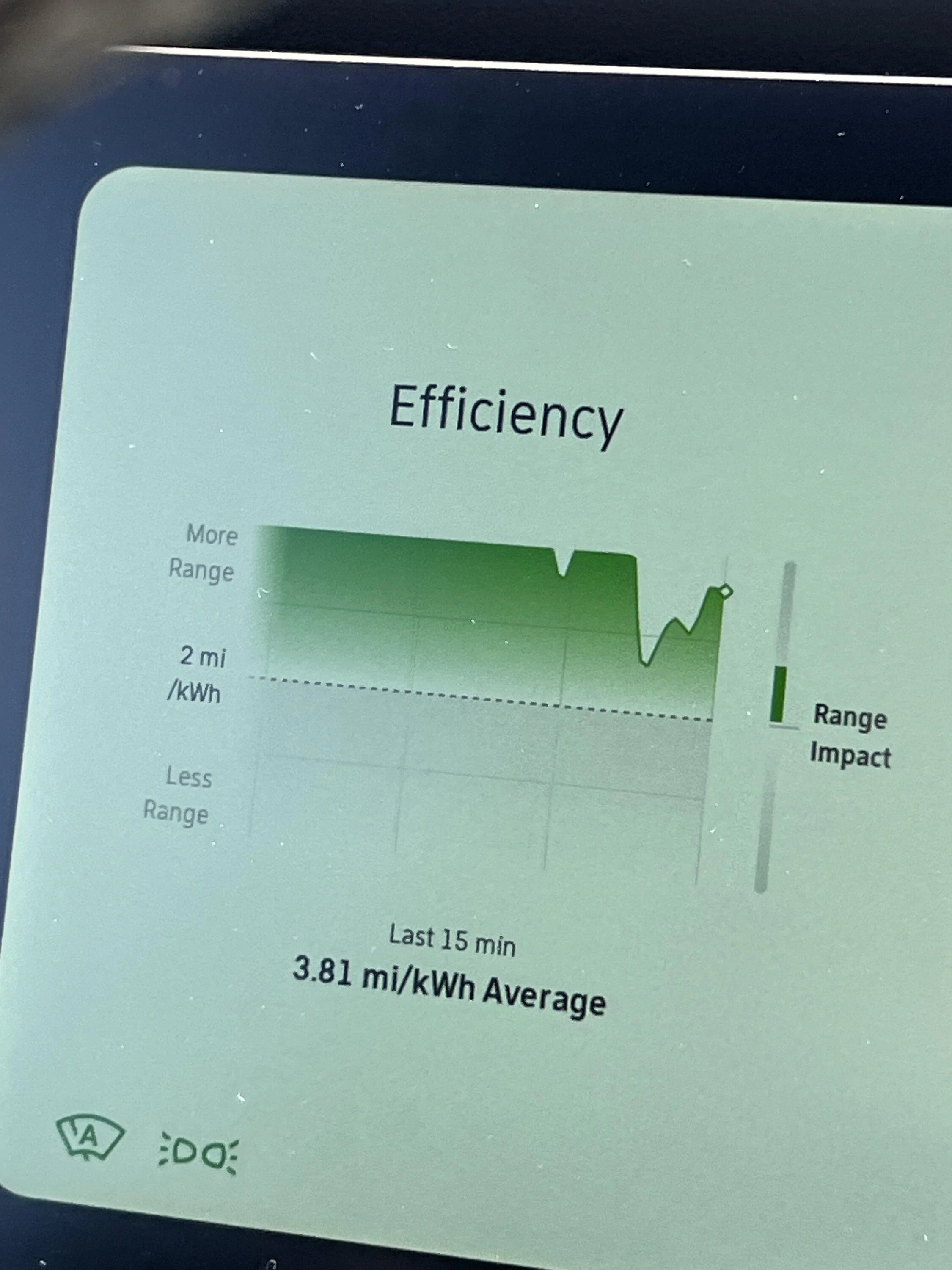

the average efficiency reading does go over 4%, just the graph doesn't. Even coming down from the mountains averaging 80-90 mph, you can still get it over 4 (I had to slow down to take the photo)... Going up is another matter. I'm lucky to get close to 1.5 on the drive up.
Rivian R1T R1S Why is 4 mi/kwh the max in the Efficiency screen? IMG_3557
