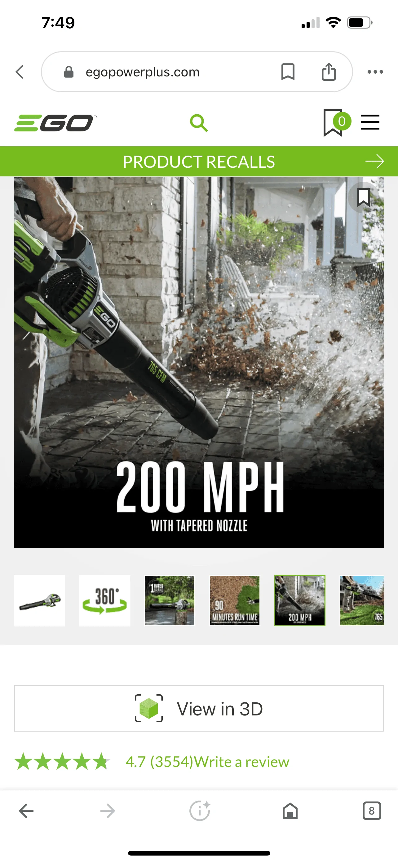

I used a high power leaf blower to test for noise. EGO make one that blows 200 mph. That should be a testing tool. I’m bringing mine with me next month to the SC.
Rivian R1T R1S Wind noise (roof) R1S IMG_3713
Good plan. I wonder how they’ll react…
