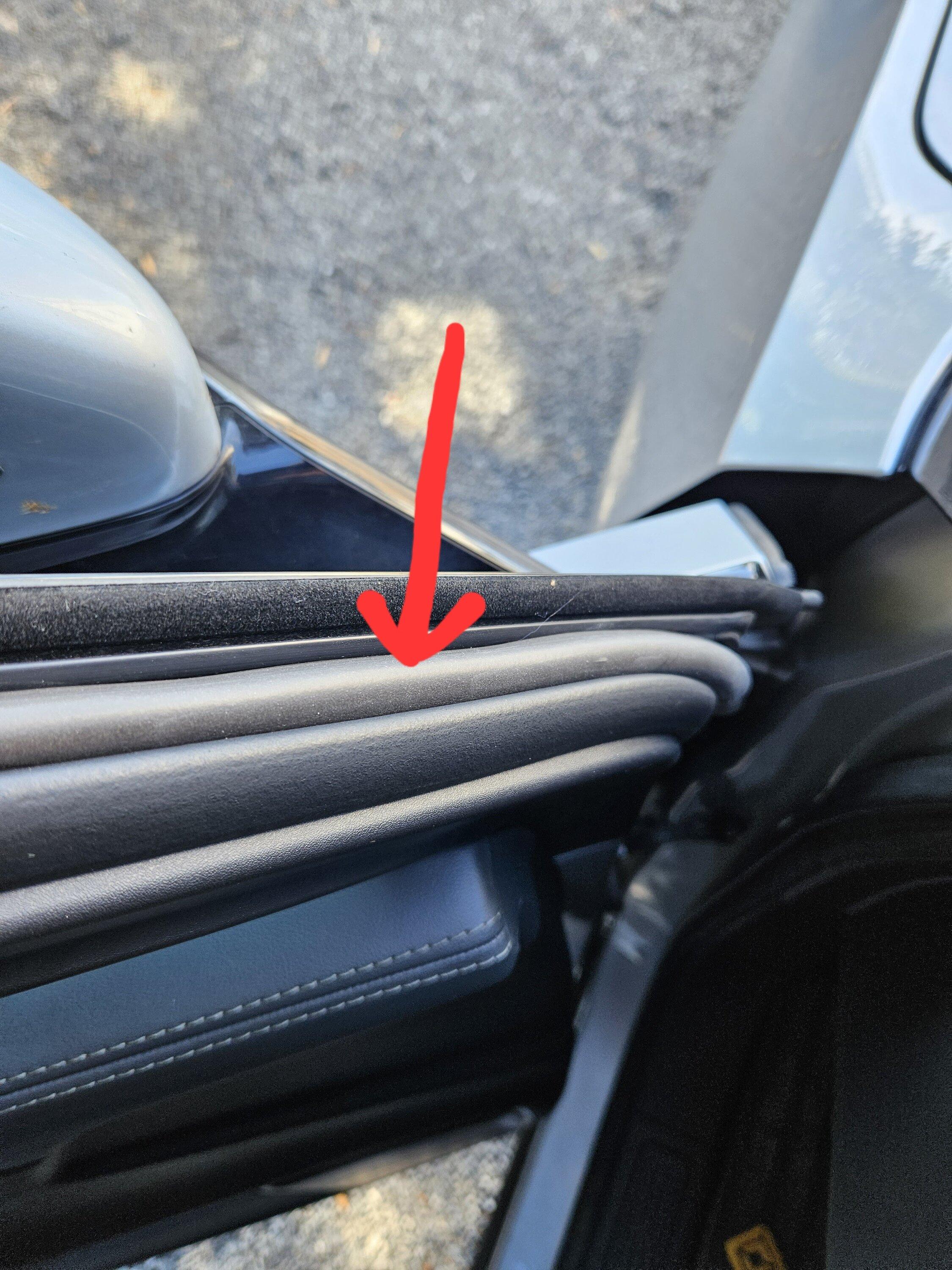

The small round tubular shape I inserted in the outermost seal along the top of the door on the outside of the top of door, see it inserted in the photos taken from the outside looking at the door.

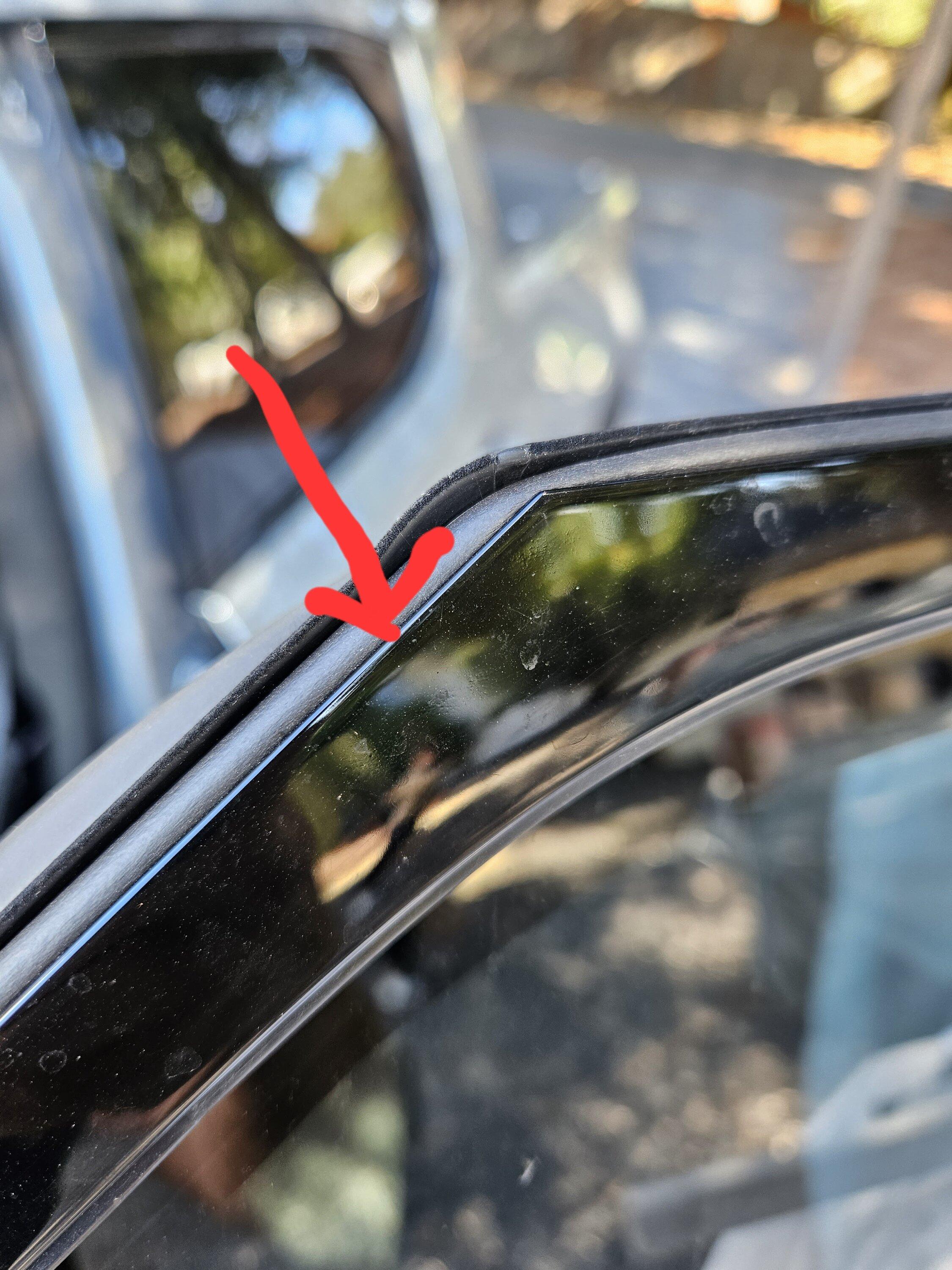

The u-shape is added along inside of the top of the door from the front of the door until before it curves down at the back of the widow ( stand with door open and stand on inside looking at top of the door). I did not intall the U on the truck body, only the door as you hopefully can see. The door shuts well, but with it on the body it did not shut well and felt forced.

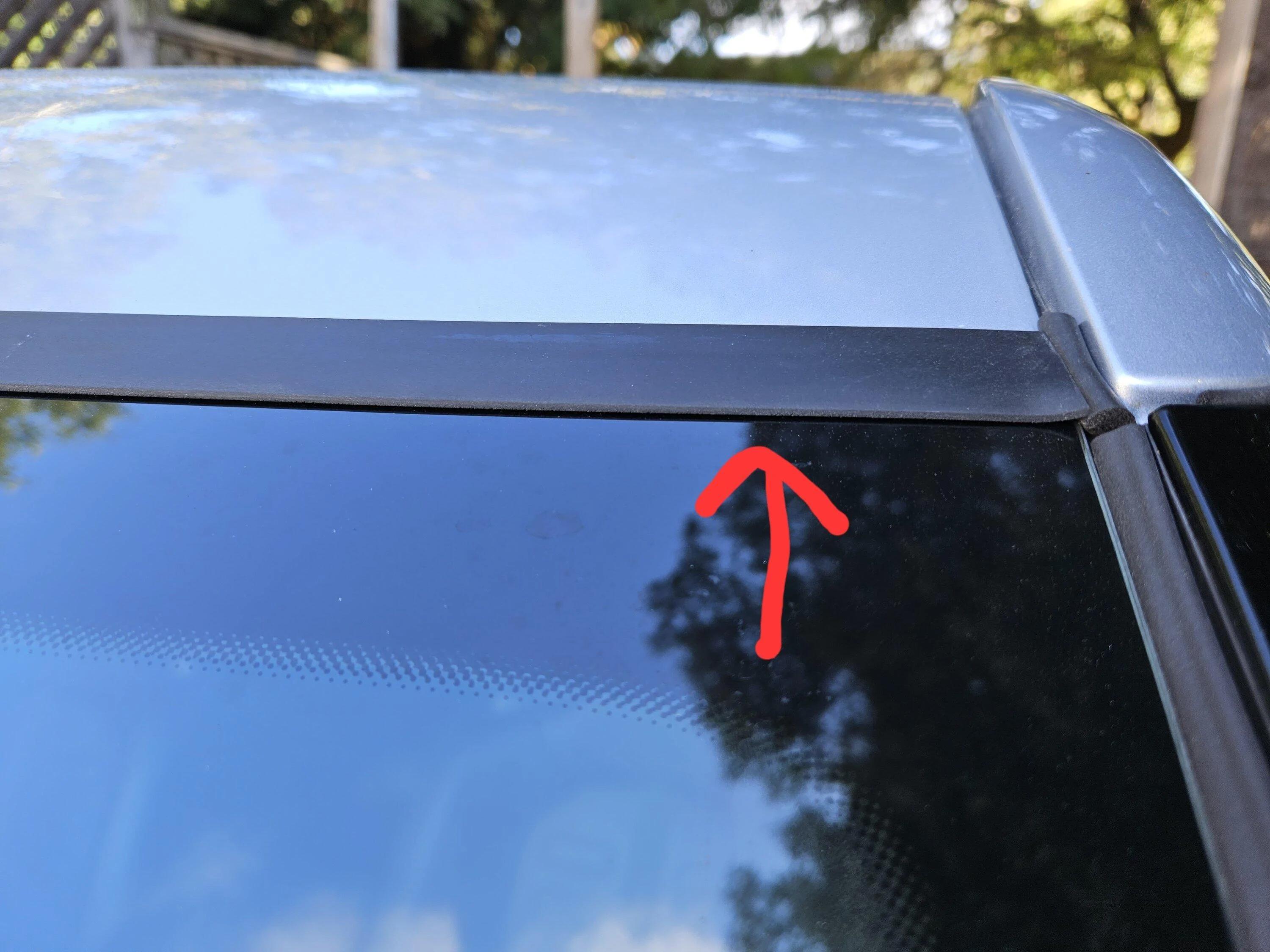

The T-shape along the front top of windshield and body. I did nothing more up there.

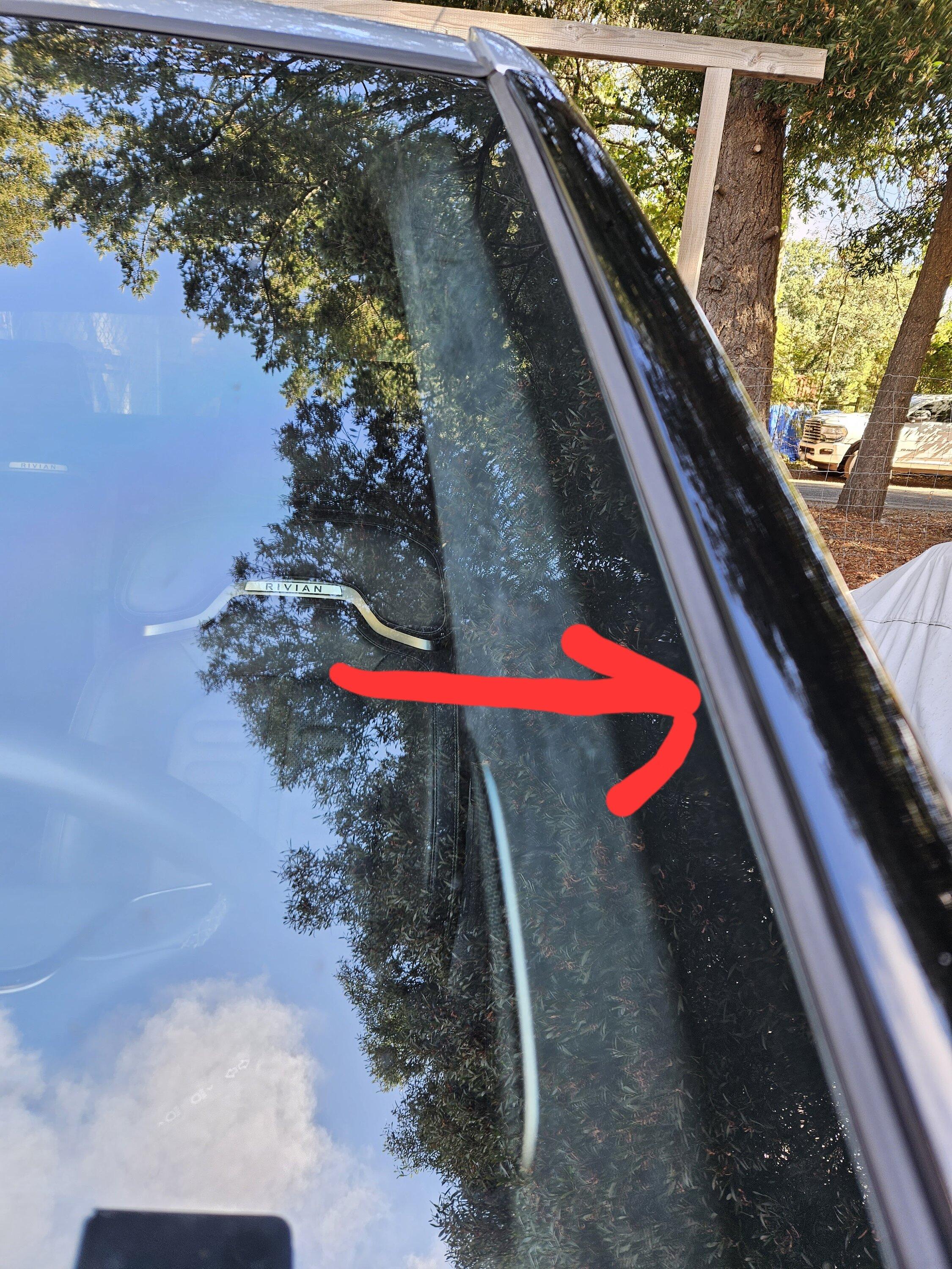

I ran the L-shape, with the L tucked under the A pillar and used a credit card sized plastic smudge? tool to work it into a little angle along the pillar on both sides, I did not use the adhesive as it wedged in easily.

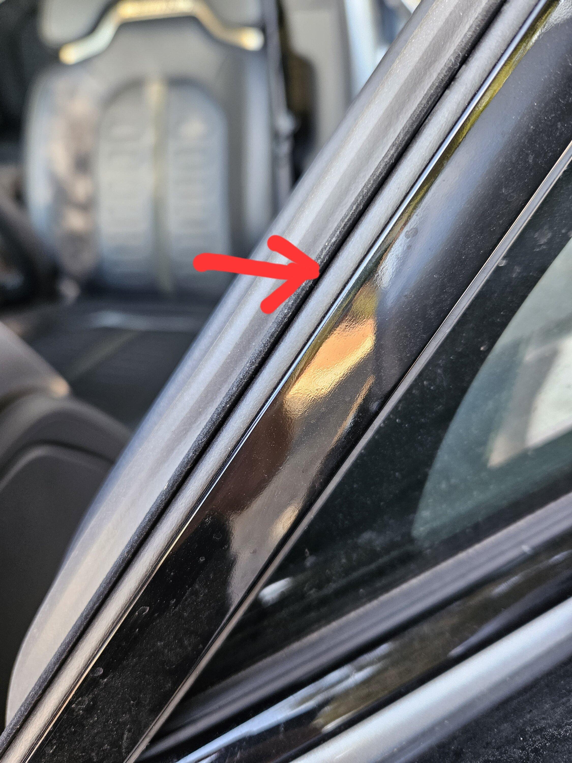

I tried everything but messing with the triangle window trim, and no change. So I'm pretty convinced it's there. I'm going to tape it up good with electrical tape later and see if I can find the spot.

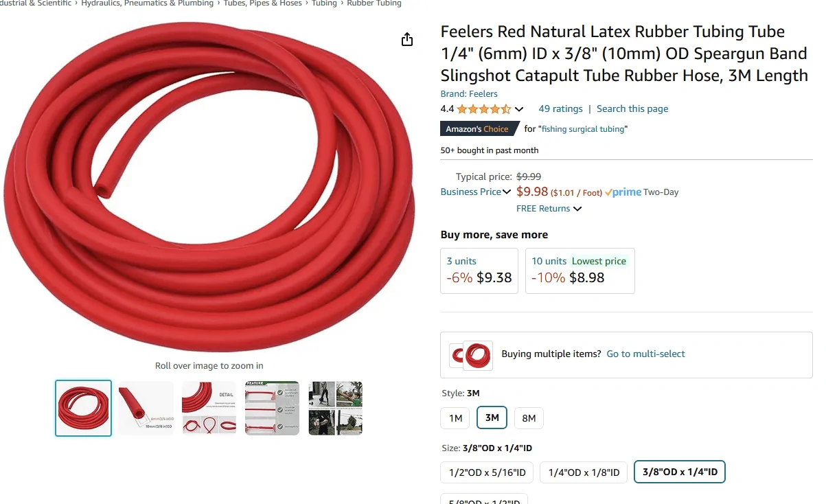

Was this what you bought?
https://a.co/d/bA2YjGy

Totally unrelated (my R1T is pretty quiet to my ears), but Amazon must know I've been clicking on some of y'alls links and just recommended this product to me:
Rivian R1T R1S Wind noise solved at last -- using tube rubber seal 1717600984162-i9
