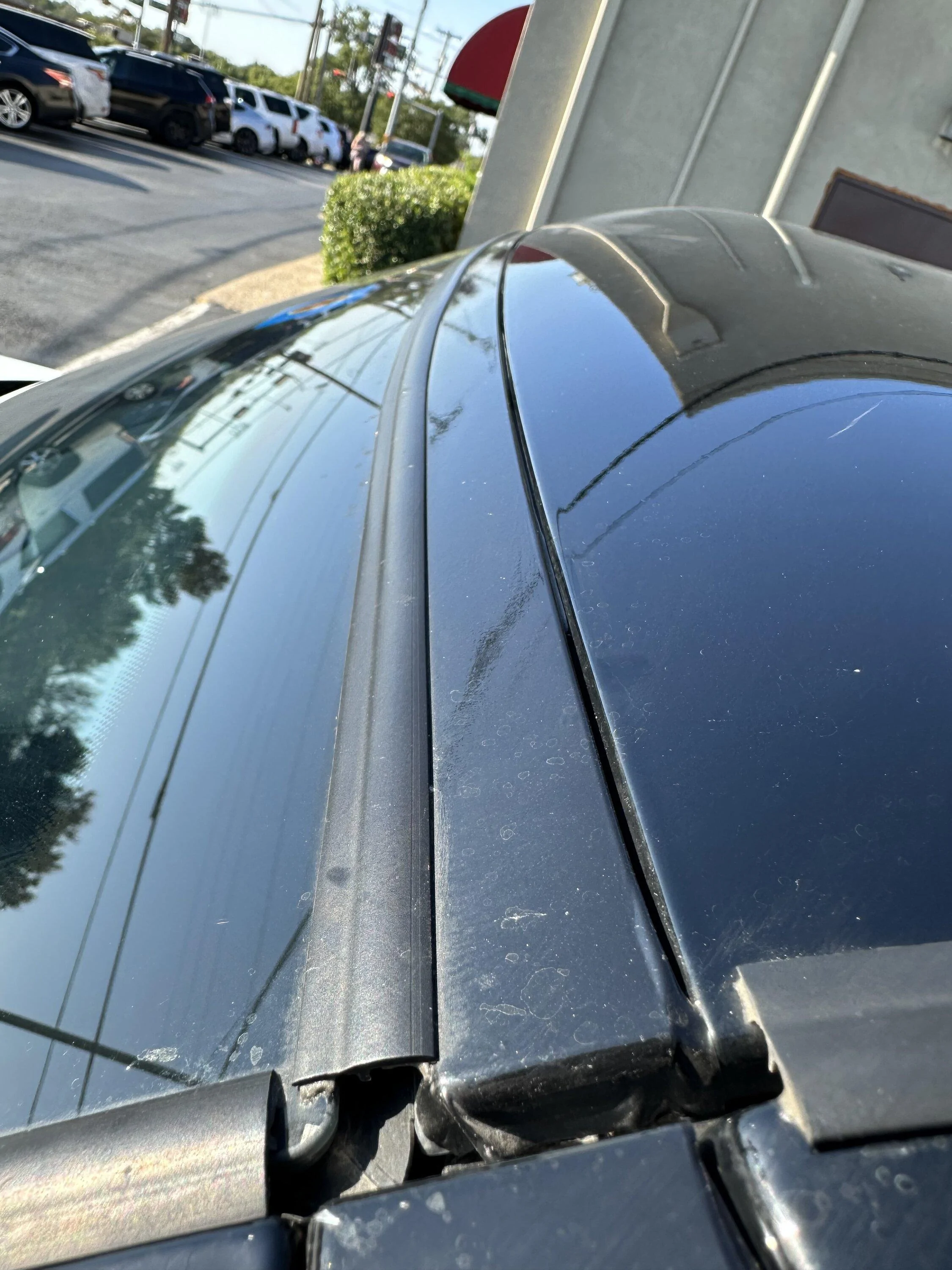

I actually did the roof and the windows before . Did not see much improvement. However, I just bought the round and L shape tube. Both of them are on the way. Will definitely let you know if it works out.@LL75 let me know how it goes on the R1S. I ordered the stuff OP mentioned, one of each. May need to order another L shape strip

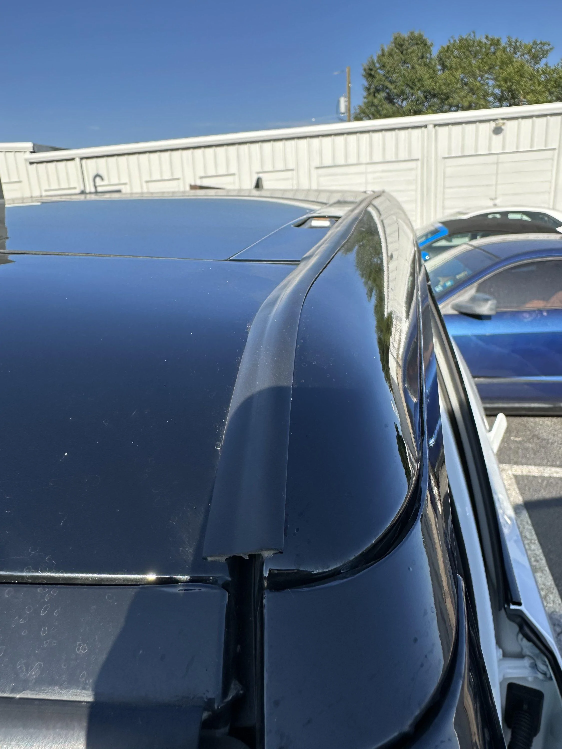

the round cord it to fill in the gaps in the roof around the moon roof and the black plastic strips and above the black a pillar cover beside the windshield that gap is a bit significant and I thought to fill it up to just incase are caches ther and cause and kind of noise
I tried the round tubes and didn't notice any improvement in the wind and whistling noises. The tube is a bit tight fit in a few locations, but once it gets passed the surface there is a lot more room. So not surprised that it didn't help and will be removing it. Going to try the windshield next. I have some concern about the 3M adhesive and potential damage if it doesn't help wind noise. Anyone tried and then removed?

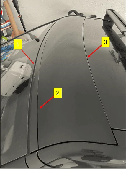

So is the round tube suppose to go inside the car on the pano edges or outside the car on top? So if its inside the car, .25 is too thin. It just slips right in there and is not very snug so idk if that going to do anything.I did the windshield and the roof as well awhile ago following the video I posted earlier on this thread. Not much improvement to be honest. FYI. I returned the round tubes because it is too small
The t shape going to number 1 and along the side with photos attached. The round tube is too large for number 2 or 3 and too small for the back gap. I did the T shape and windows a few months ago and did not see much improvement following the video posted in this thread. I may try to force the round tube to number 2So is the round tube suppose to go inside the car on the pano edges or outside the car on top? So if its inside the car, .25 is too thin. It just slips right in there and is not very snug so idk if that going to do anything.
Ok so for us slow ones, like myself, I require pics. Where does the flat T shape one go? I'm assuming 1? If one, what about 2 and 3?

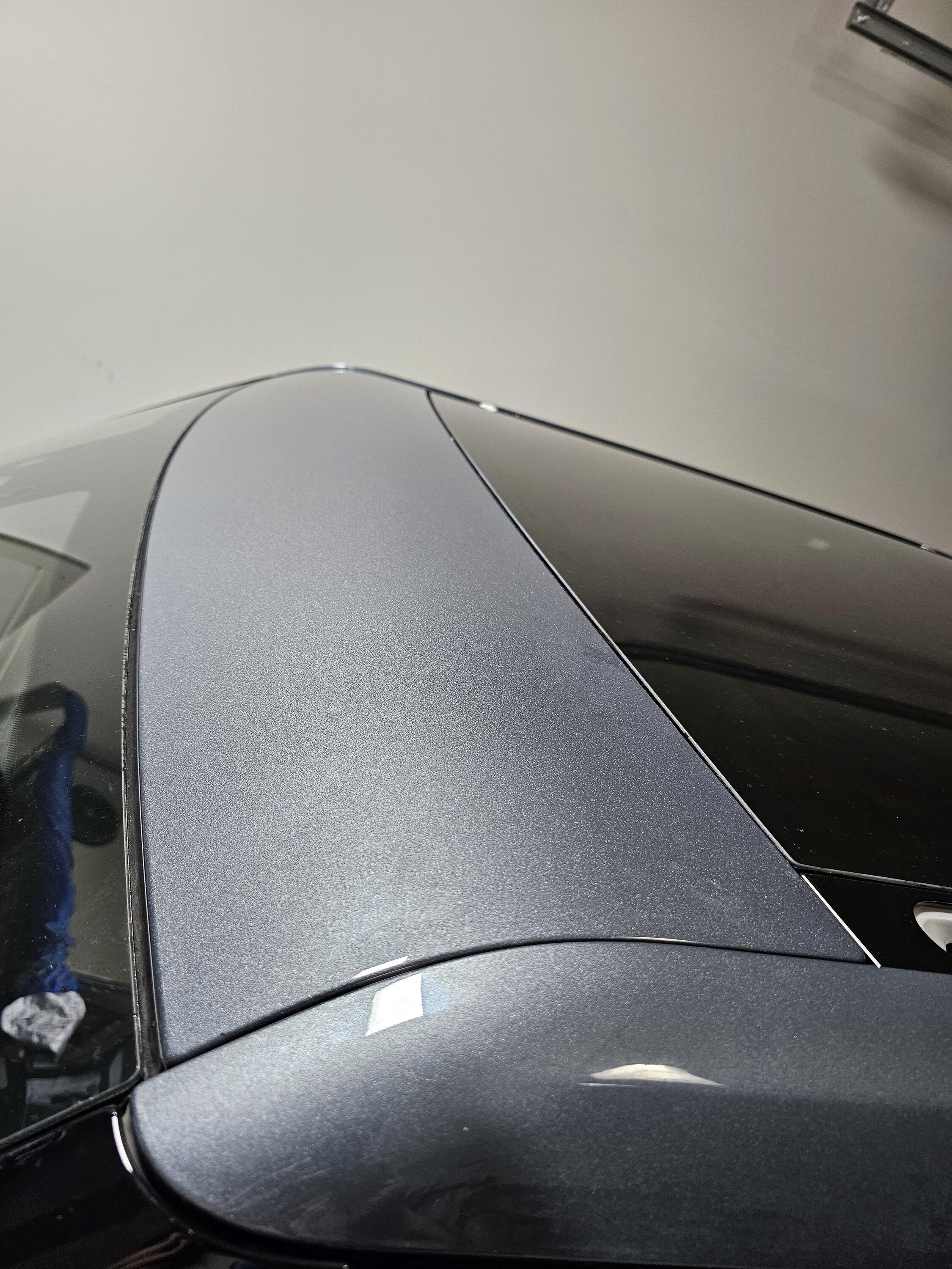

Interesting because mine doesn't have the #2 gap. I did the #3 and removed it. I plan to do the #1 but concerned about paint damage. The service center has already replaced the windshield, applique, channel seals and roof glass. So far nothing is helping.So is the round tube suppose to go inside the car on the pano edges or outside the car on top? So if its inside the car, .25 is too thin. It just slips right in there and is not very snug so idk if that going to do anything.
Yours must be a R1T?Interesting because mine doesn't have the #2 gap. I did the #3 and removed it. I plan to do the #1 but concerned about paint damage. The service center has already replaced the windshield, applique, channel seals and roof glass. So far nothing is helping.![]()

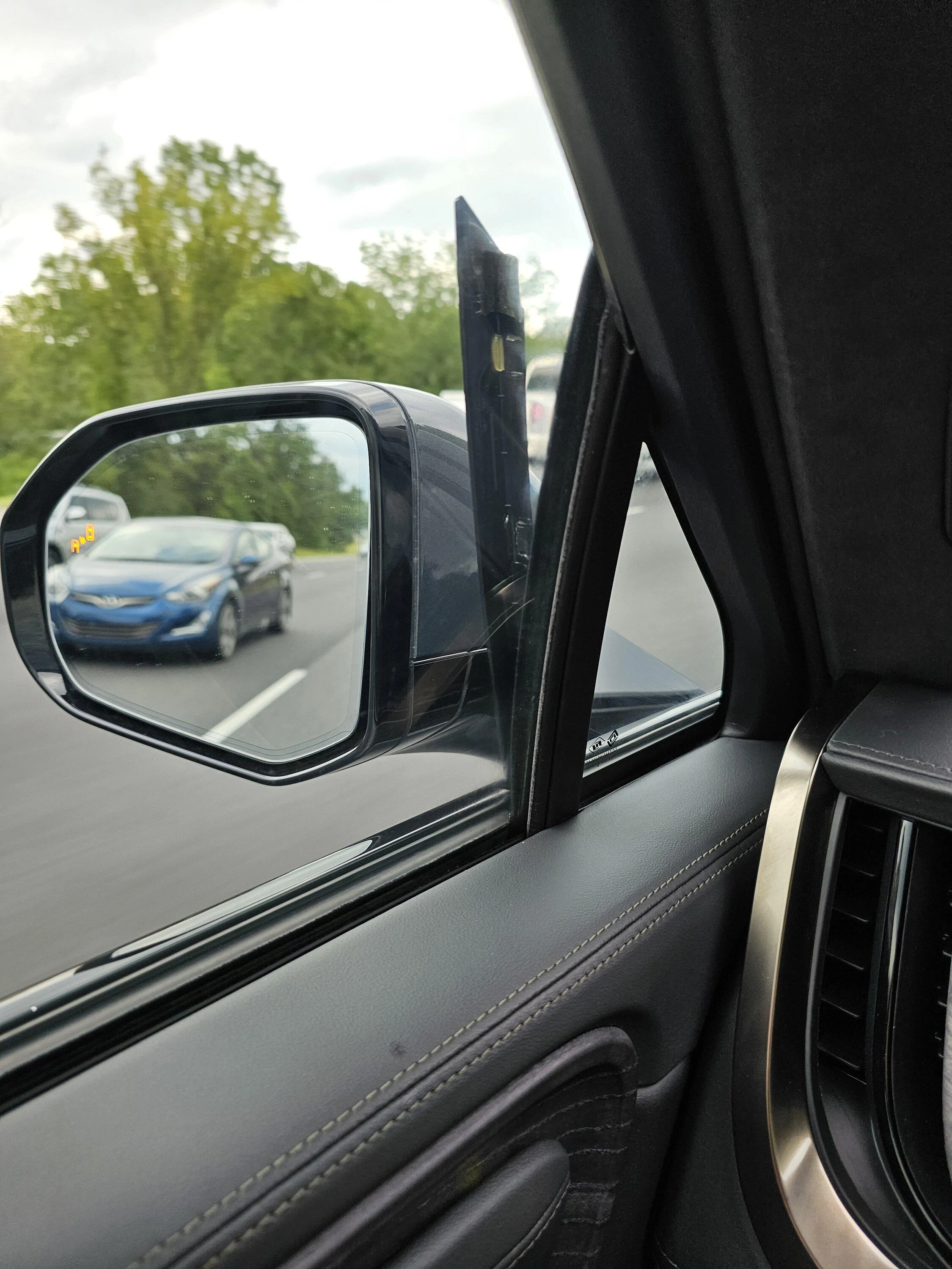

There is a service bulletin to replace that triangle piece if it is looseIt is. I didn't notice the others have R1S. Mine is an early serial number and thought that would be a bigger change for them to make along the way. I though maybe they changed the size of the applique. I also have a new loose piece by the triangle window. It popped out while driving down the interstate. I was able to roll the window down and get it to stay until I got home. Then I was able to slide it back into place and it looks good. Curious to see if that helps with the noise in that area.![]()

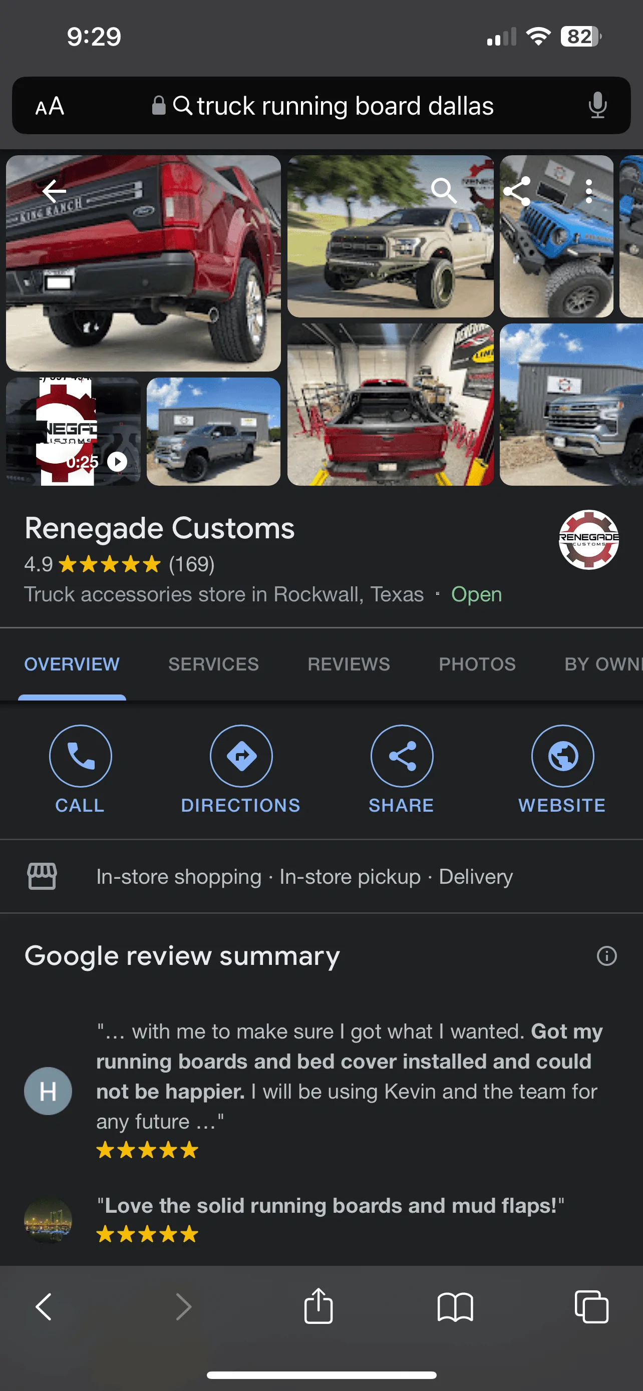

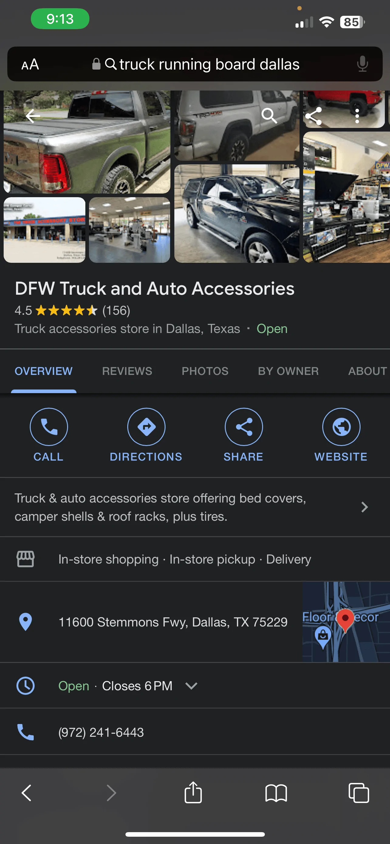

Off topic. Did you have the phone number to the shop that you called in dfw for the evsportline running board installation? How much is it?So is the round tube suppose to go inside the car on the pano edges or outside the car on top? So if its inside the car, .25 is too thin. It just slips right in there and is not very snug so idk if that going to do anything.
So the guy I called had no experience with EVs. He was charging $600 with circle hole approach. So I just decided to do it myself.Off topic. Did you have the phone number to the shop that you called in dfw for the evsportline running board installation? How much is it?

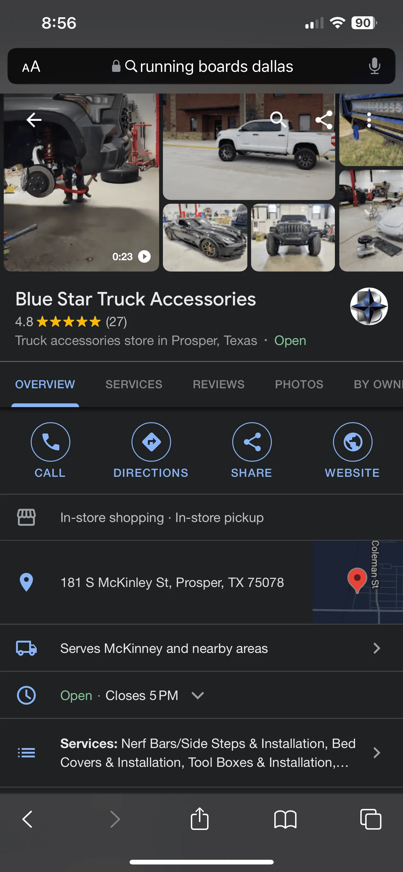

Try these three shops.So the guy I called had no experience with EVs. He was charging $600 with circle hole approach. So I just decided to do it myself.
