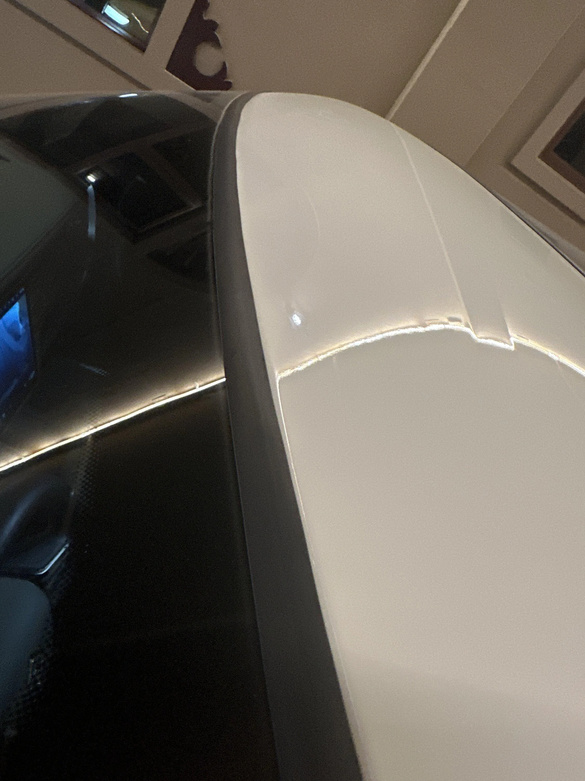

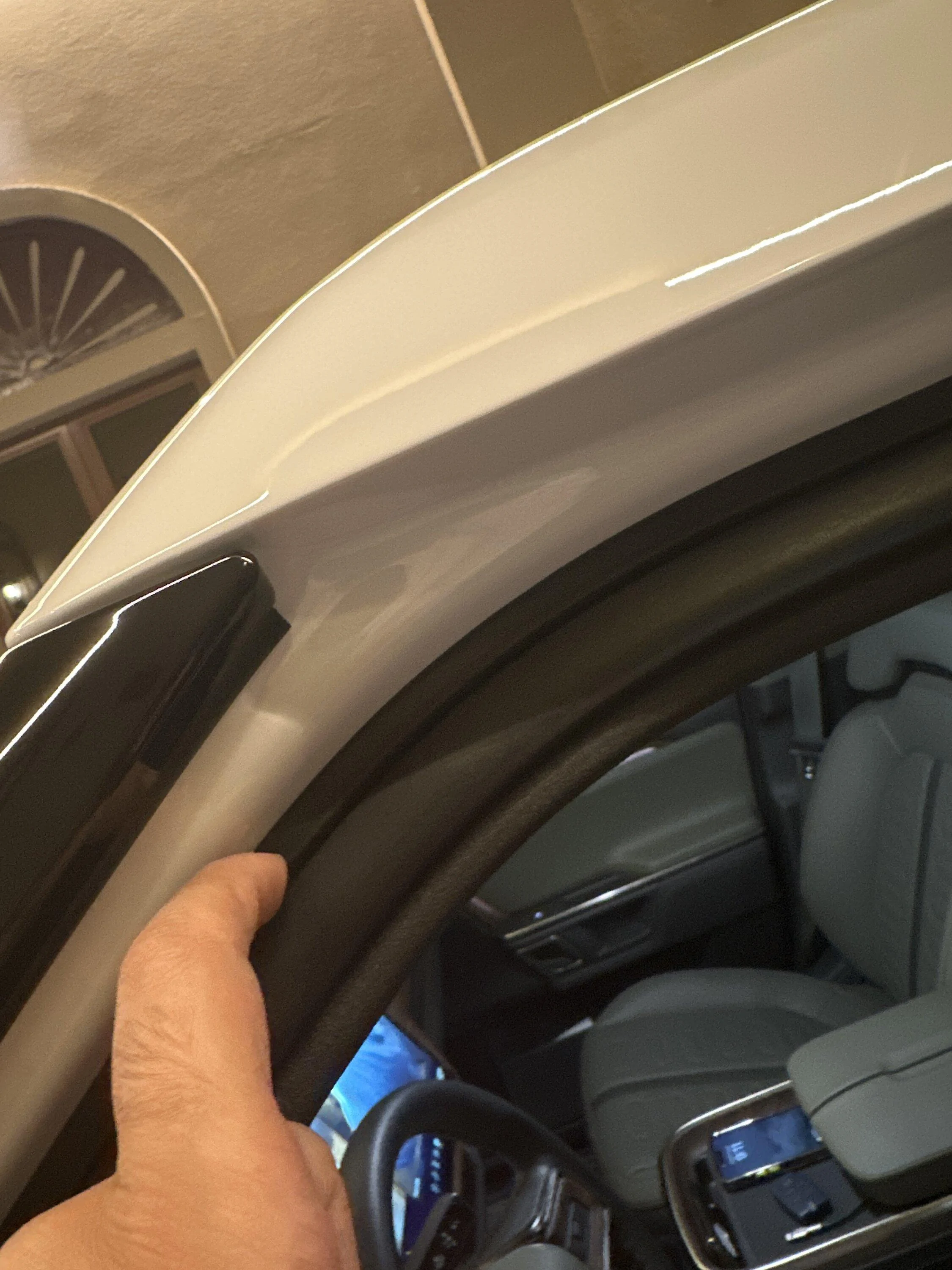

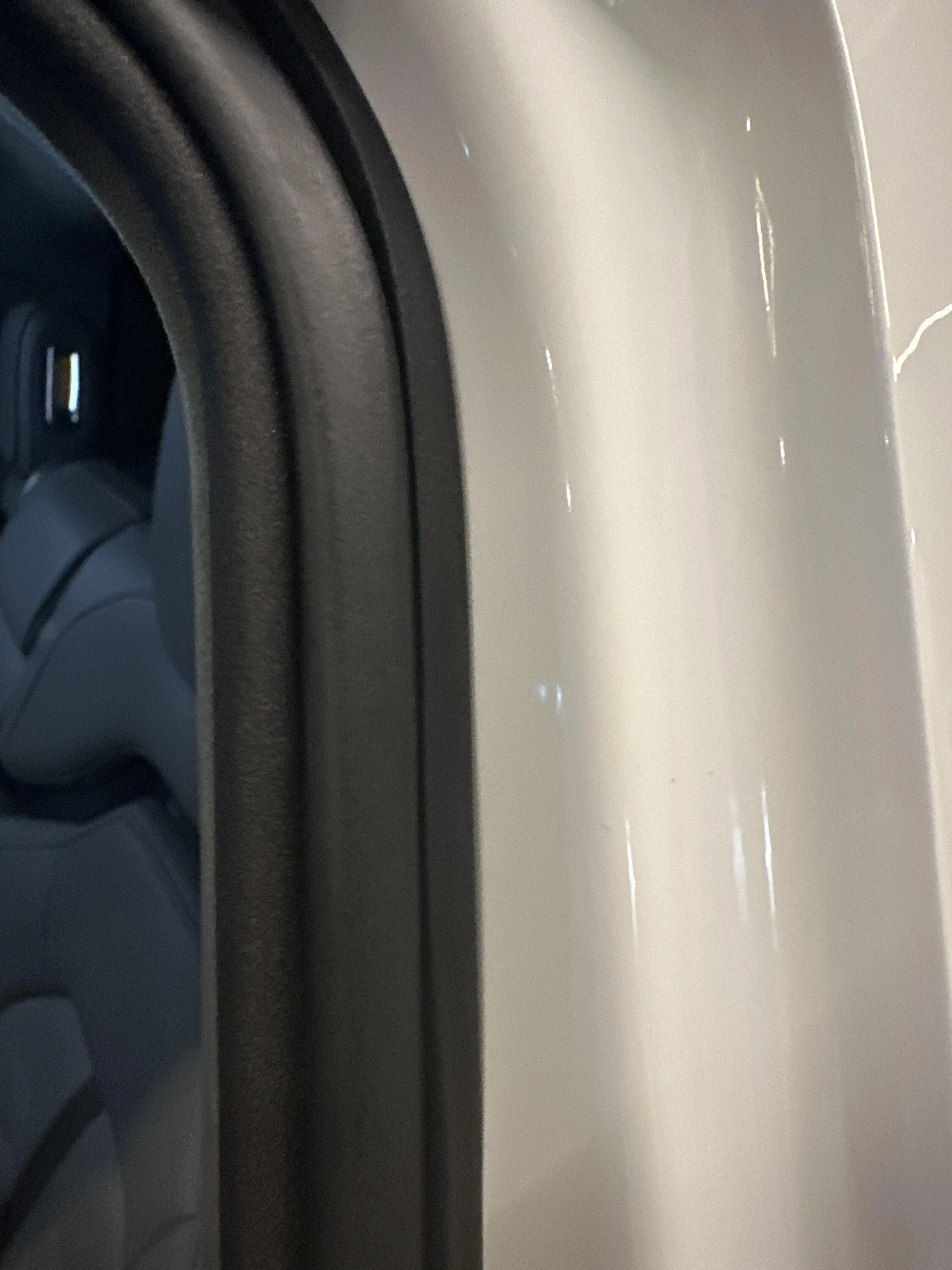

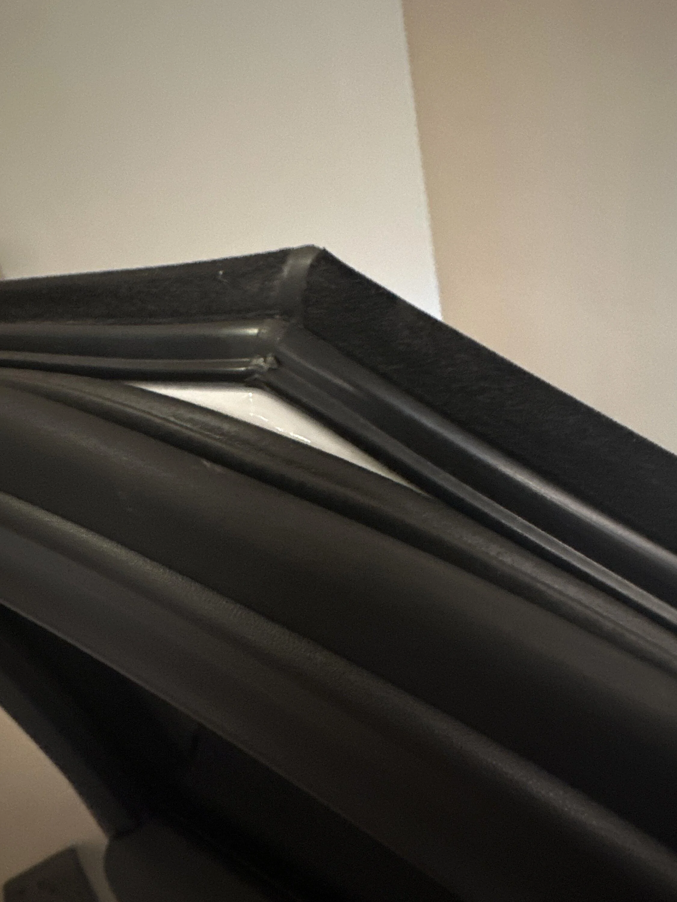

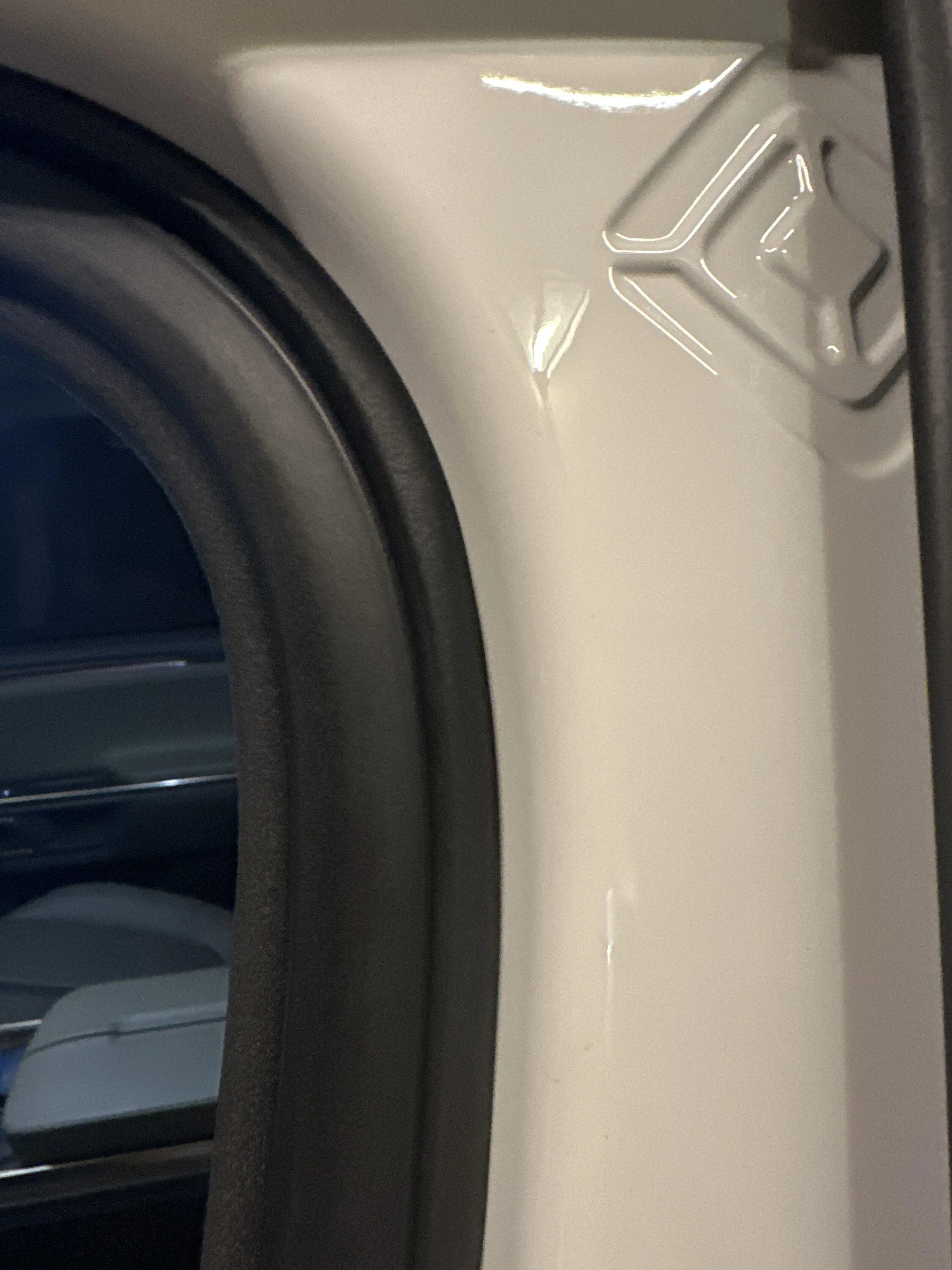

for the doors i used some weatherstripping rubber to have it installed exactly beside the factory rubber on the cab to give extra insulation also put a strip of rubber on the doors them self to have an extra layer of sealing.

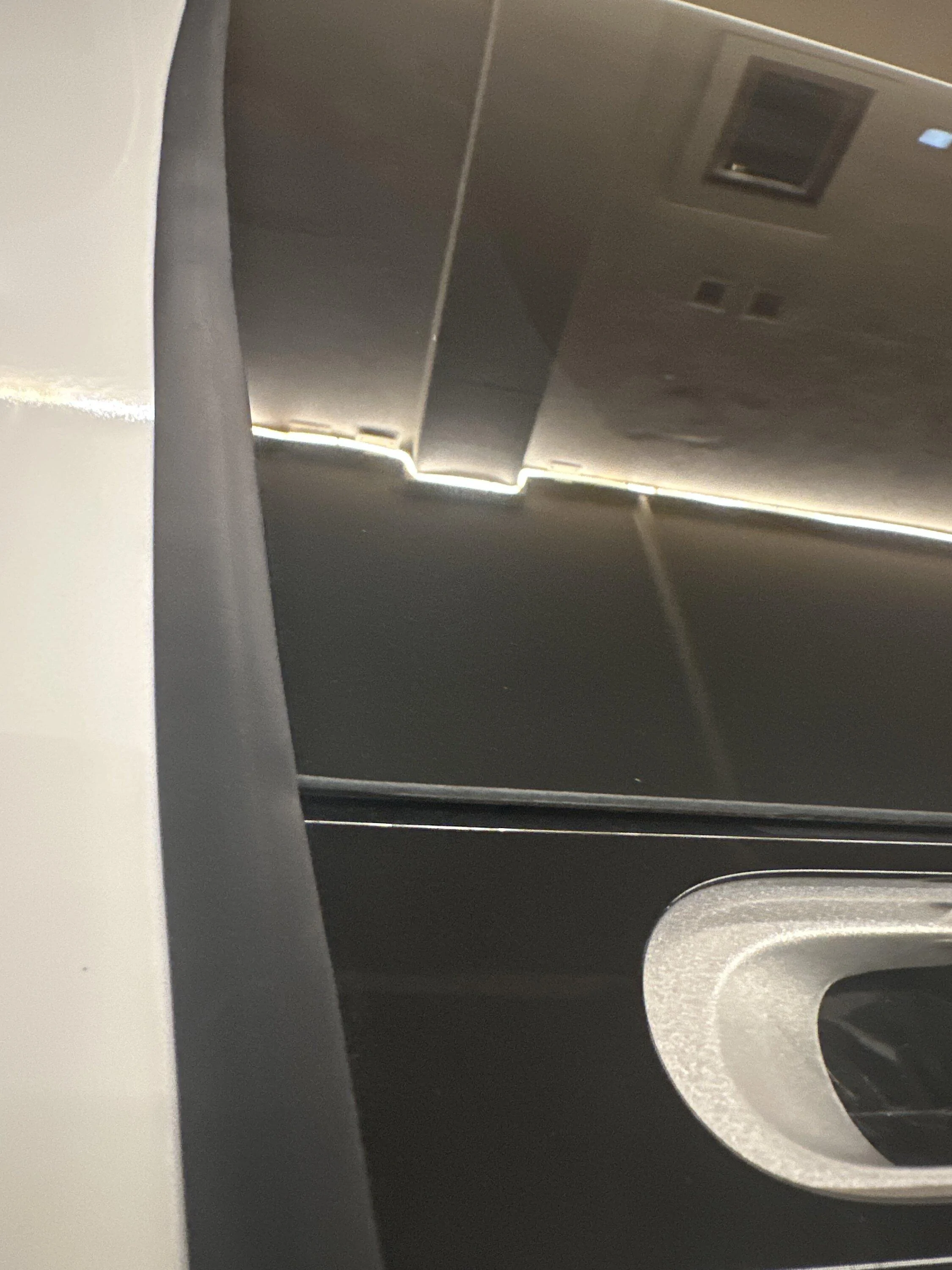

as for the front windshield and the sunroof i have installed a flat rubber seal that you cant tell it installed after all said and done also installed it under the windshield.
and for the gaps in the roof between the black strips and the sunroof i installed something called a tube rubber seal that tesla owners use , you can squeeze it into the edges and it will drop in and you want see it at all.
and after testing the car on highways for the past 3 days I can tell you the wind noise went down almost 90 to 95% and by that i mean it almoSt dead silent. A huge different.
i was so excited to have solved this issue because almost everyday im on the highway commuting and the wind noise was starting to really get on my nerves.
Thought I would share my experience and maybe could be helpful to some of you guys. Attached you will find the products I used and tomorrow I’ll attach pictures of the car with all the rubber installed .

Would you mind posting some close up pictures of the various weather striping installed around the doors and windshield?

You mean the INSIDE of the door frame, not the exterior A-pillar and triangle window! Genius. I never considered this. I tried painters tape on my A-pillar and it didn't help.
Do you have a website link to the gaskets you got?
here you go
