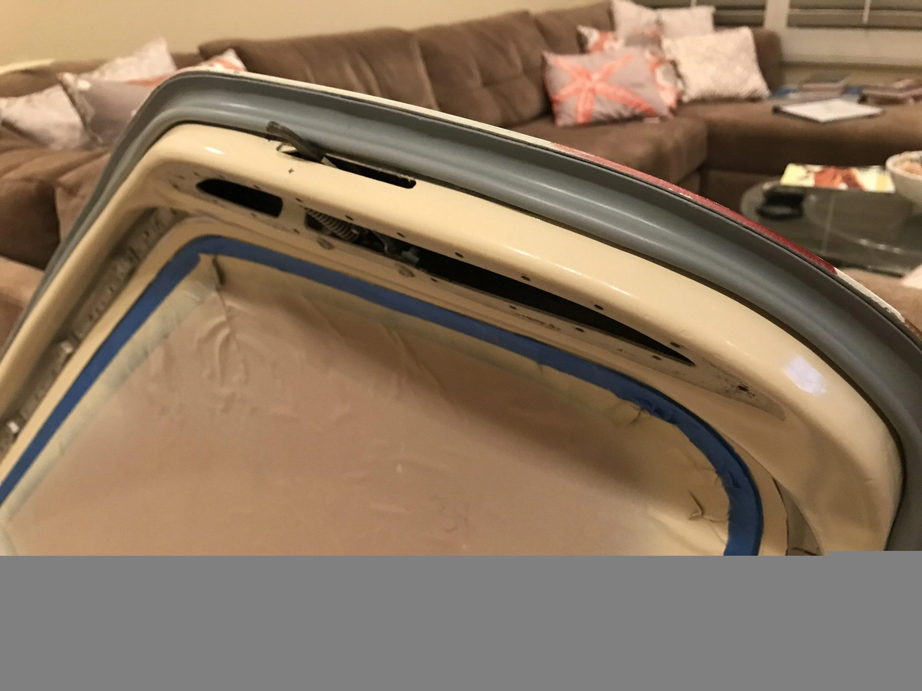

When using 3m red peel and stick adhesive tape on a body panel or seal
The adhesive promotes a high bond

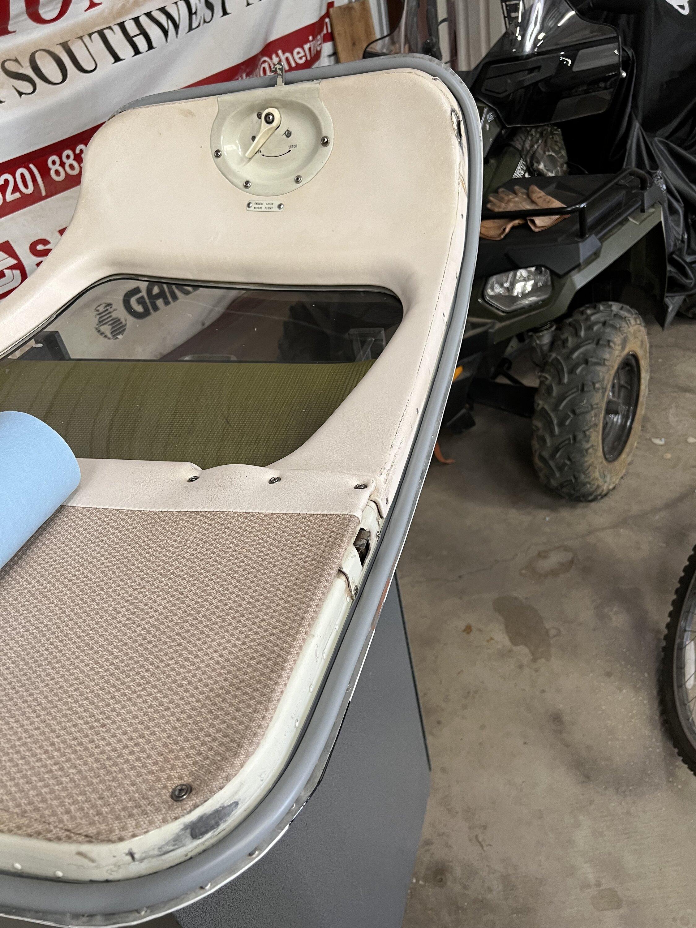

We do custom door seals in color based on the aircraft interior or outside color of application.
Grey is a industry standard to inform silicone spec
I hate black

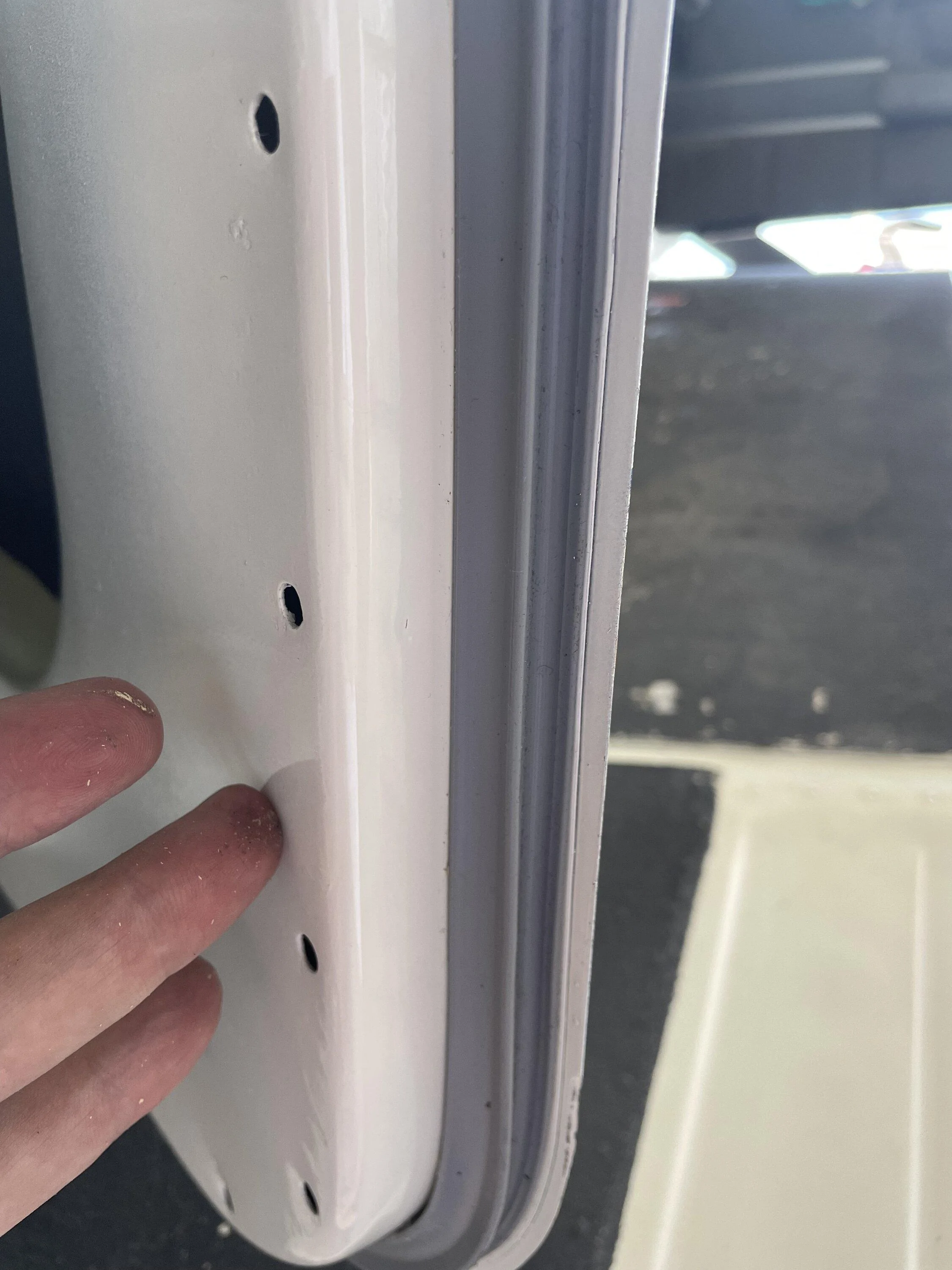

I did the same to my Ford Transit Van. The two front doors were very noisy, I took 1/4" tubular foan and stuck it under the factory gasket that had a flap that could be lifted to do this. Nothing glued, nothing seen, and it took ten min.
LL75
lance
Sep 21, 2022
45
1,759
1,282
Dallas
No, this one is different from what OP does.
Both should work.
I feel the OP's way is easier.
Thanks . I think Op added the round tube with this technique.

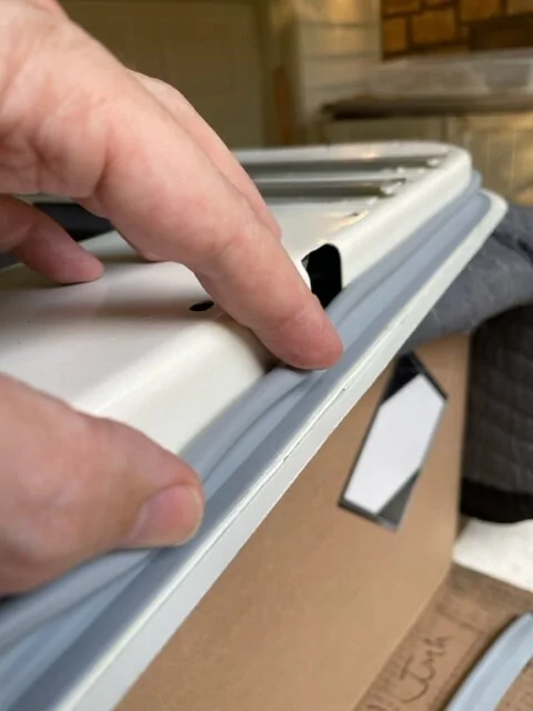

I just bought these silicone door seal strips for the doors. They're silicone instead of EPDM rubber, are more durable, and a bit taller to better seal the area in the doors.
