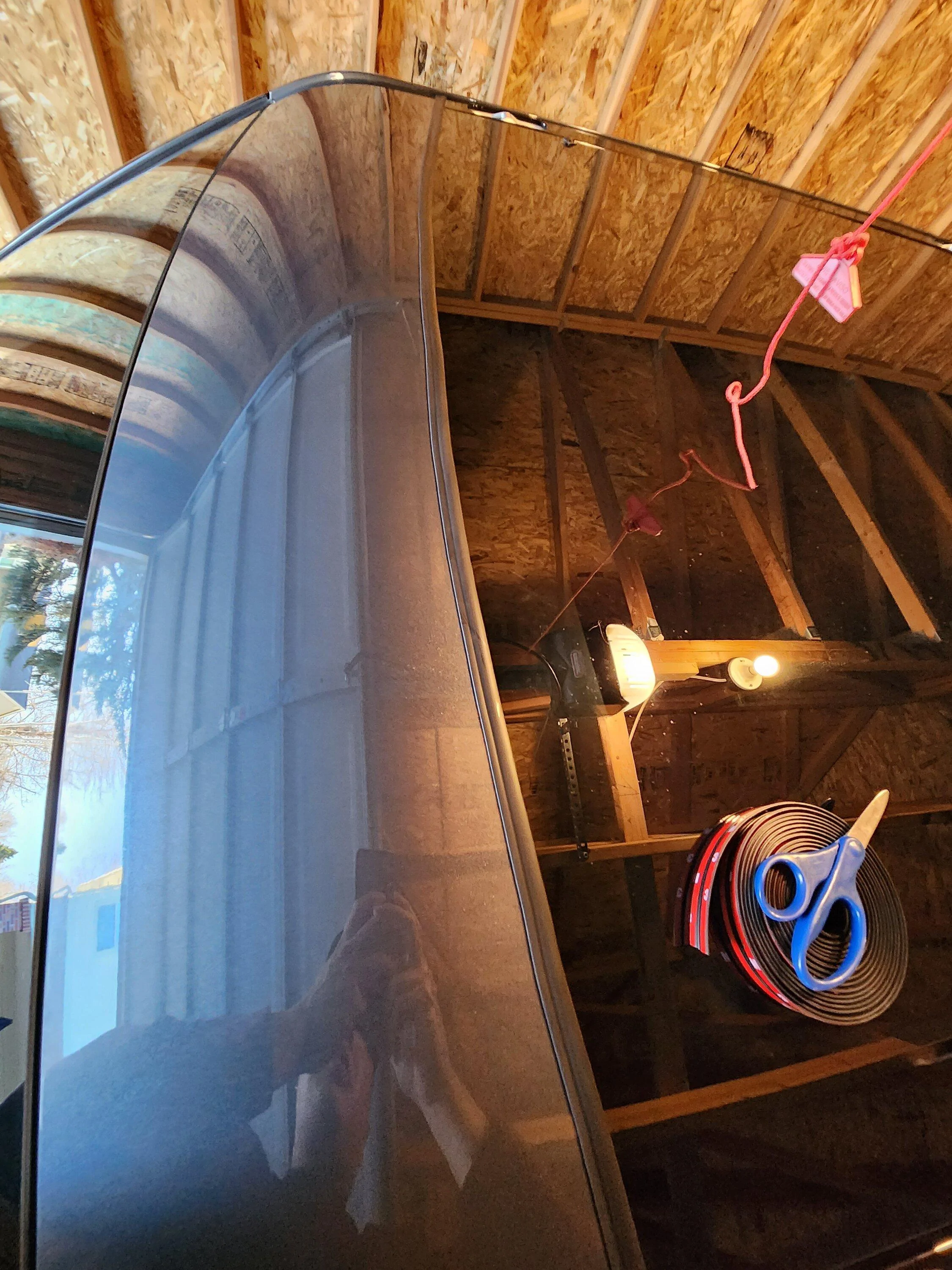

Haven't tested anything yet, but I installed a few rubber gaskets on panel gaps
the top of the roof on the front side
Inside the drivers door
Inside drivers window
On side of windshield on a pillar
I did not do anything around windshield. Didn't look like that was an issue for me. But will do that next
My wind issues are:
Sounds like window is slightly open
Wind noise on rood
I'll report back with findings

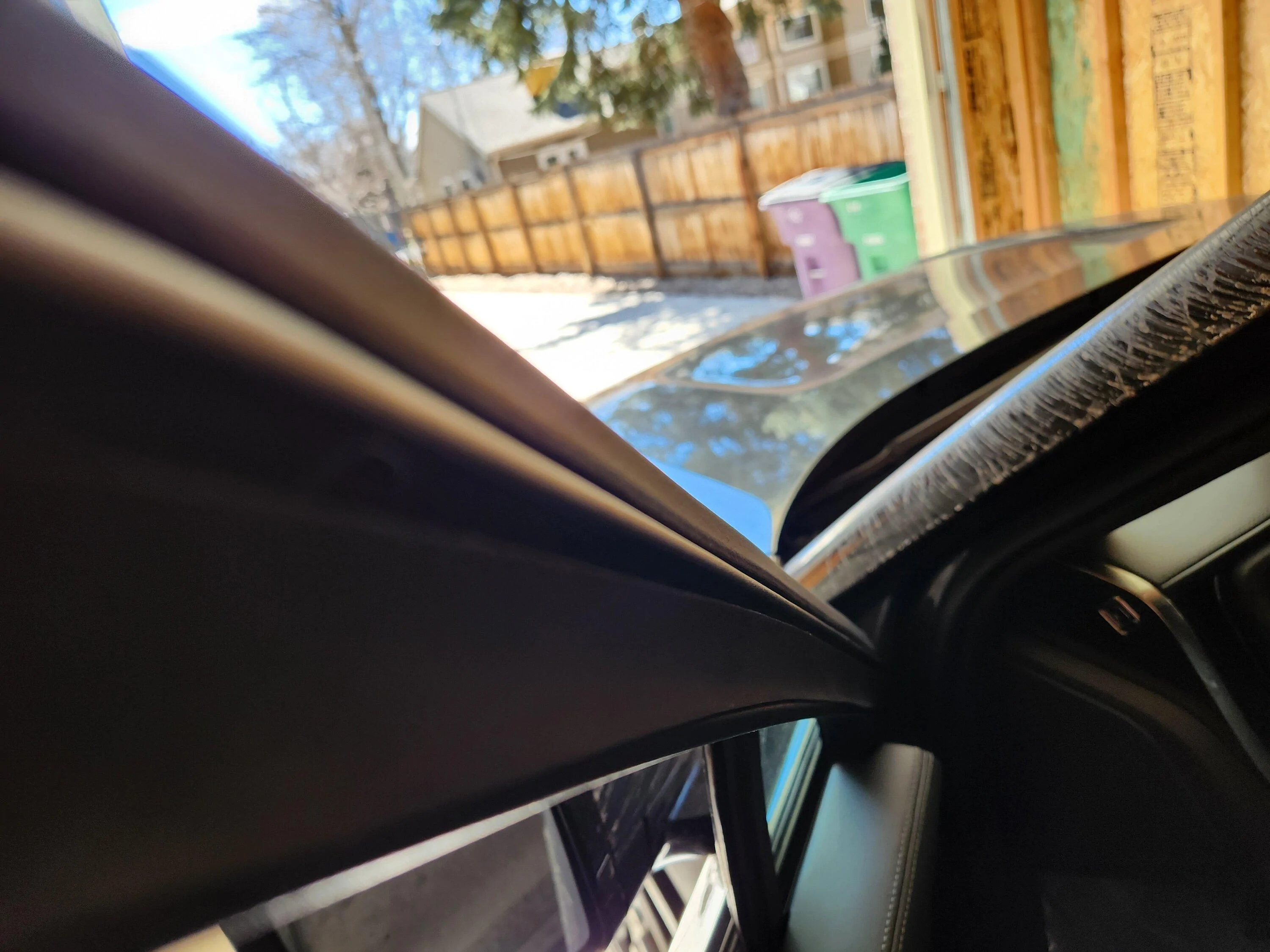

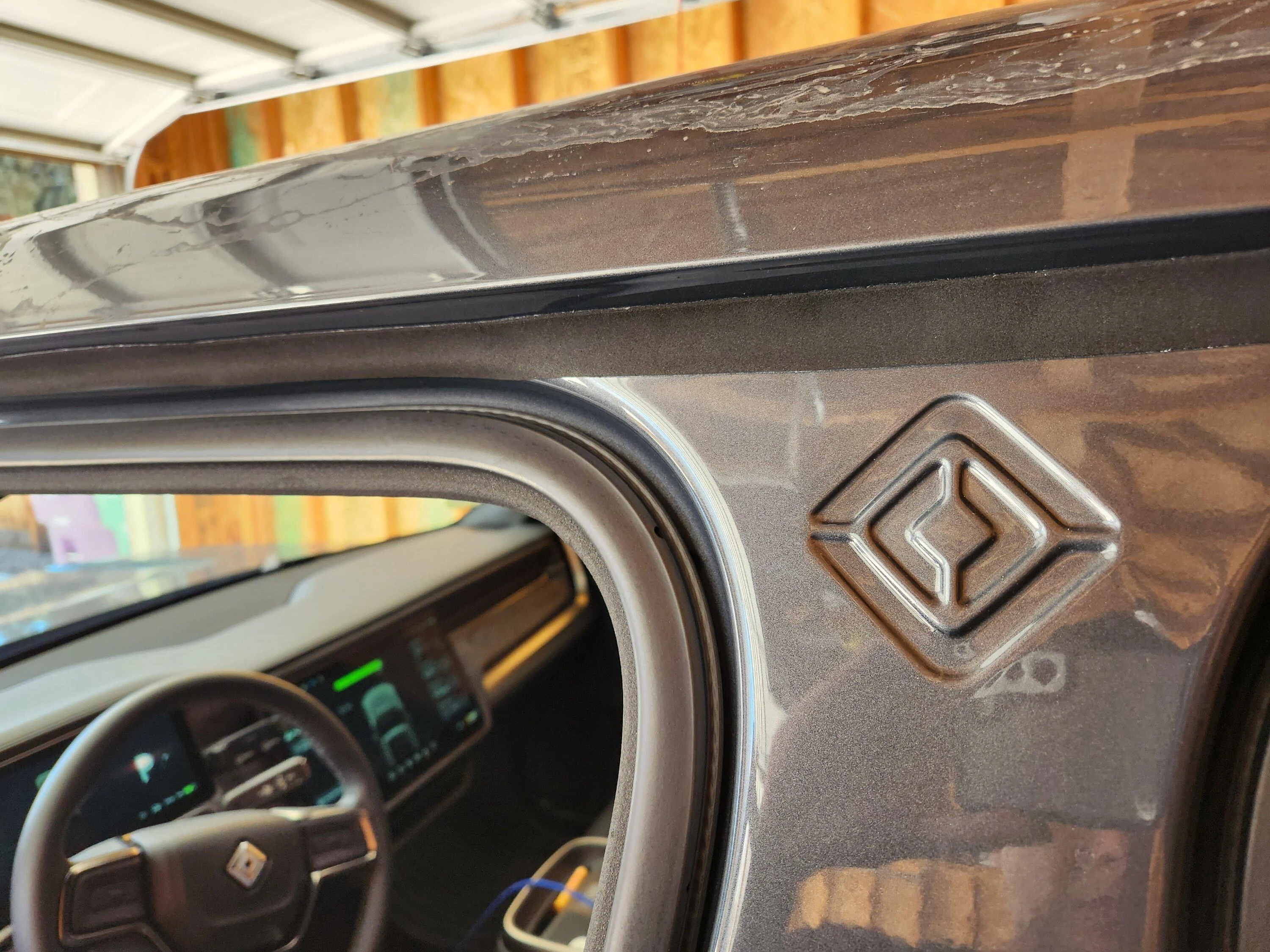

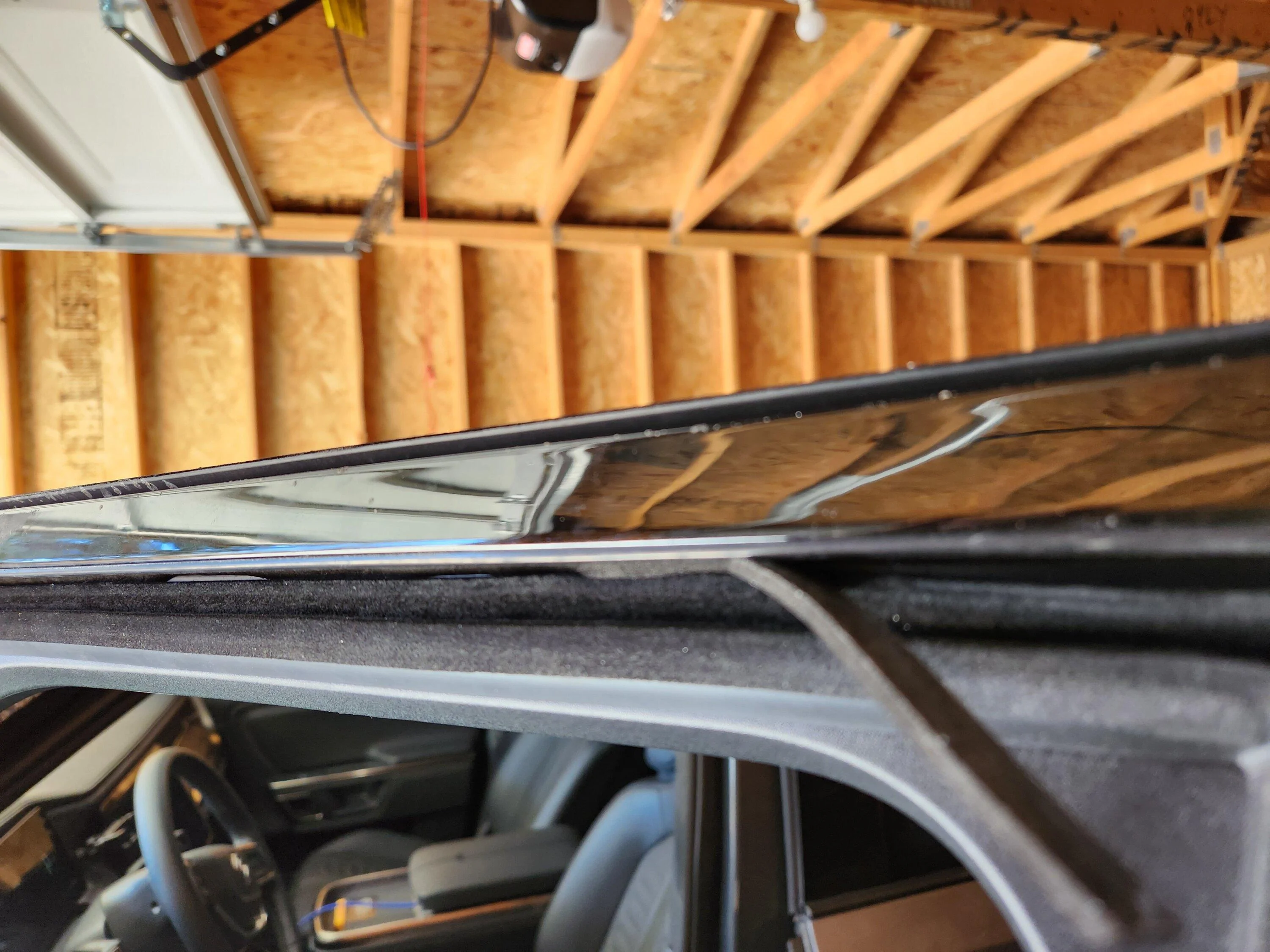

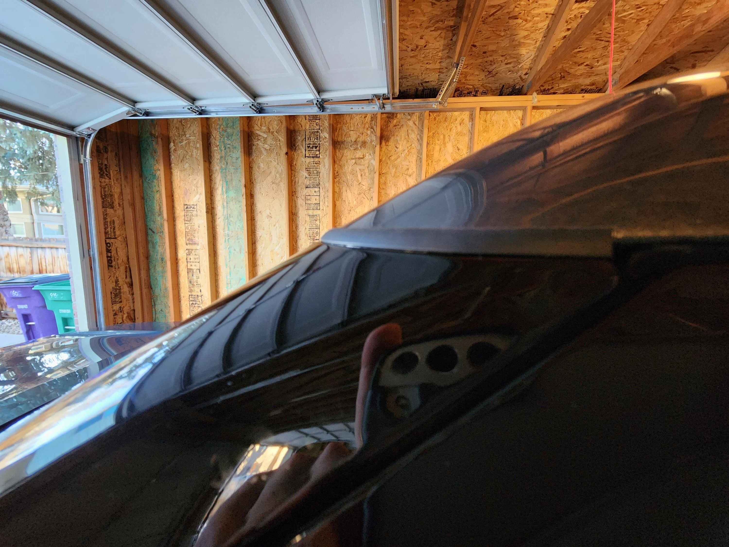

I put duct tape over the front of the glass on top and over the triangle piece on passenger side and it pretty much eliminated all wind noise except for wind there are large crosswind gusts--which we have been having a lot lately in atlanta area.
I've had them look at the wind noise issue 3 times now and they have never fixed it. So i tried the duct tape myself and it's now dead obvious where the noise is coming from on mine: passenger triangle glass piece and the front part of the glass roof on the passenger side is above the painted part that is between the top glass and the windshield. vin in the 3000s

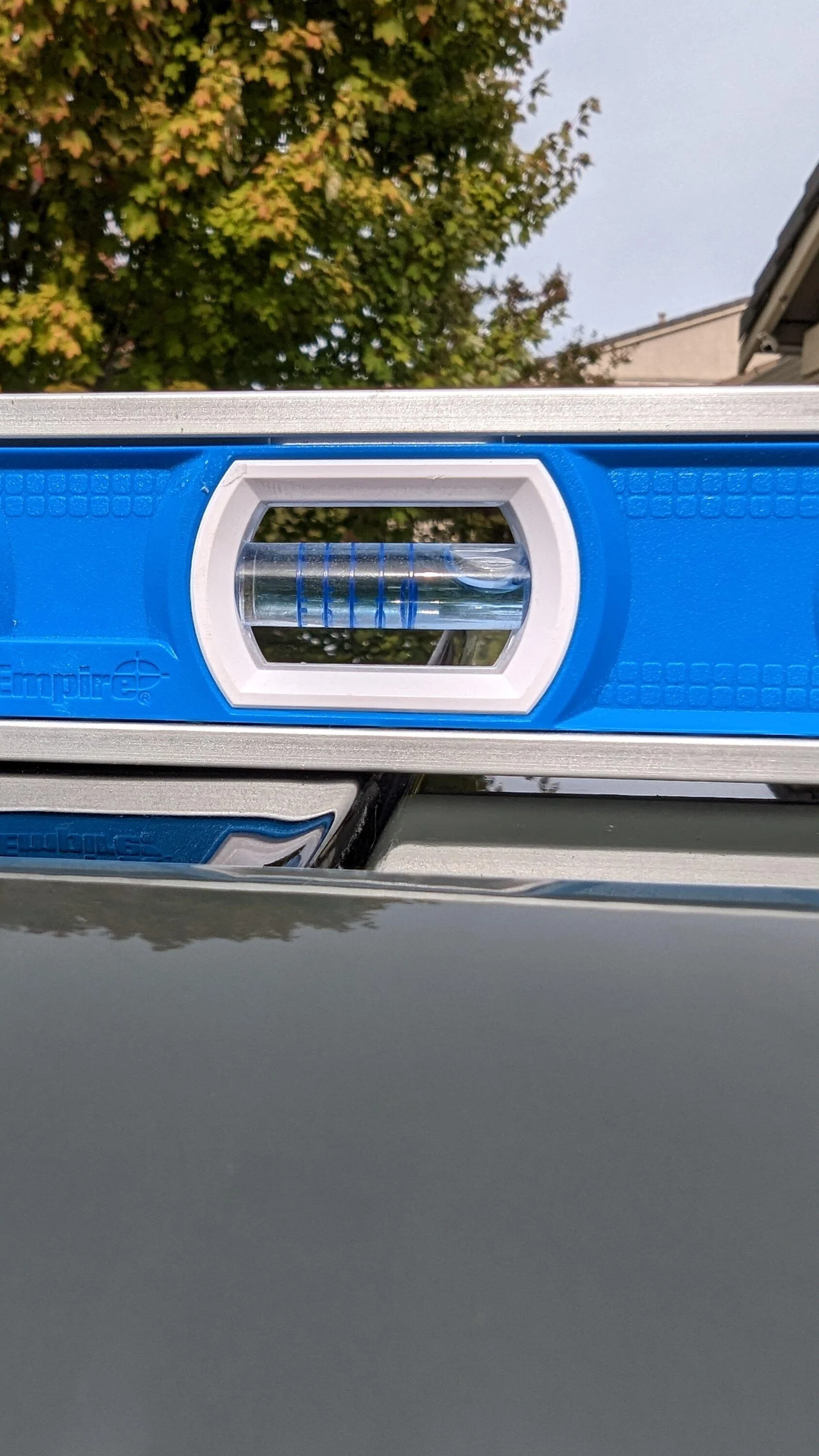

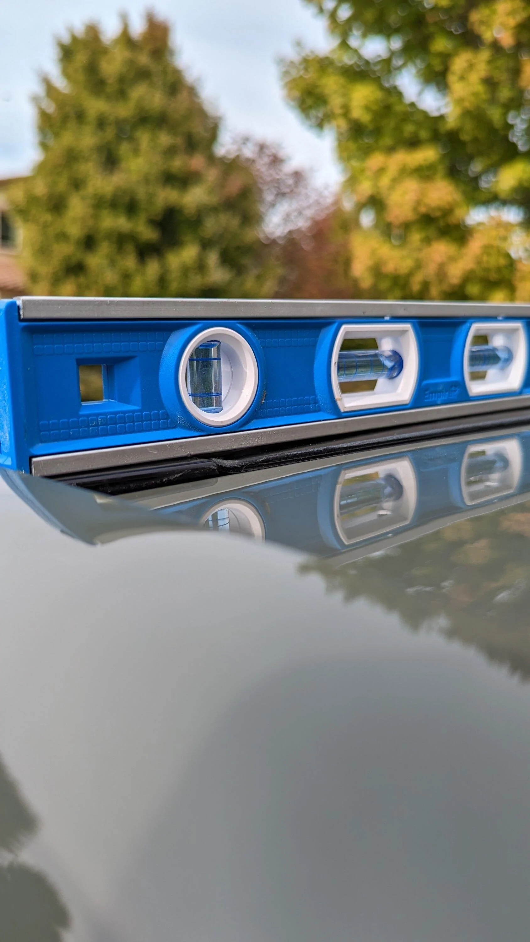

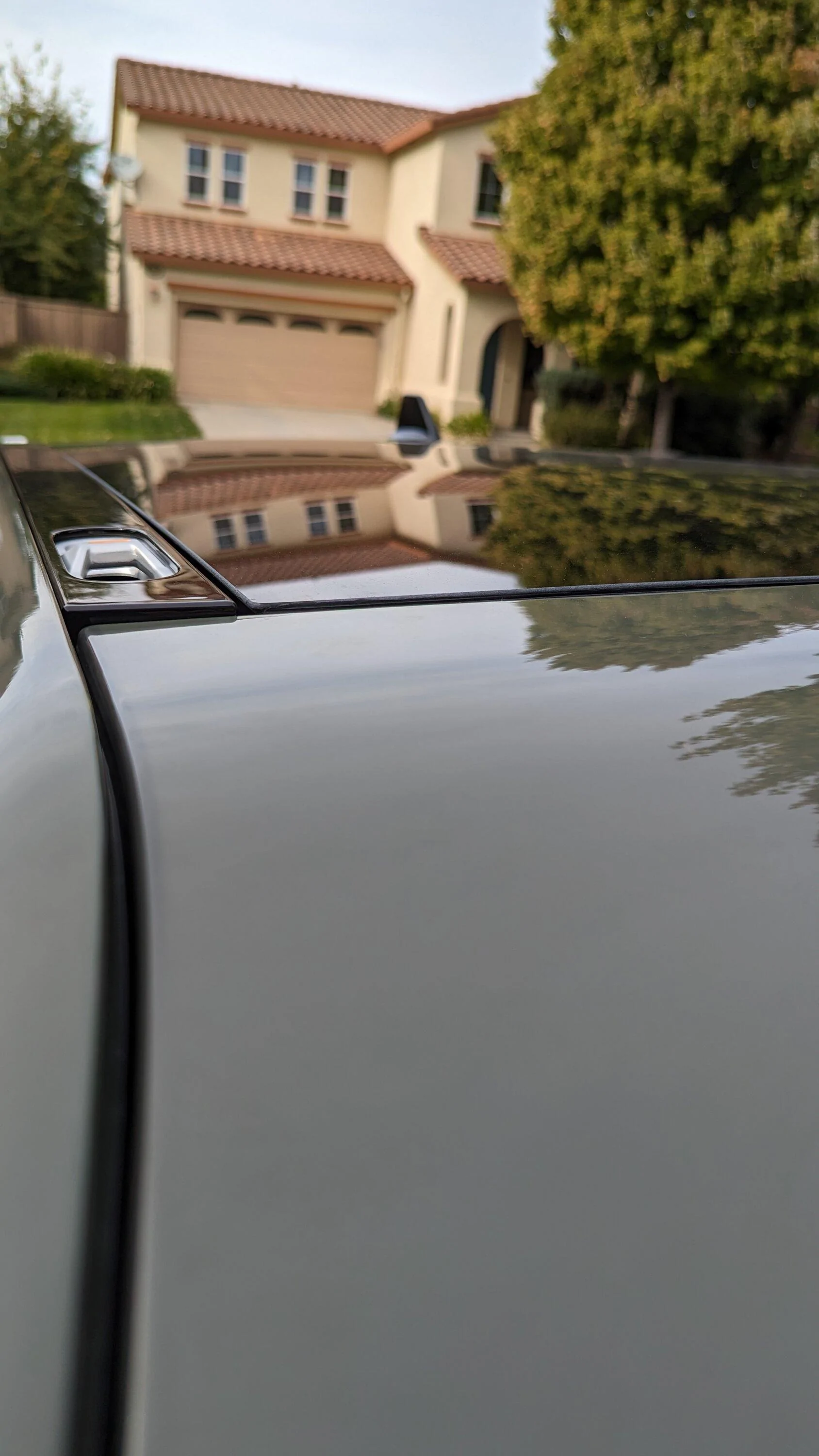

can you show a picture of the glass roof being higher than the painted part?
Gdorff
Gordon
Aug 17, 2021
116
Roseville, California
2018 Audi RS5
Business owner / CIO

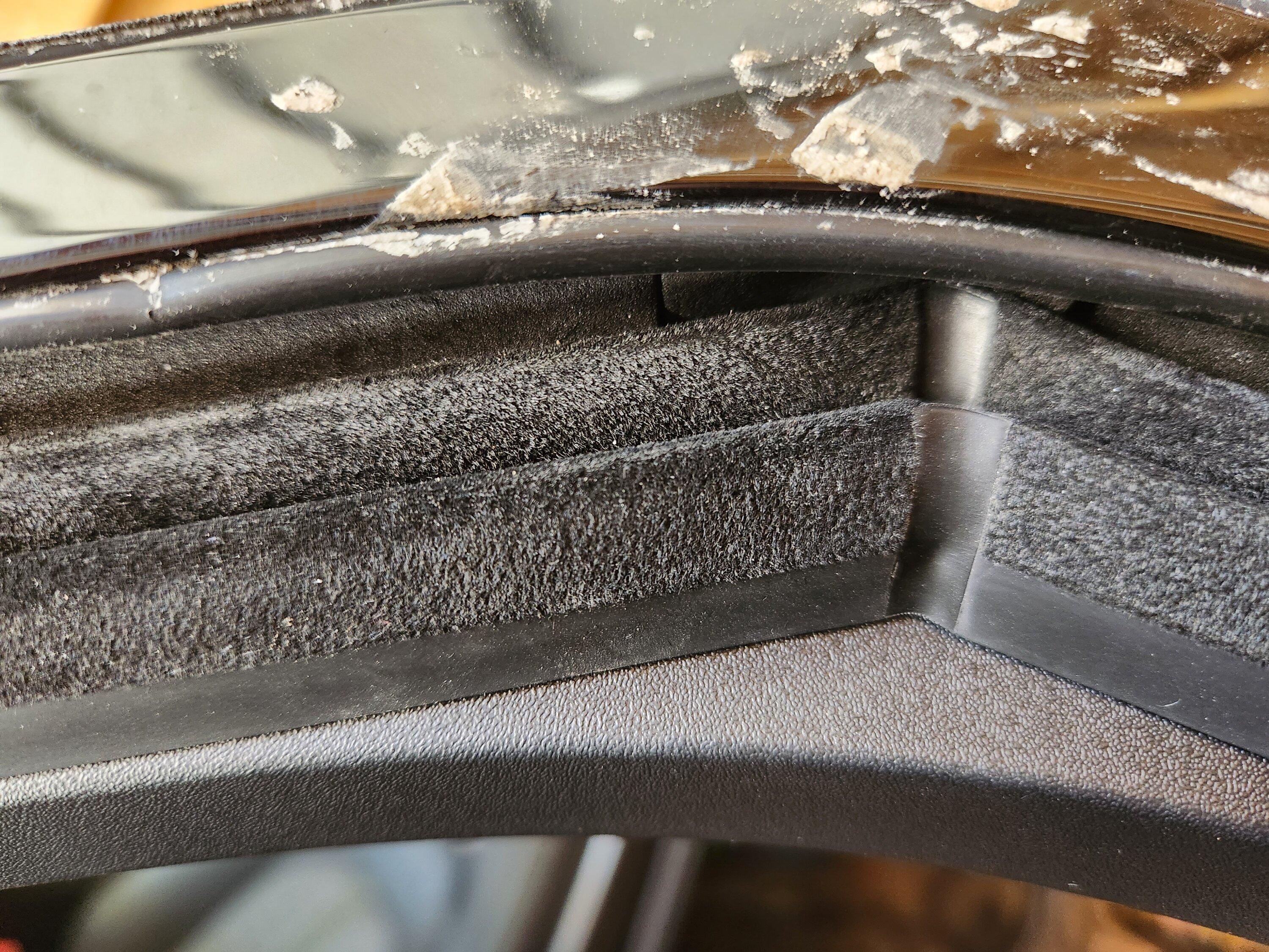

I've attached a few photos from my truck before they replaced the top facial piece. The passenger side top piece sat below the roof glass.
Hope this helps clarify
