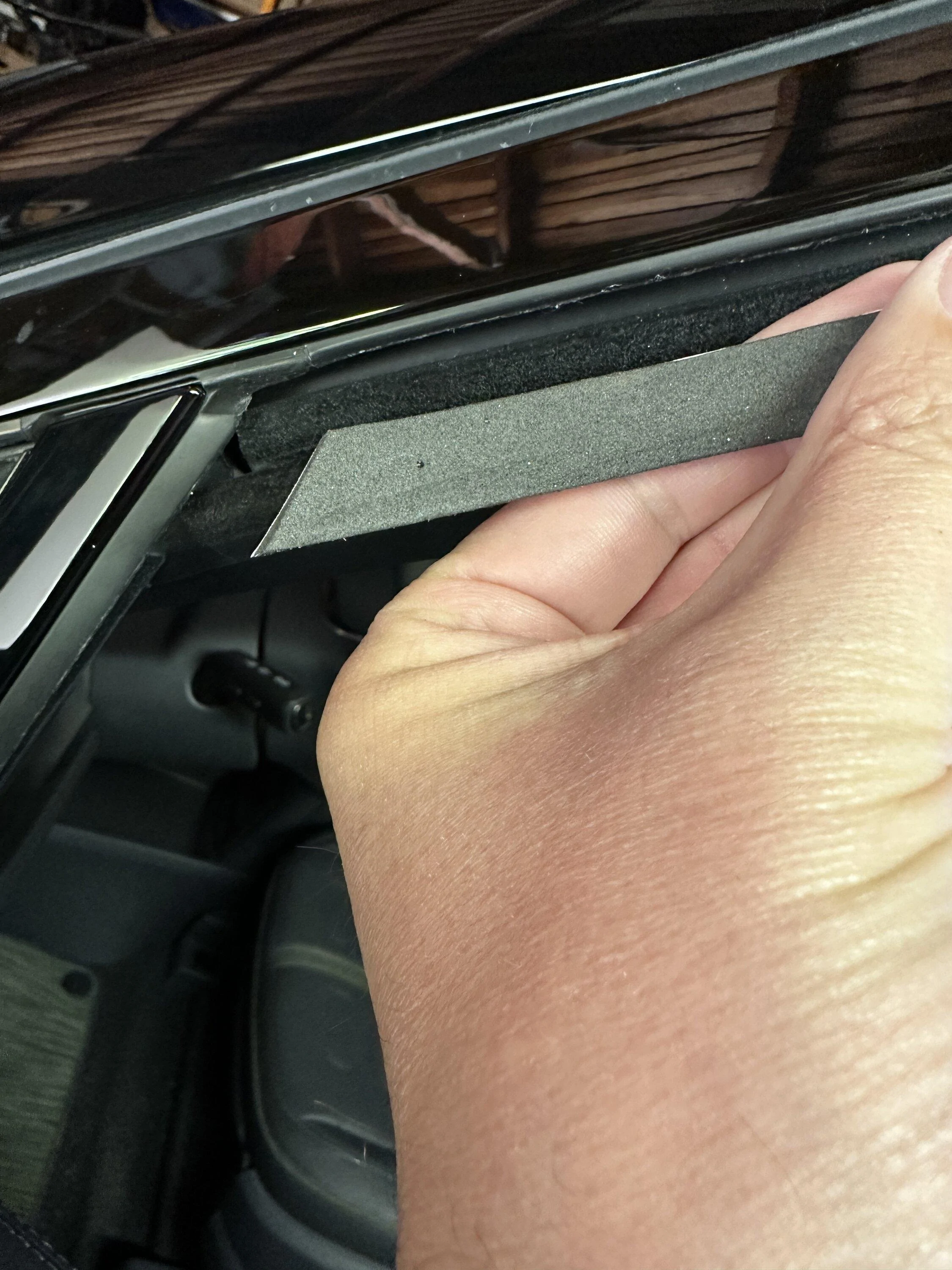

In my case, I think the window seals are the culprit. At least these need to be addressed before I chase other issues.
Where exactly do you apply the 1/2" material in the window frame? It looks like the idea is to cause the window to fit tighter against the existing seal, which would mean the 1/2" material is pushing the window out when fully closed. Or, are we adding material to the existing seal to cause the window to push in when fully closed?

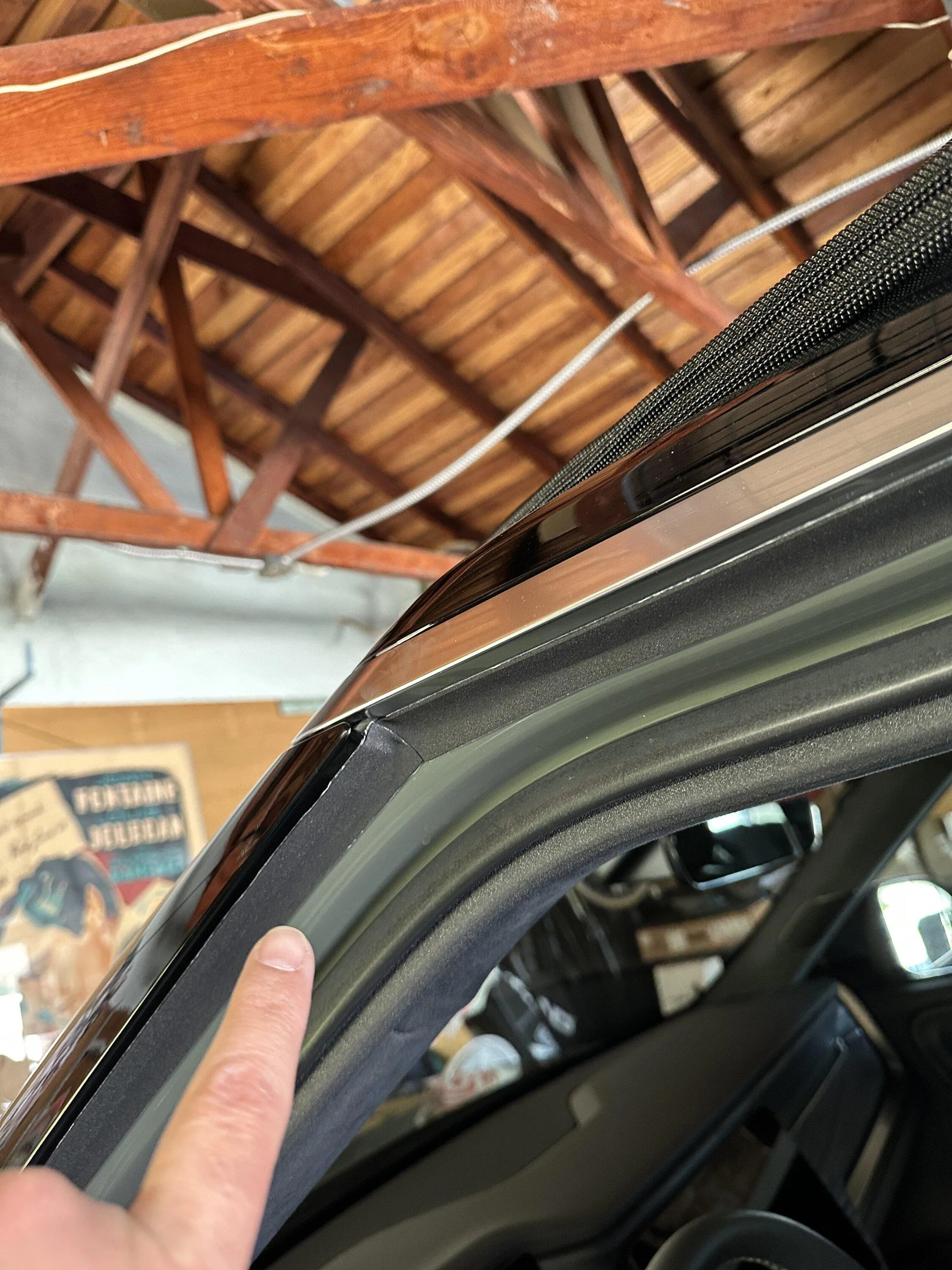

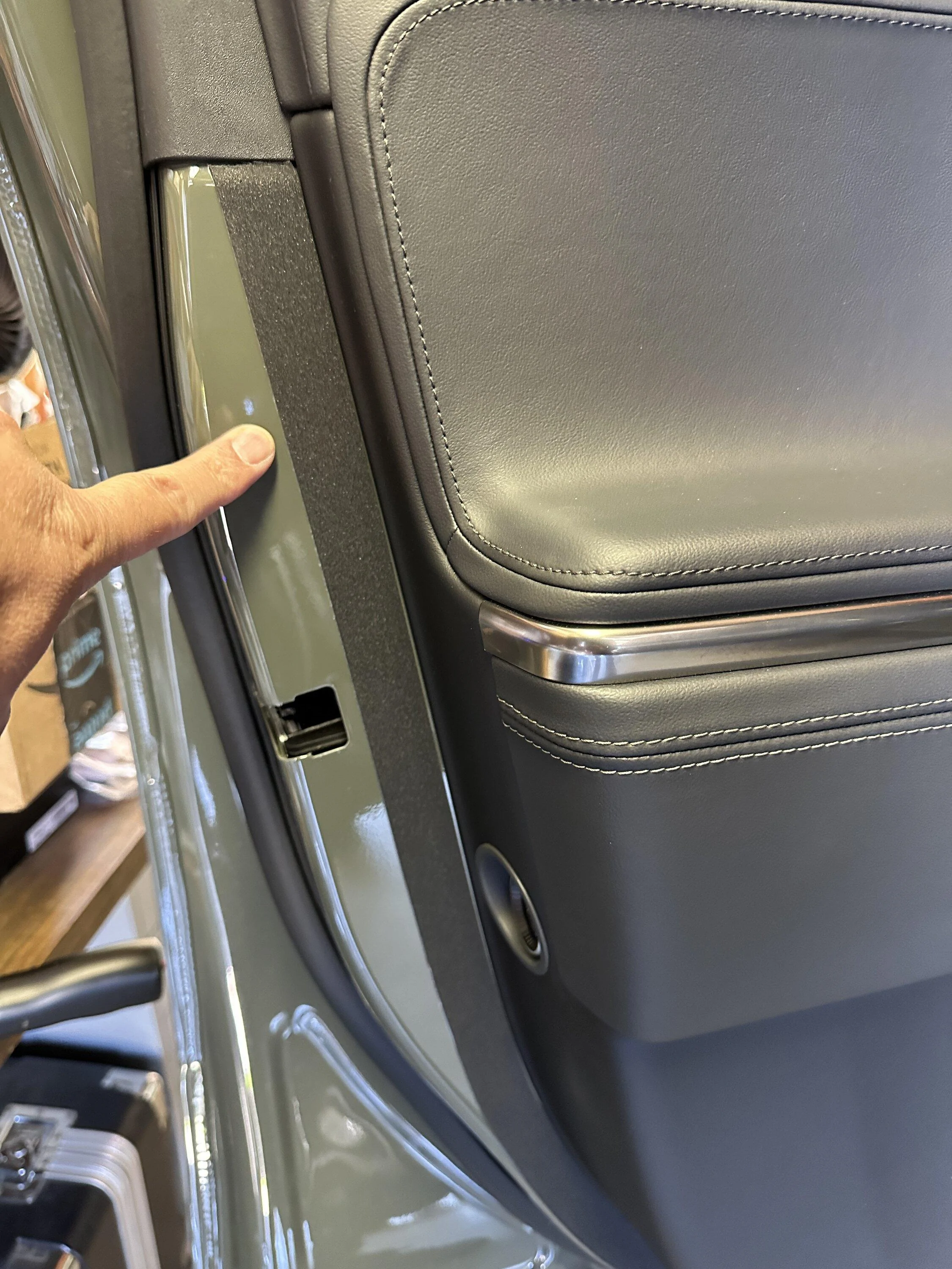

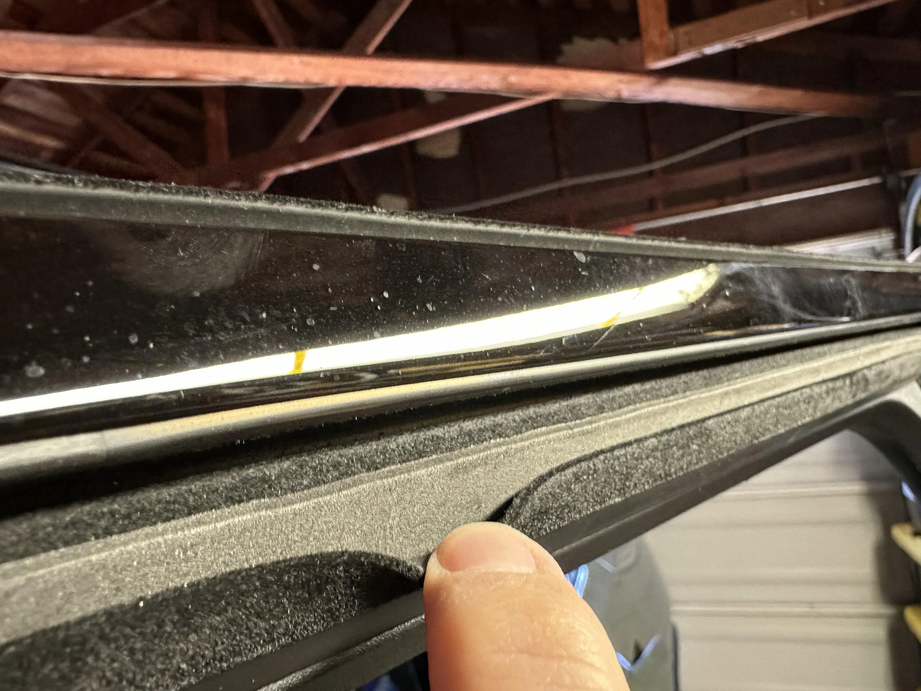

I don’t know if this is right or not. I watched the video a bunch and took screenshots but could not tell. So I did the pictures below. I’ve not had a change to drive any distance so I can’t tell if it makes much difference.

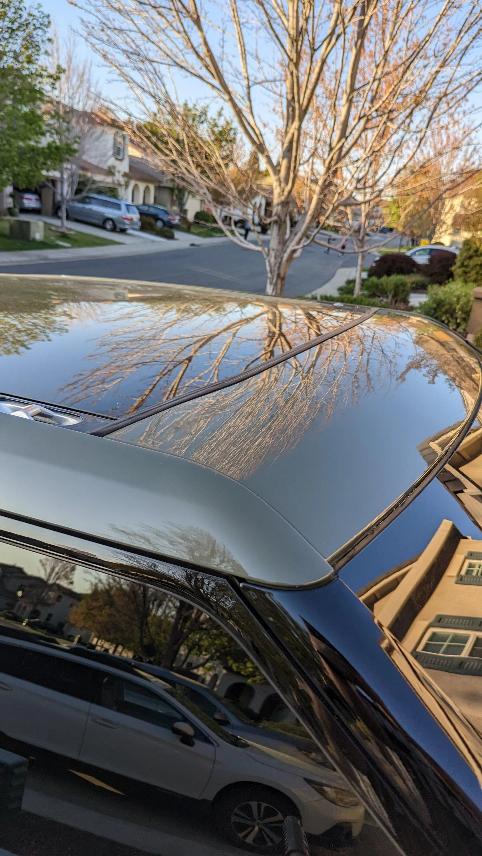

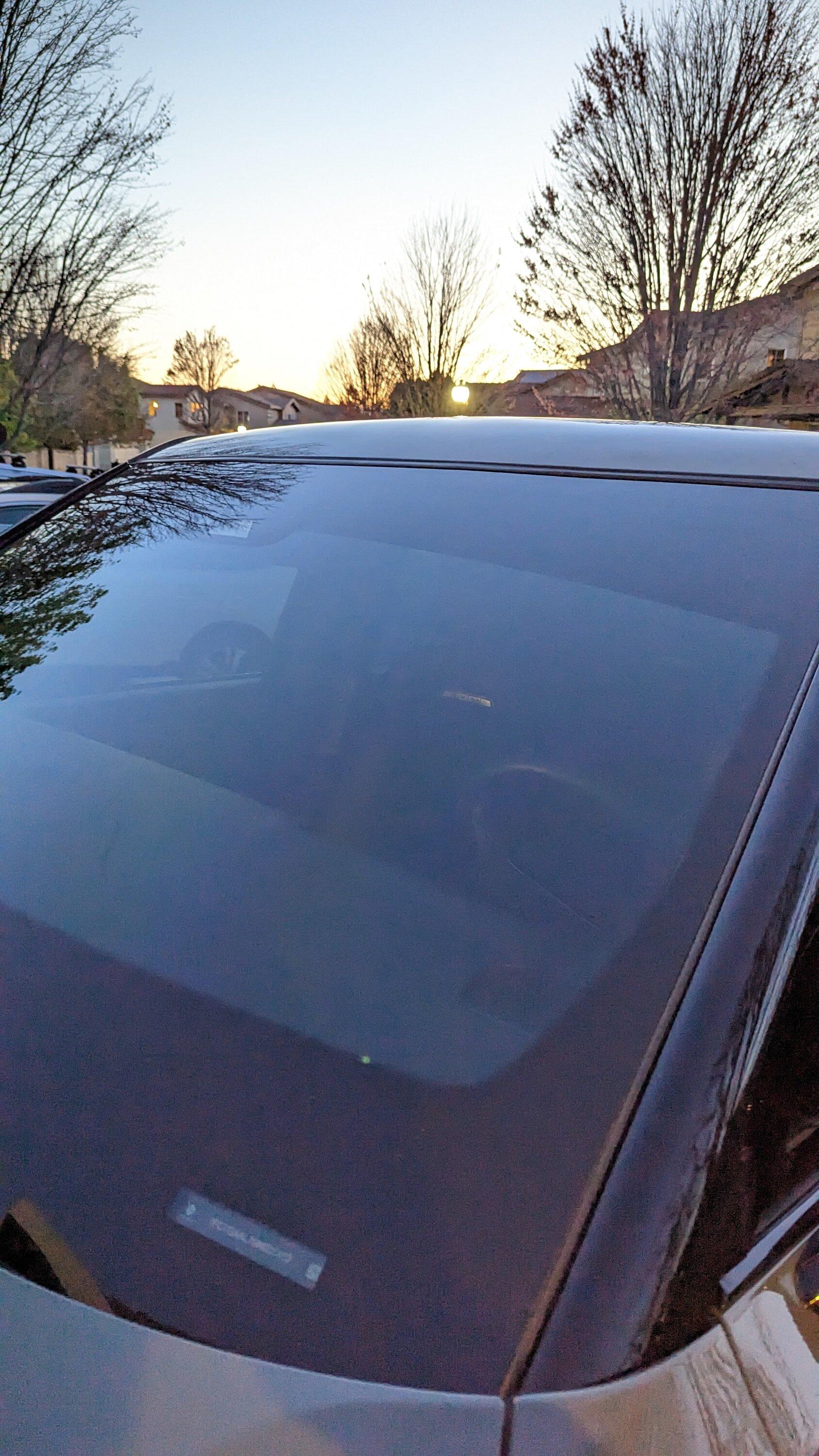

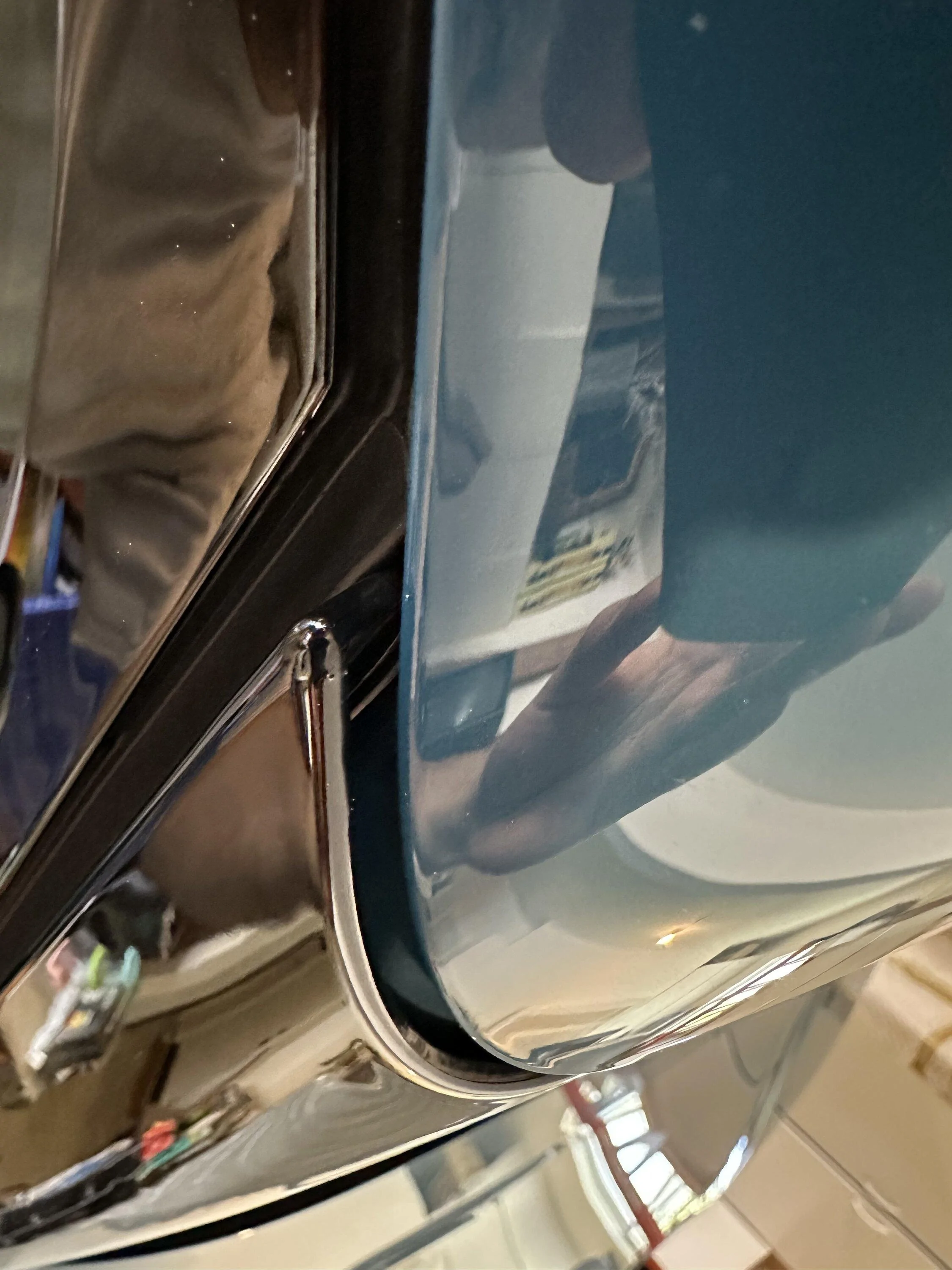

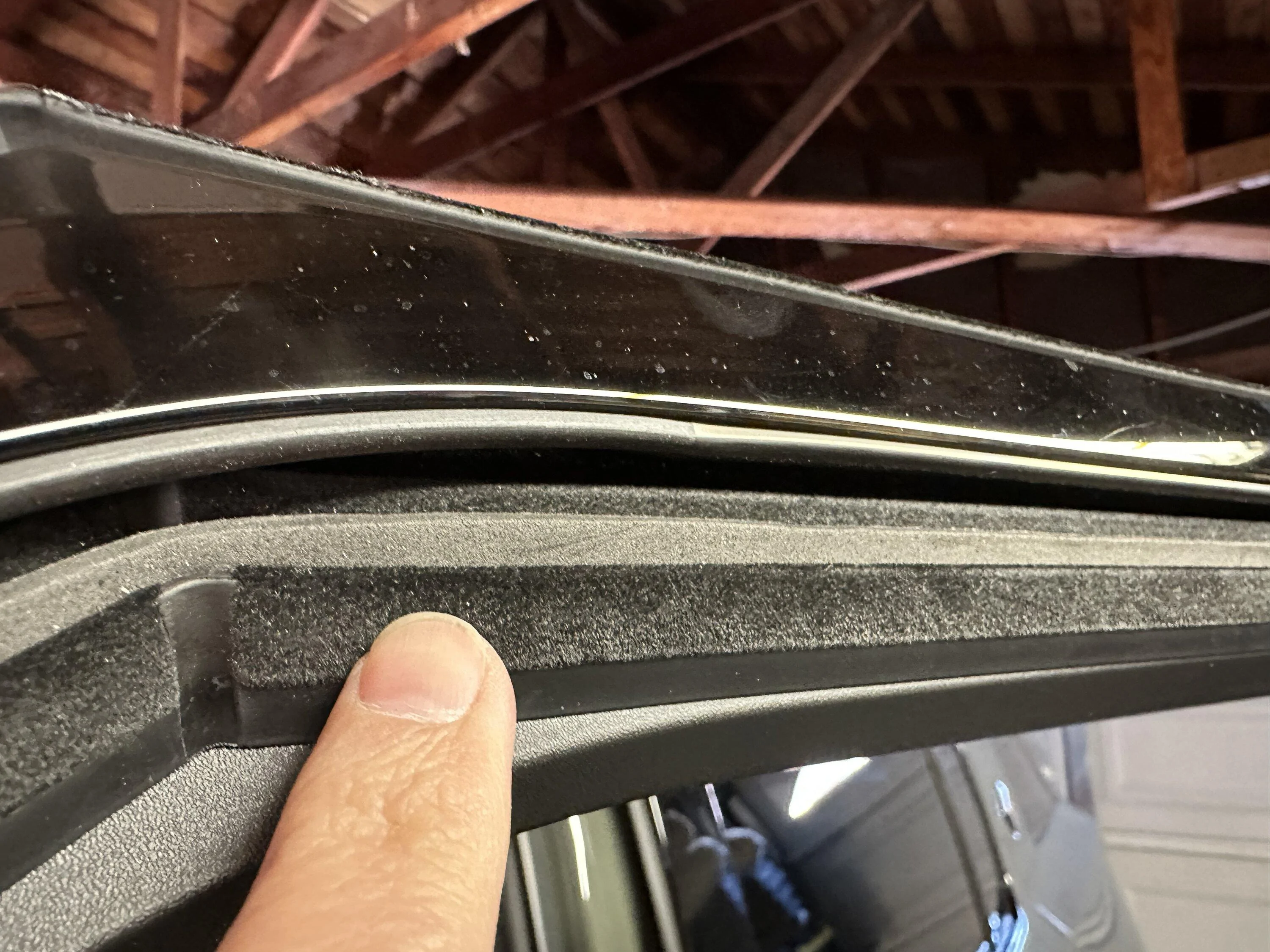

Well I can say after battling my wind noise issues I have located two points that have been a problem for me. (roof and possibly the windshield) any wind or driving above 45mph caused a lot of noise from the top of the truck.
I installed a piece of weather strip across the roof/roof glass and a piece on the windshield/roof facial and wow it was a huge change. (note I already had the triangle glass replaced.)
I ended up using the 19mm of this kit
32.8Ft Car Sunroof Seal T Shape Car Windshield Weather Stripping Self Adhesive Windshield Rubber Seal for Automotive Truck Roof Sunroof Front Rear Windshield (14mm+19mm) https://a.co/d/8aBgOPO
If this stuff doesn't stick for the long haul I'll probably find a more permanent solution.
