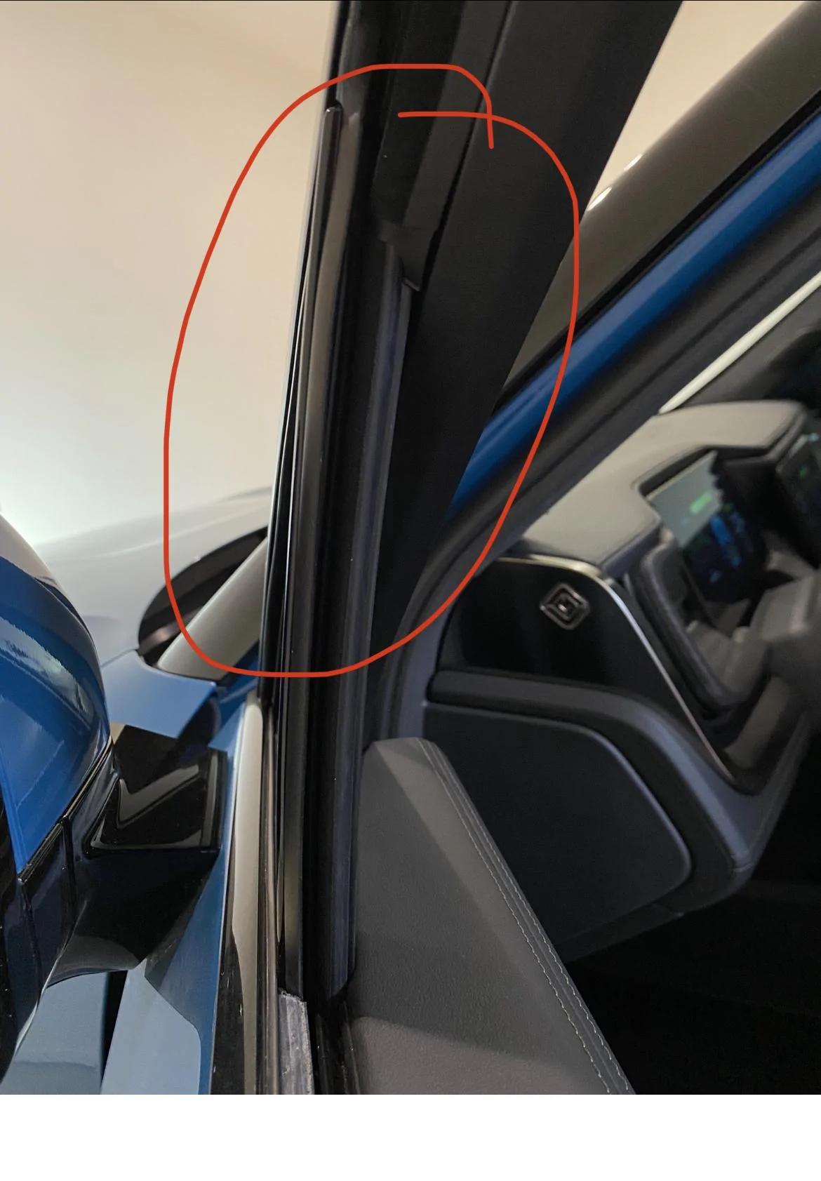

I just had the roof applique changed out recently and it did not fix my wind noise issue. I actually feel like it got worse :crying: Can you send a picture of exactly where you think the issue is with the A pillar or triangle window trim? I want to look into it on mine to see if that's possibly the issue I need corrected.

Some of my wind noise is from this vertical piece where triangle window meets drivers side window. The shiny black trim piece doesn’t push the weatherstripping tightly against the window. I’ve taped it off with black electrical tape and it lowers the noise. These vehicles have some wind noise even with all seals done properly especially crosswinds. It will not be eliminated entirely. People who say they have “no wind noise” still have buffeting wind noise etc noise around the front or just aren’t that bothered by it.
Interesting. So you used electrical tape to try to push it down a little bit more for a better seal? I'll give it a go and see if I get any significant noise reductions. While they were changing out the roof applique, I had an R1T loaner and the wind noise in that was waybetter than my personal. So I'm using that as a comparison point.

well, i taped up all around that vertical piece...to fix without tape, yes, it needs to clamp with the inner piece more tightly...my trucks at the SC and this is on the list...the other thing the tech noted during our driver was wind noise coming in around the door...so i think they will adjust the door weather stripping in the door jam to meet more tightly with the door.
