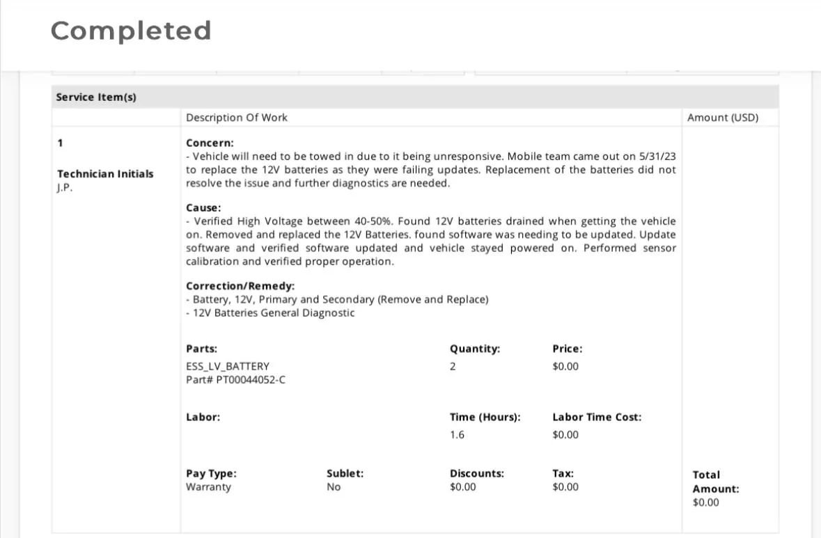

Rivian R1T R1S 12V Battery Replacement Bricked My R1T IMG_4681
Week and a half later, this is what fixed my truck. I asked the mobile tech at the time if he could just try replacing with another set of 12V batteries but he said it wouldn’t work. Wish we didn’t have to get it towed in to confirm that was the issue.
5,830
10,263
2022 Rivian R1T LE
The dead batteries were just the symptom. The software update was the actual issue, and did need to be done at the SC.
