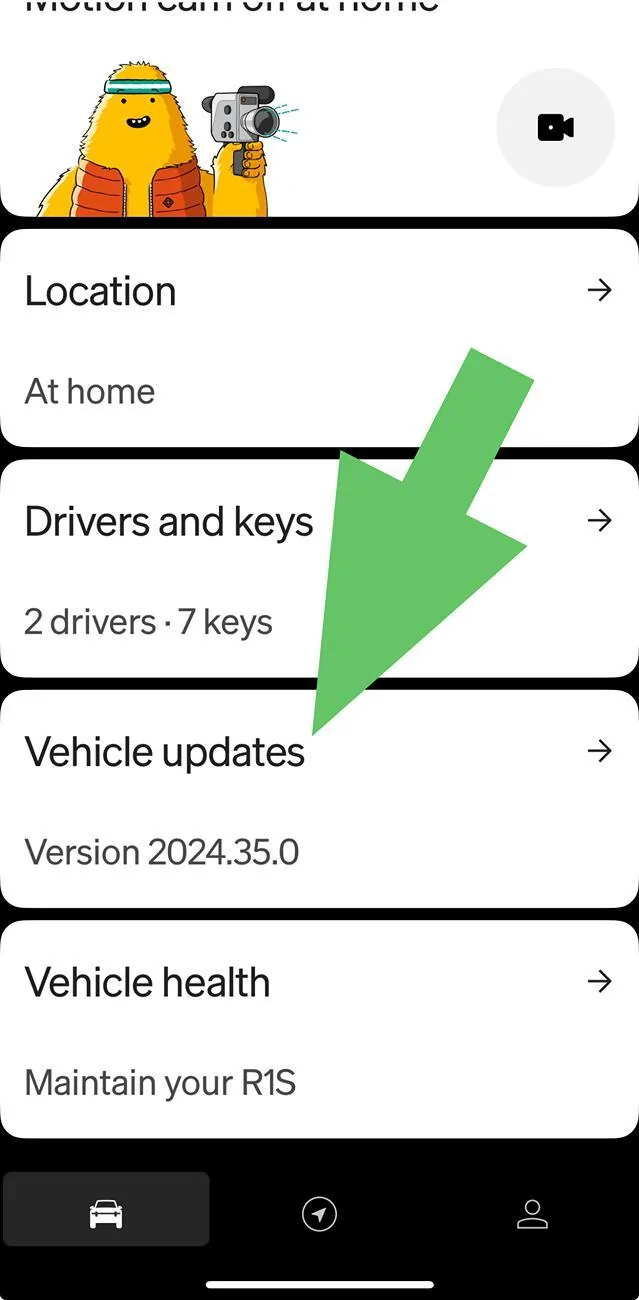

Got the notification for the available update last night but accidentally cleared it on my phone. Doesn’t show up as available anywhere in the app now. That happen to anyone else ever? Any way to make it show back up?
From the main page of the Rivian app, scroll until you see Vehicle Updates and tap it.
Rivian R1T R1S 2024.35.0 Update Installing (Includes Live Camera View - Gear Guard Live) 1727566324012-ba
You should be able to start the update from there.
Yeah I thought so too, but it wasn’t showing up there.
Turns out the notification was for a family member’s rivian. I have key access to theirs through the app and forgot about that. My update came in a day later.

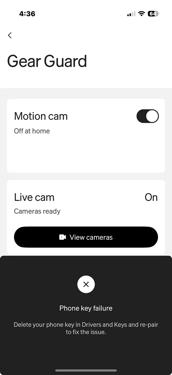

Installed a few days ago and so far no major issues. One new behavior is that camp courtesy times out after a couple hours.

Update installed. Live camera worked once after taking a lifetime to load. Now it just keeps saying connection failed ¯\_(ツ)_/¯
I had same problem. After performing an infotainment reset, manually turning the LiveCam feature on in the vehicle, and restarting my phone app, it has worked as intended. Hopefully, this sequence isn’t required often…good luck!
