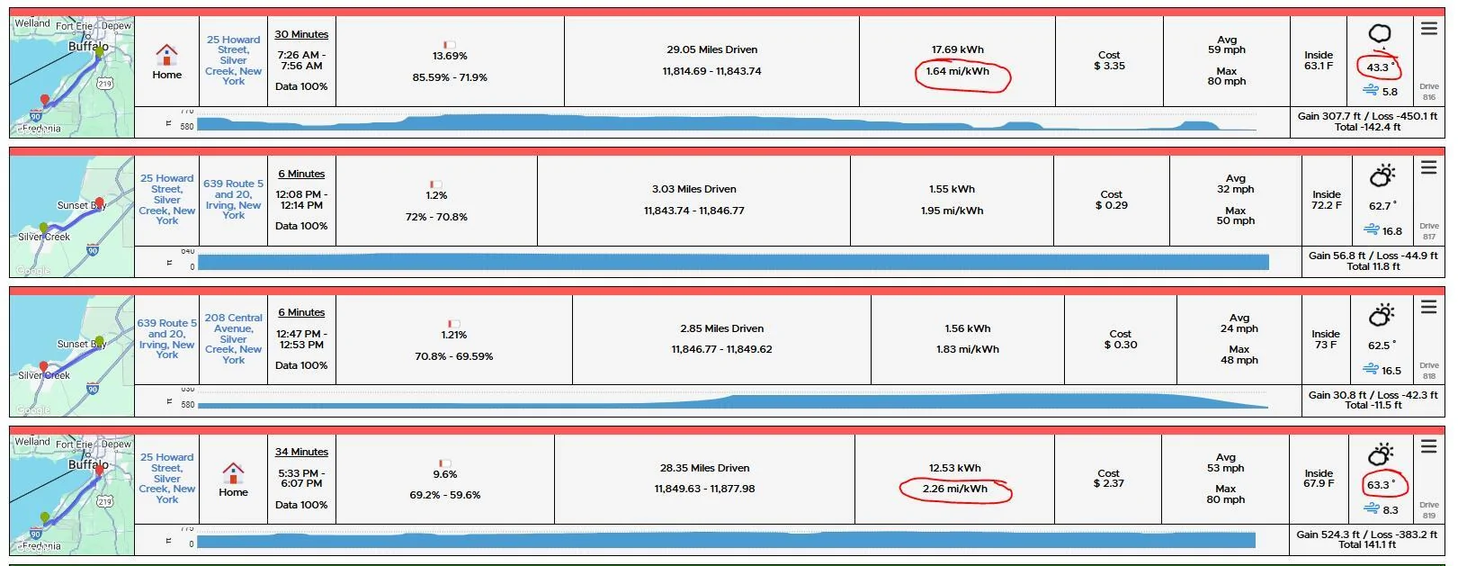

This feels really weather related. Have a look at this data from yesterdays commute on my truck. 37.8% efficiency increase from my morning drive in to my afternoon drive home. Nearly the same deltaT you had 43degF in the AM, 63degF in the PM. Sure feels like a temperature related change from here.

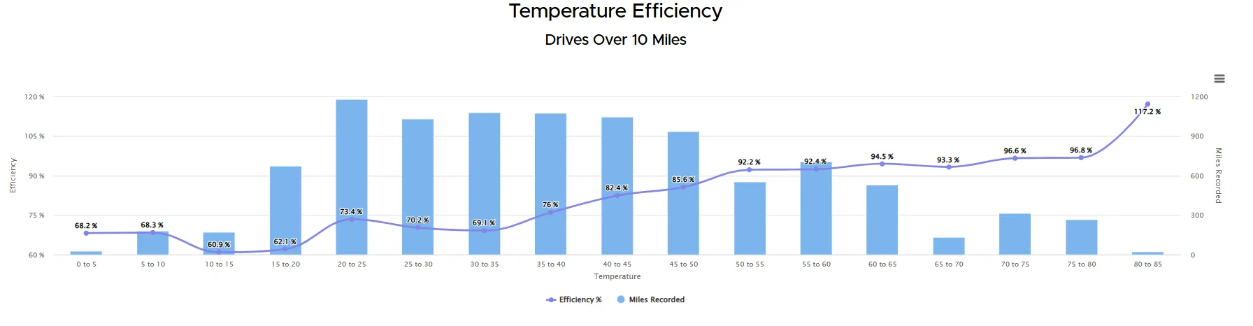

Here's what my truck shows from data collected on ElectraFi regarding temperature vs efficiency. Right at a 10% swing in measured efficiency difference when comparing the 45deg to the 61deg segments. Not nearly as dramatic as our recent commute data would support.

I would have to go back and dig through a ton of data, but I'm wondering if that 50degF range is the "tipping point" to drop us in to lower efficiency numbers. That is to say the 20deg swing from 40 to 60 is of greater importance than the 20 deg swing from 60 to 80, or from 10-30?!?!

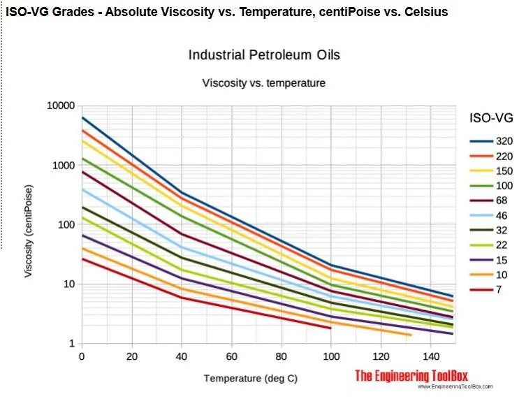

Just a thought on motor temp observation above. I know my dual motor truck has oil bathed motors (not sure about your quad), and that would support the above theory. Viscosity isn't linear with temperature, and it thins much quicker in the "lower temps" than it does at higher temps. Pulled the below chart from Engineering Toolbox that corroborates that thought.
