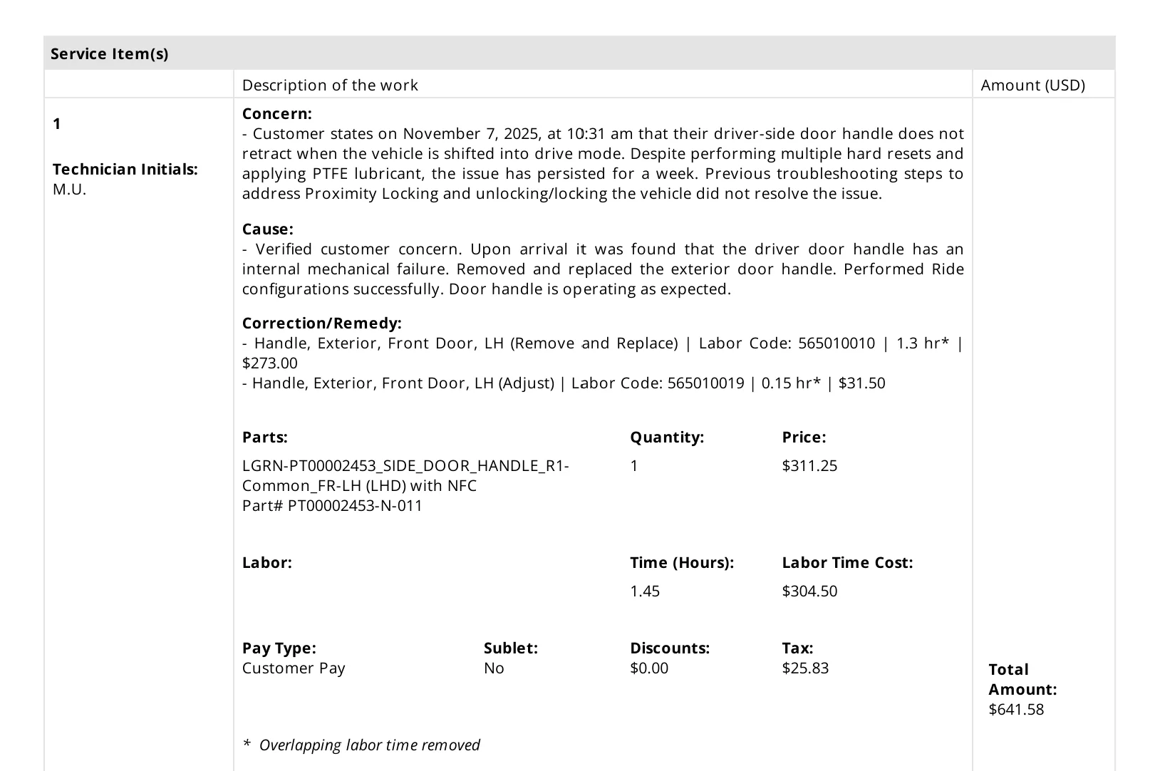

My driver’s door handle stopped retracting properly. It was stuck open about 90% of the time, and no amount of lubrication or resets fixed it. Since this isn’t a high-dollar component, I treated it as a low-risk test of how smoothly XCare handles a real Rivian claim with my $100 deductible.
Rivian Mobile Service came out and replaced it. Total cost: $641.58, yes, for a door handle. Another reminder that out-of-warranty life with an EV can get expensive fast. After installing the new handle, they pushed a software update directly to the truck to sync the replacement. Always interesting to watch that happen live.

2. I ensured the Rivian tech documented the Cause of Failure correctly.
This step is critical. XCare requires that the Repair Notes list the Cause of Failure (as per above). I printed a laminated cheat-sheet with the exact wording they want. The tech appreciated it and entered the failure as: “Internal mechanical failure.”
3. I submitted the final invoice and proof of payment.
I sent XCare the final paid invoice with the Cause of Failure noted. They approved it in about five minutes, then requested proof of payment to Rivian (a Chase screenshot worked). Once submitted, they confirmed reimbursement, minus my $100 deductible, would be mailed within 14–28 days. I’ll update once the check arrives.
