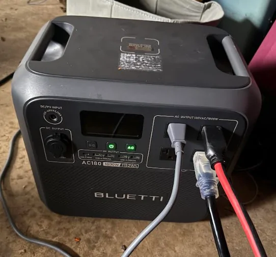

On July 4th, we had a storm with high winds (I heard 123 mph in areas) that either broke or pushed over thousands of trees in the Lancaster PA area - with up to 30,000 homes without power. While we didn't lose power once (all underground power lines and no trees older than 25 years), friends of ours just 6 miles away had multiple trees down and no power.
I grabbed my Bluetti AC180 and a bunch of extension cords and headed over to their house. They were mostly concerned with keeping their refrigerator/freezer running. It turns out the AC180 would power it for about 8 hours before being completely drained. When they learned it would be at least 3-4 days before they had power back, I added an extension cord to run to their gas hot water heater. After I added my Starlink to the mix, the AC180 would power everything for about 6 hours. I just took the Rivian over 3 times a day and in an hour the AC180 was back to 100% and would power everything for the next 6 hours or so. It got them through the 4 days until their power was restored. As the Rivian is our only car, I couldn't just leave it there, although that would have saved a bunch of trips. I just ran the plug end of an extension cord out under their garage door so I didn't have to disturb them when I came by to charge the AC180. It worked!
Rivian R1T R1S Rivian and Bluetti AC180 Portable Power Station Keep Appliances On For 4 Days During Storm Power Outage 1783693731535-er

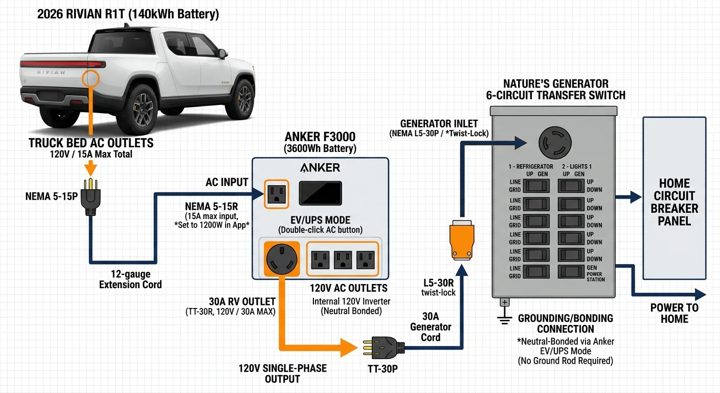

We had a Kia EV6 with V2L capabilities previously connected directly to our home’s electrical panel via a Nature’s Generator transfer switch.
After getting rid of the Kia and losing V2L I picked up an electric generator (Anker F3000).
Now, after buying the R1T last week I’m planning to chain it to the Anker. I think this should work pretty well until Rivian provides V2L/V2H.
One caveat is that you have to lower the power input on the F3000 to 1200 watts to play nicely with the Rivian. But the only goal here is to keep the generator full of power so that should be fine.
Gemini created a diagram of how this setup works in case anyone is interested.
Rivian R1T R1S Rivian and Bluetti AC180 Portable Power Station Keep Appliances On For 4 Days During Storm Power Outage IMG_0849
