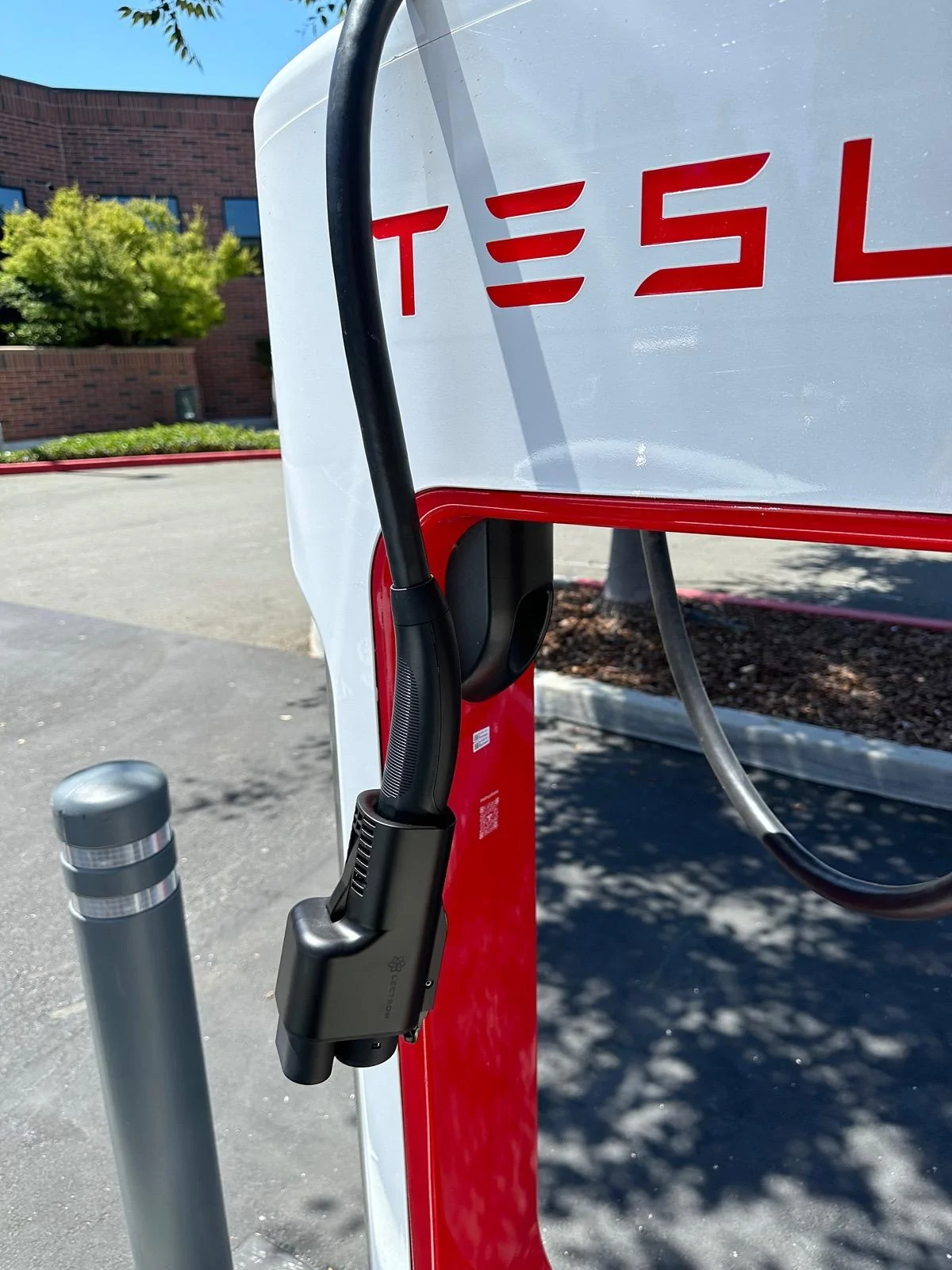

I charged my Tesla at a supercharger station in Fremont, California today and I noticed that someone had left a Lectron adapter attached to the cable on the stall next to me. I tried to remove it and it wouldn’t budge.
This was exactly what I was concerned about when I received my Lectron Vortex adapter a couple of weeks ago. I had read that some people were having trouble removing the Lectron adapter from Tesla connectors so I decided to try the mechanical fit on my Tesla charging cable at home. It went on with a tight fit and was extremely hard to get off. I ended up removing it while wiggling it back and forth vigorously while depressing the release latch. I was relieved that I got it off but decided to try it on a second Tesla connector that I have. This one was even tighter. I could not remove it by hand. I finally got it off by using a C-clamp to depress the latch as much as possible while simultaneously prying on the Tesla connector with a very beefy screwdriver. This left some ugly gouge marks on my Tesla connector and the Lectron adapter. The Lectron adapter is now “broken-in” and easily attaches and releases from all three of my Tesla connectors. I then had confidence that I could use the adapter at a Tesla supercharger to charge my R1T without it getting stuck. It worked fine.
I emailed Lectron and pointed out that they might have a problem with some of their Vortex adapters. I got a reply saying that I should only use the Vortex with Tesla supercharger stalls. I replied that I knew that and I was only trying it out for the mechanical fit. They did not seem to acknowledge that they might have a quality problem on some of their adapters. They said they would accept a return for a refund within 30 days if I paid the shipping cost. Even though it is kind of beat up now, it works so I will keep it for now.
