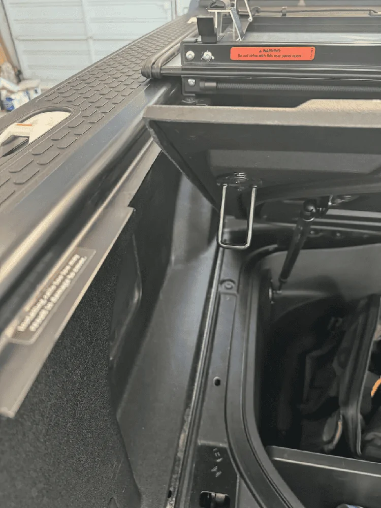

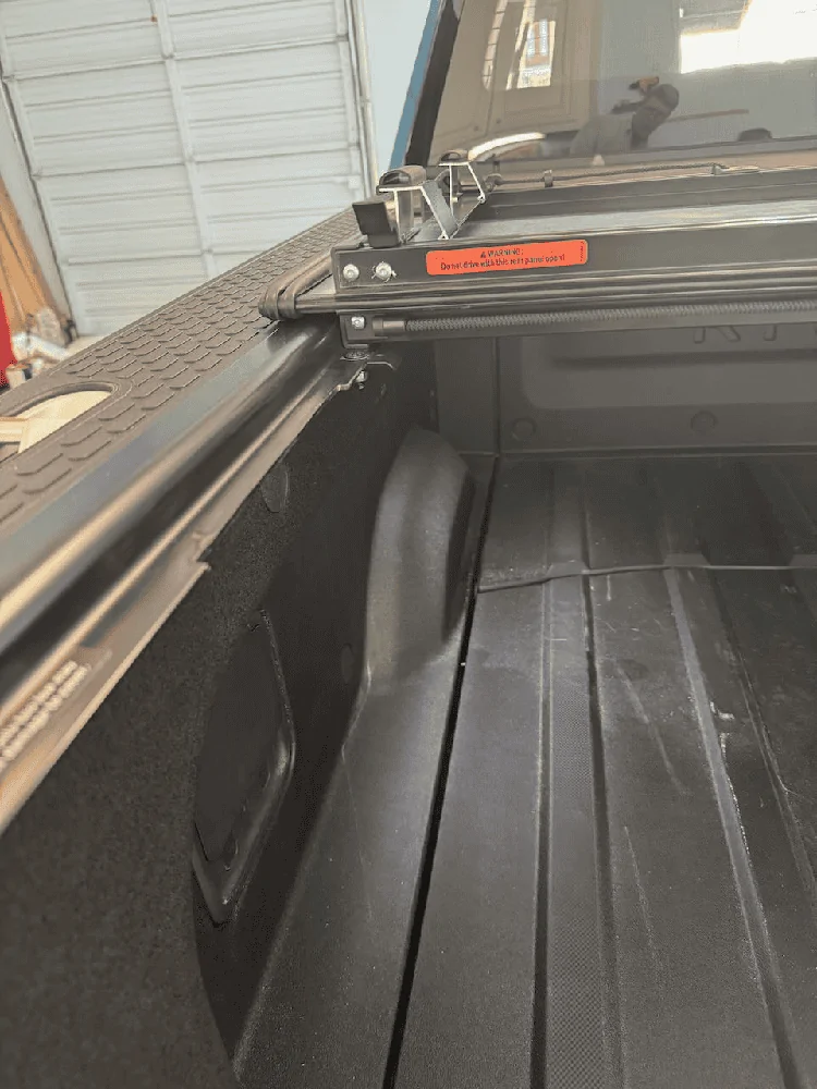

I got the LoMax and installed it a couple of weeks ago. Generally love it, but was frustrated by the way it blocked the spare tire compartment from opening fully. Did a little dremel work on it, notching both sides by 1/4" and problem solved. Not beautiful, but effective. Will do a little paint touchup later this week.
Thanks for posting your modification. I just installed mine, but will probably do the same rail-mod on the next sunny weekend.

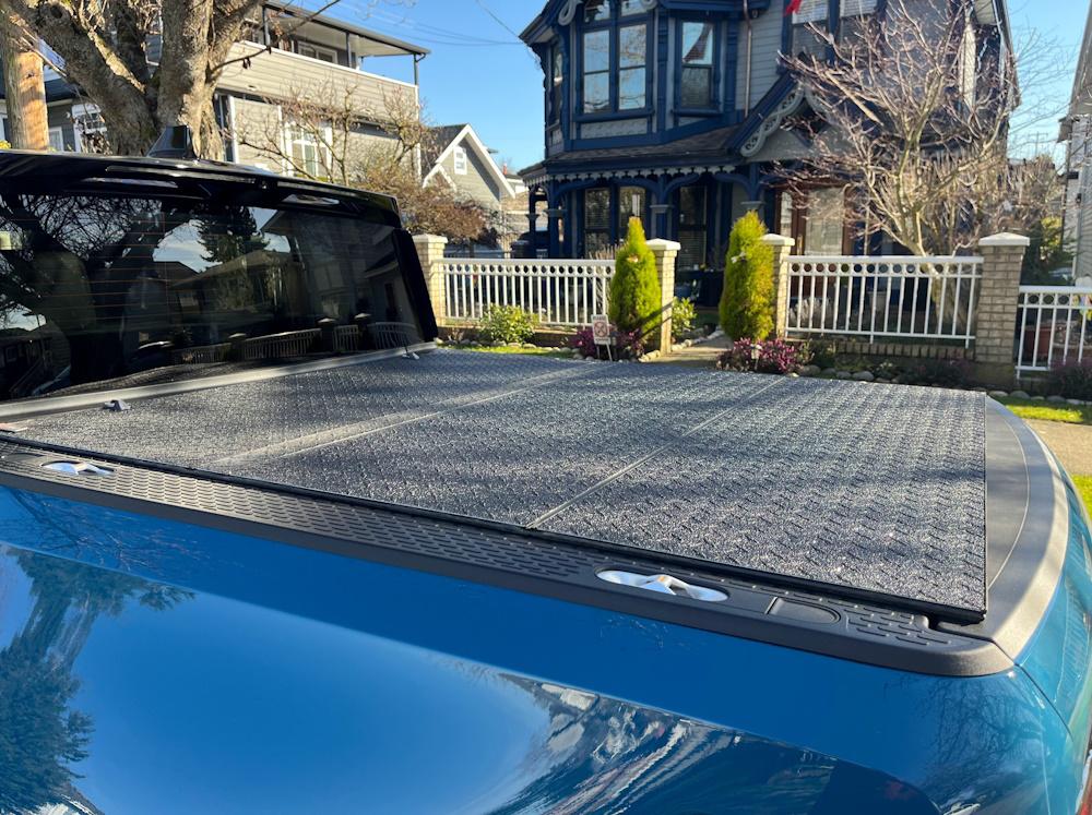

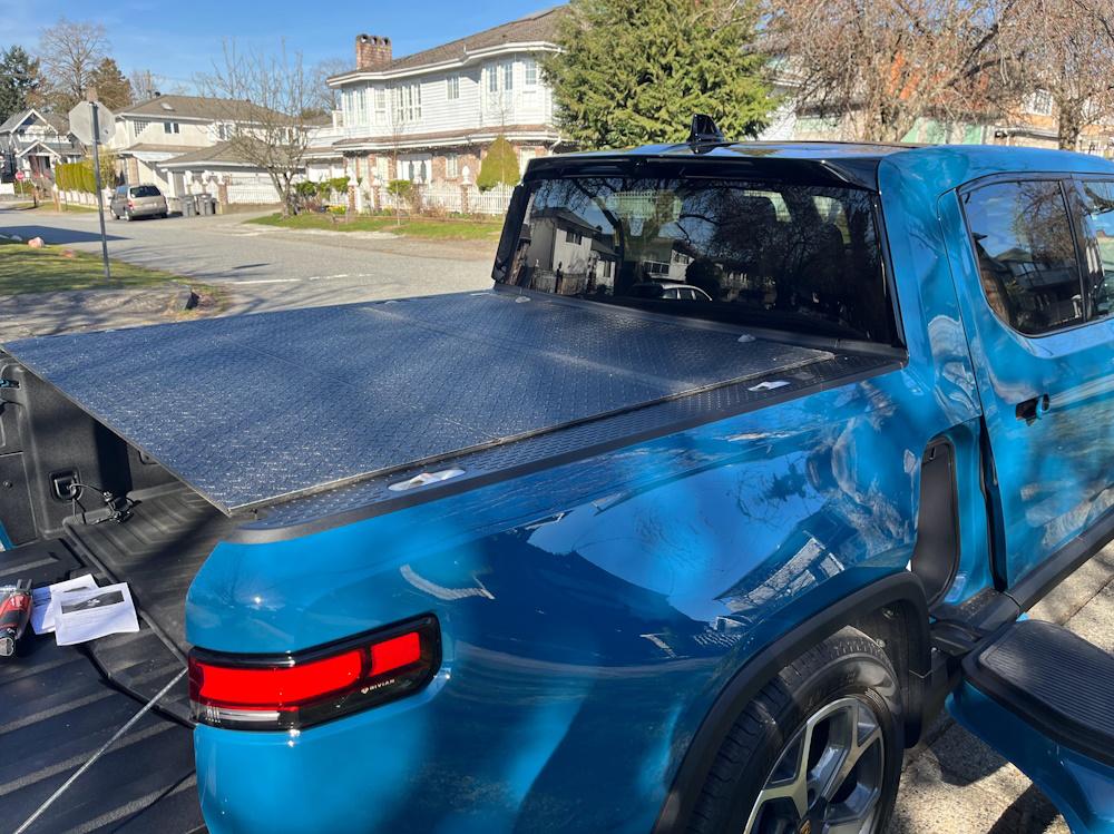

Ordered mine from Summit Racing, just because I've ordered a lot of stuff from them over the years and their return policy is among the best.
Took me about 45 minutes from unboxing to install. The slotted washers were a little tight on the passenger side, but a push on a screwdriver with my palm popped them in.

Will note that the cutouts only needed to be about 3" long. I kinda overdid it. Lol.
