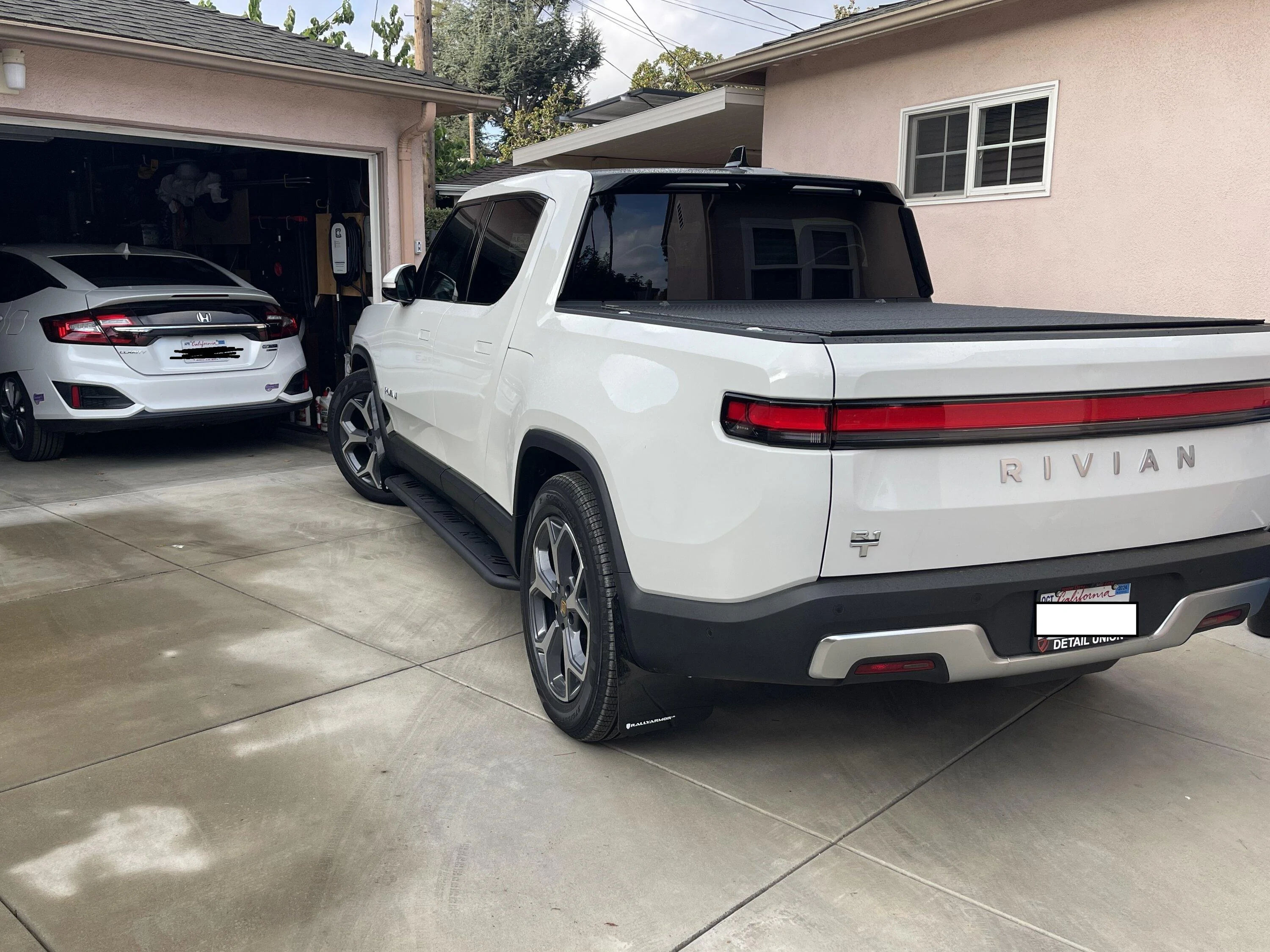

Hi, I have the LoMax Pro Series installed on my R1T. Great cover, weather proof to 95%, during a heavy rain bits of water got into my bed. The only drawback is the spare tire cover opening is limited by the rails required for the install. It doesn't bother me as I can maneuver the spare tire in and out of compartment.
Thanks! I installed this months ago and realized I had to adjust the rails a few times to lower the cover so that the rain doesn’t get in. A couple weeks ago I drove through pouring rain on a 4 hour road trip and not a single drop got in the bed. Really impressed with the cover.
That's great info. Thank you! I will try that today!
