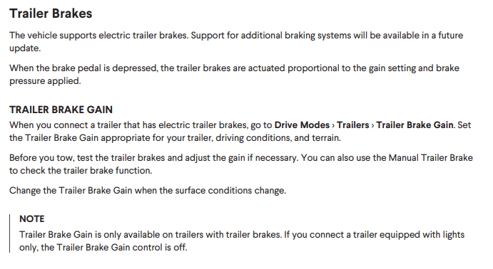

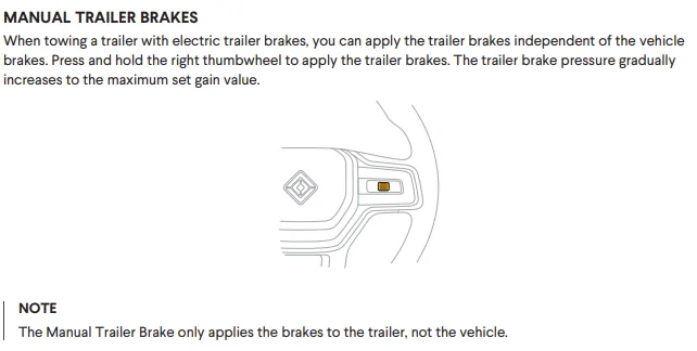

  • Towing a trailer. This needs to be addressed. I tow a 10k trailer. It weighs more than the truck. When regen braking comes on the truck needs to send power to my trailer brakes, otherwise when it is wet/slippery the trailer will push the truck around and jackknife the trailer…. I don’t want to be fidgeting around to push some button to activate my trailer brakes… it has to be autonomous. I’m posting this on the forum to put it out there. It is a liability for Rivian that should be a priority to fix
I don't think you need to hit the button. It definitely activates with the normal brake pedal, same as you'd expect from an ICE vehicle. I'll be honest that I'm not 100% sure if it'll activate the trailer brakes during regen though, but I've never noticed or felt our 5000 lbs trailer pushing the R1T or R1S around under full regen, even on somewhat slippery roads.
The manual doesn't say anything about it either way, only this stuff below. You've been towing for a long time so you know how to set the gain to the proper level.

yea, I read that. Thank you. In my other trucks my goal is actually to never or at best seldom hit the brakes.. Always leave room, etc. But, in my ICE trucks, you need to hit the brakes to slow down sometimes... Just like in the R1T I need to take my foot off the pedal all the way. When I do that it initiates rather aggressive braking with the regen. Which I really like! What I would like to see happen is the trailer brakes automatically get some power to activate them when aggressive brake regen is used.

When you’re in tow mode, have you adjusted your trailer brake gain? I have mine set at 4 for a 7000# trailer. Your trailer should not be pushing you around.
yes, absolutely. Unless you hit the brake pedal it does not engage the trailer brakes. I don't hit the brakes unless I really have to.
