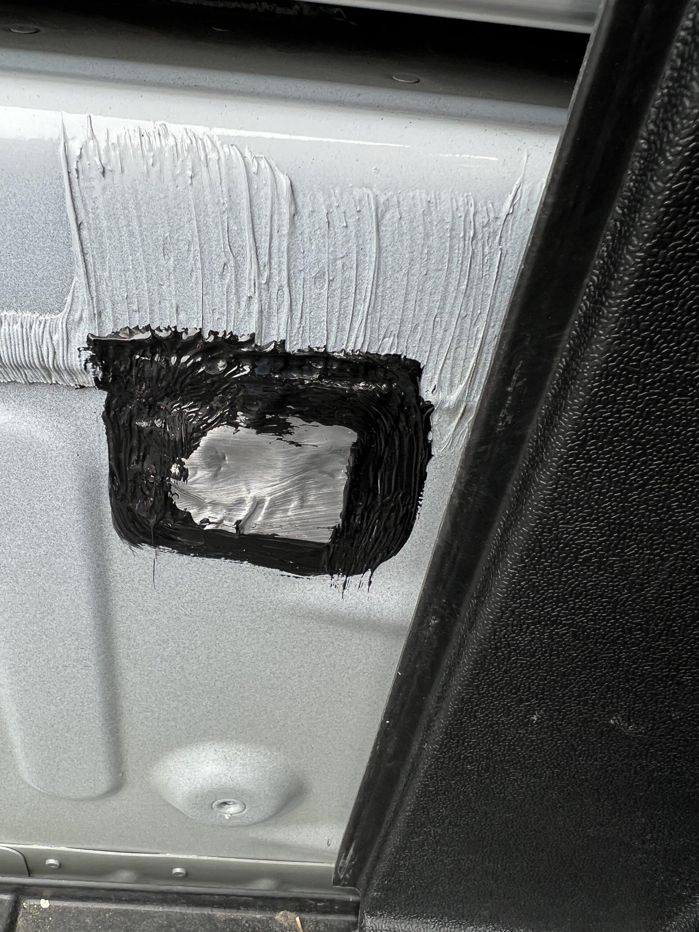

I believe there are two places in the front of the bed to pass thru a 12v wire from the gear tunnel.
I pulled the plastic front bed panel off (8 10mm bolts) and saw two sealed holes that may go thru to the gear tunnel. They look to be sealed at factory and couldn’t confirm they go completely through as I have a loaner and didn’t want to puncture the seal.
