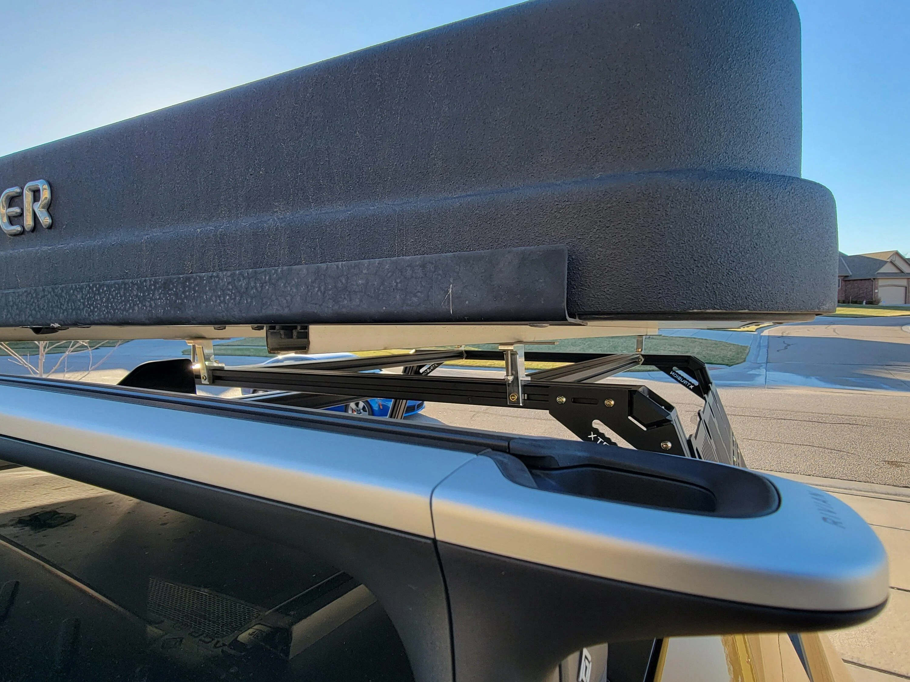

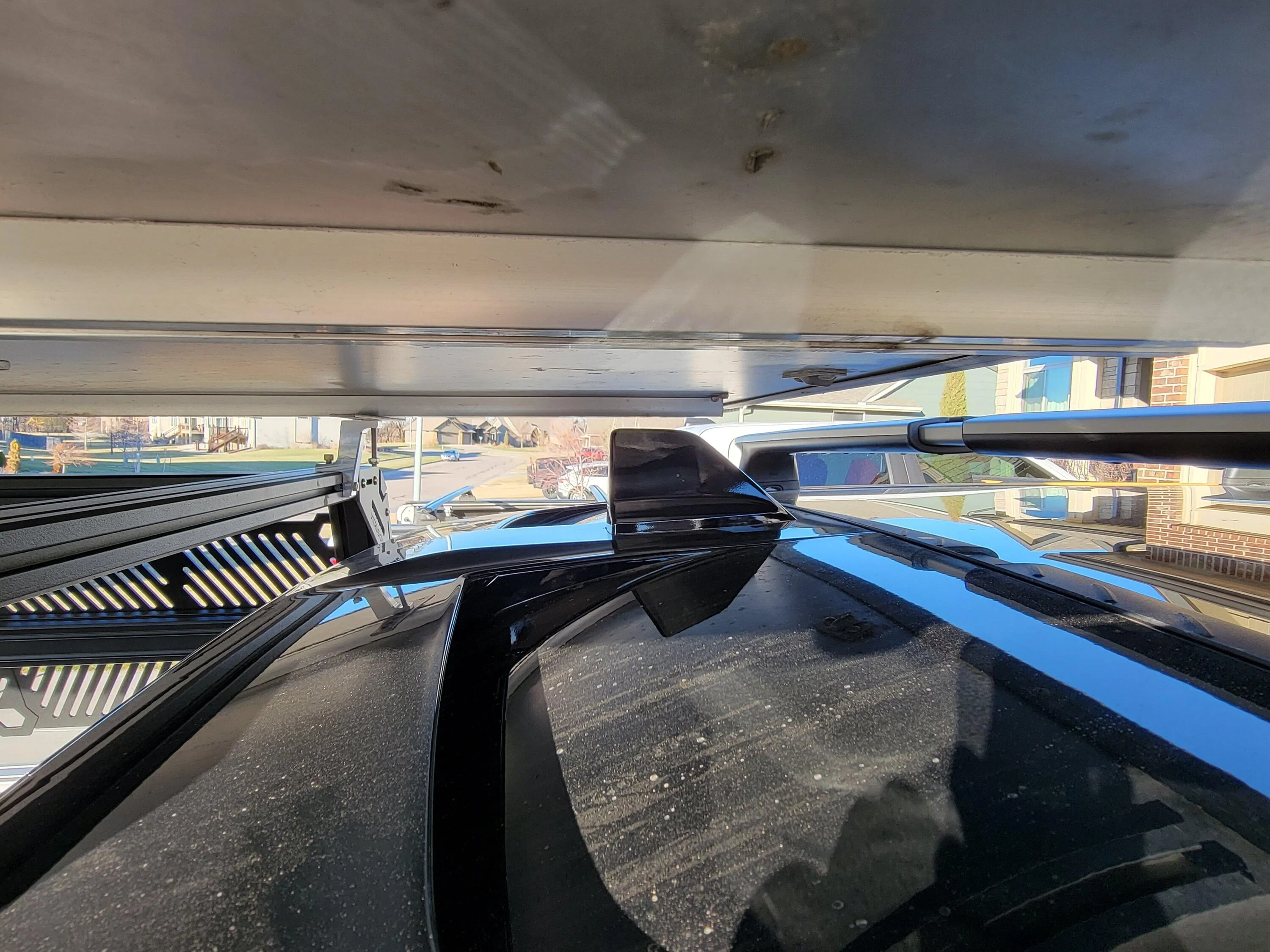

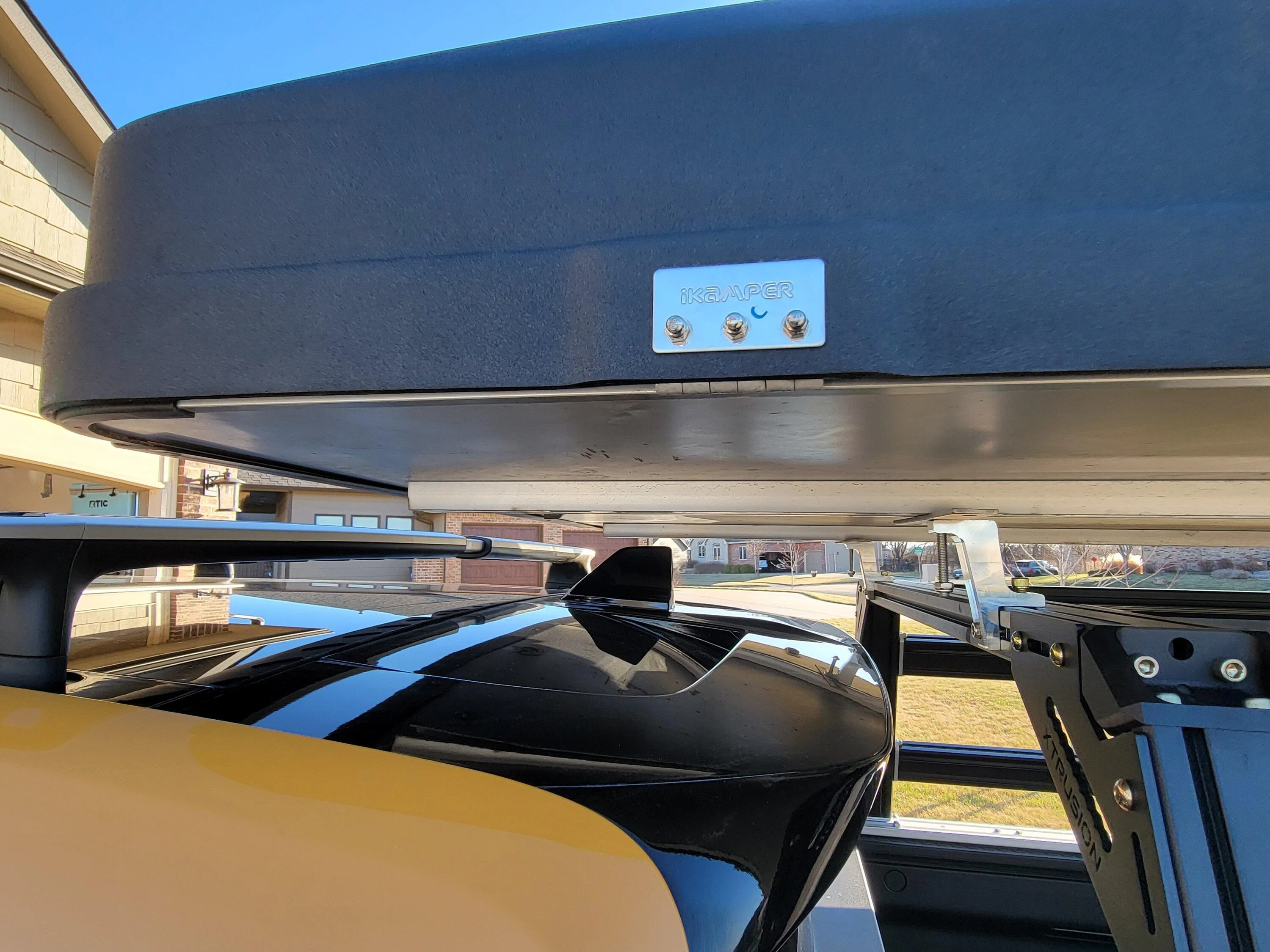

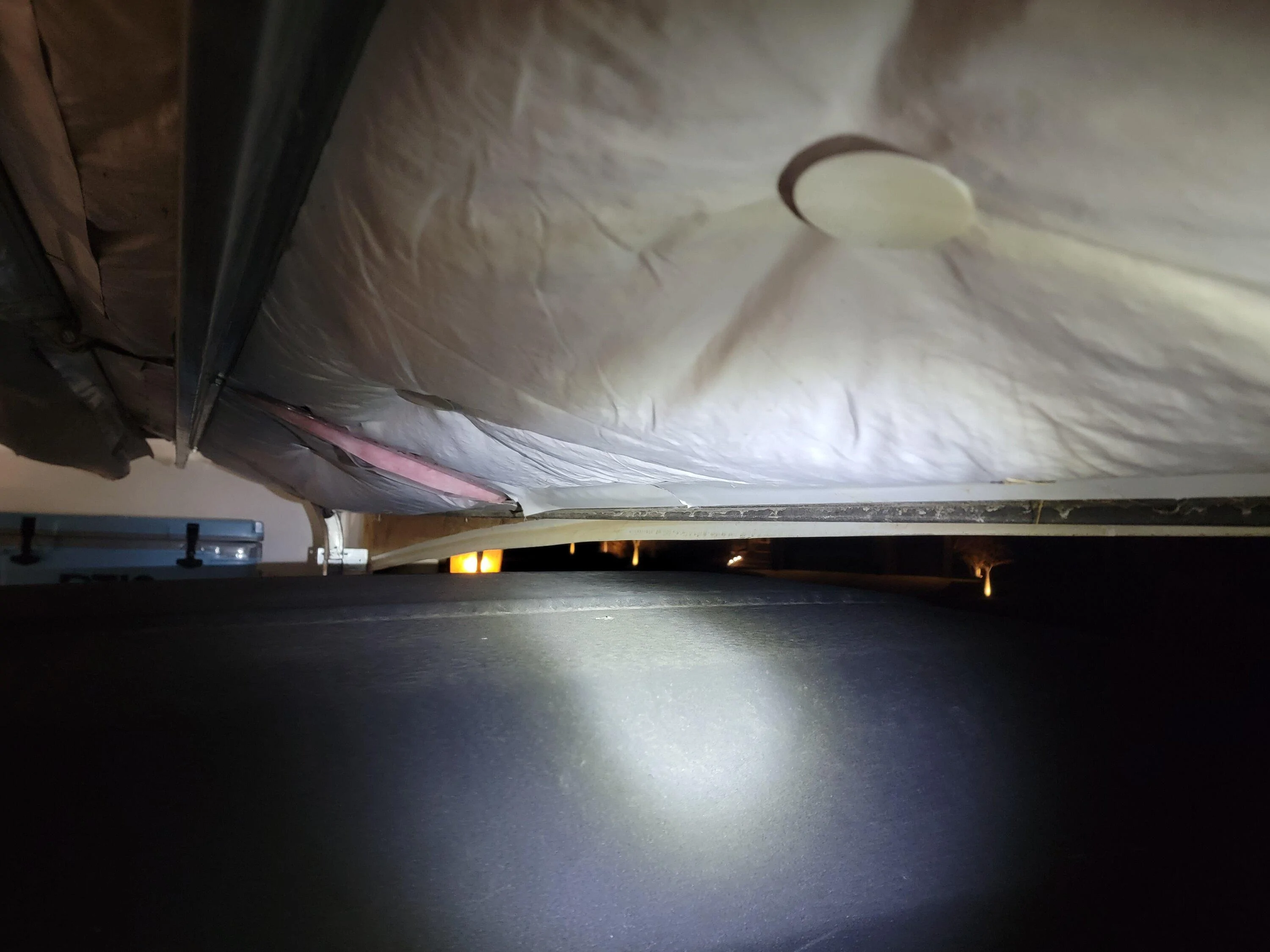

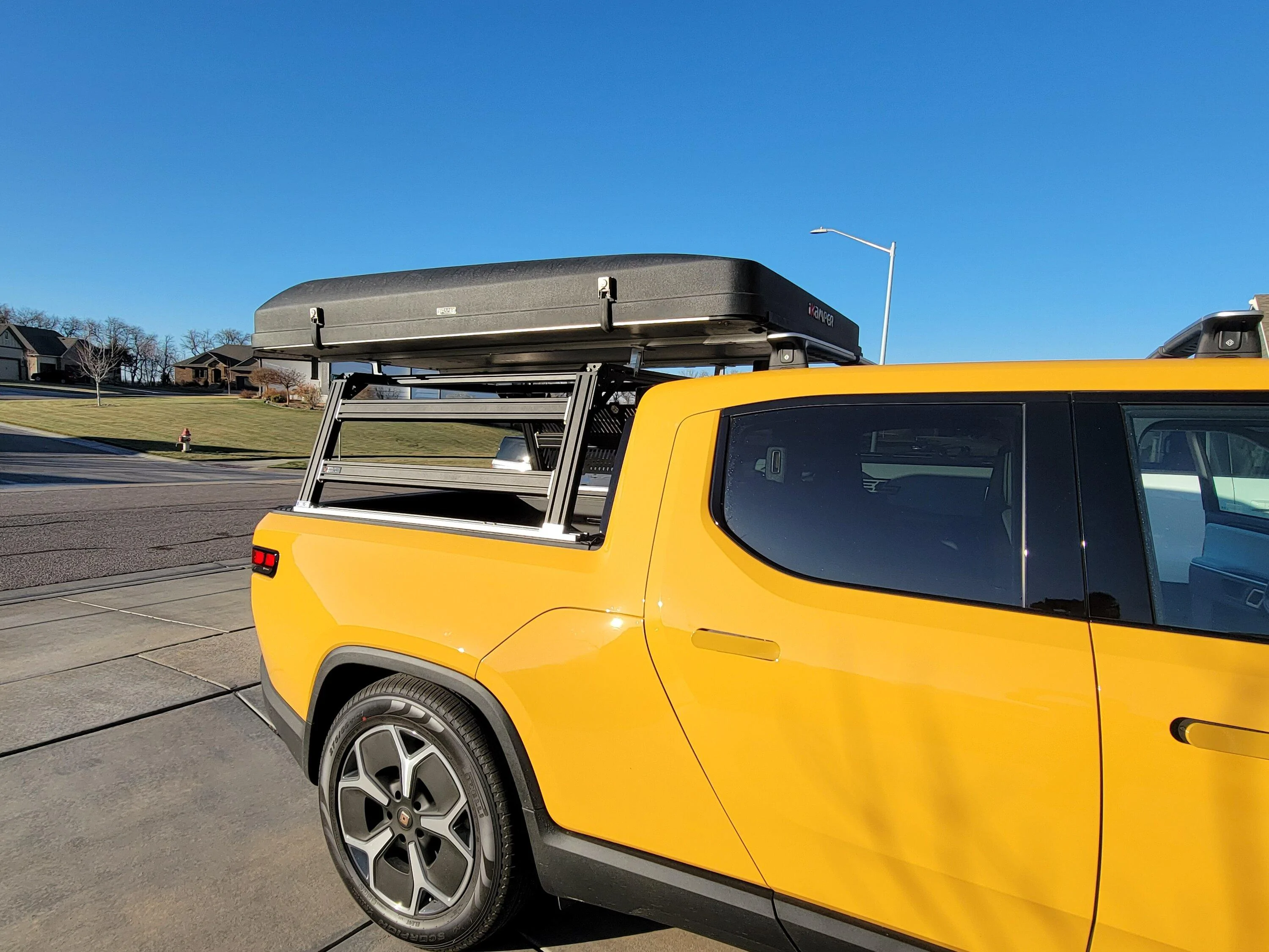

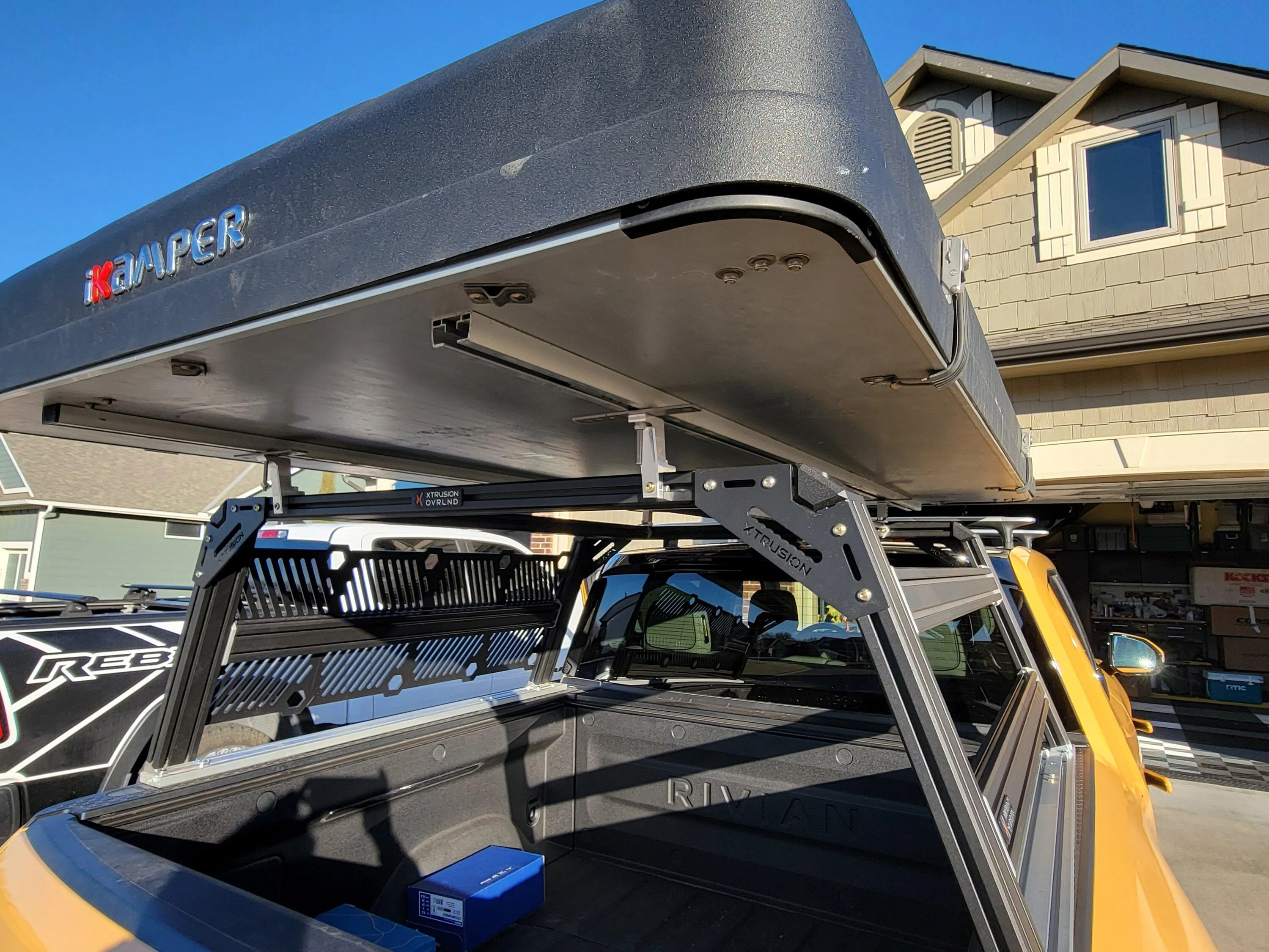

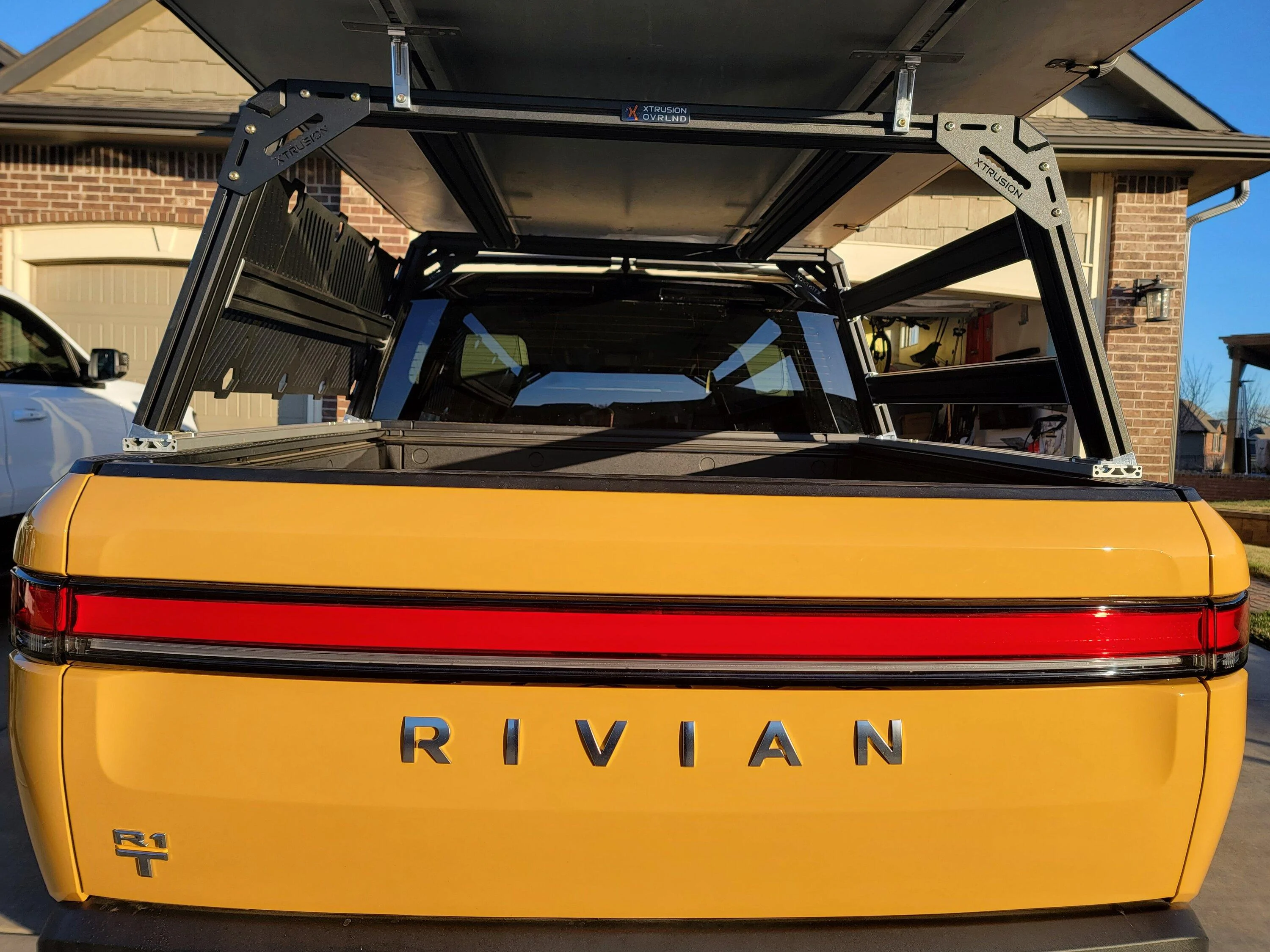

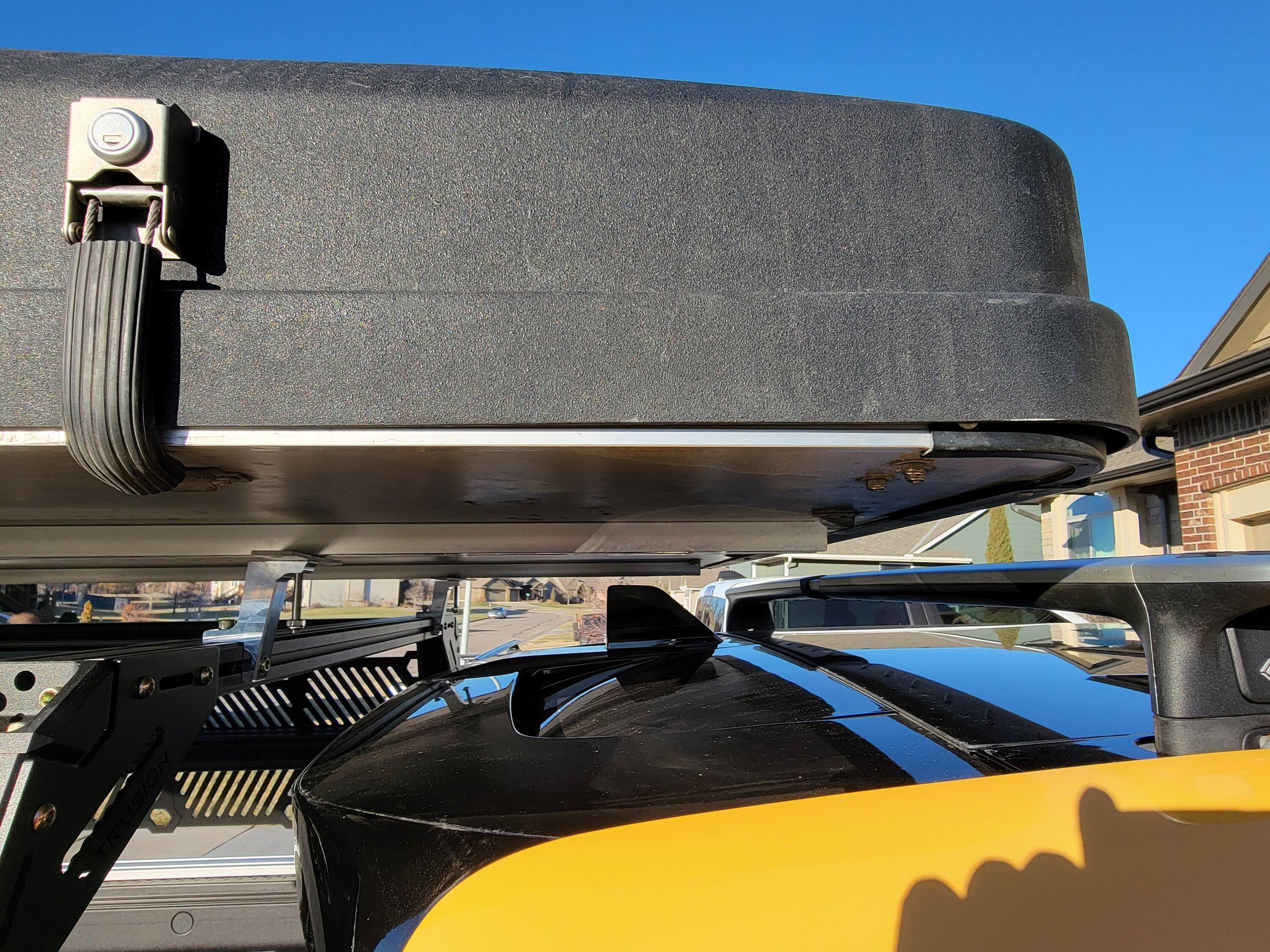

Sorry been busy, but answer is yes. See attached. The Xtrusion guys haven't seen it yet but will be taking by in next 2 weeks or so for them to check everything out to ensure my test right and extensions working as planned. Haven't had a chance to really drive much so will give impressions later this week. It is rock solid.
A few Observations. Top Rivian bars clear fin, optical illusion makes it look like they dont. 2 1/4 needed from my rack to stay level with them. I also have IKamper with the 1 inch t rail. So overall I could probably go with 1.5 spacers vs 2.5 but probably good to have a little room over fin just in case.
I have 8 foot garage and in normal stance have about 1.5 inch clearance. Probably enter in sport just to be safe. I also have 21s and I think 20s add an inch. So will be very tight with those on.
Also I didn't have bolts tightened down in photo but took to ensure good light from sun, so don't worry lol.

Amazing! I have been researching for weeks, looking for exactly your set-up pictured here! Thank you so much for posting this information, it's really helped me. I am looking to get a full size iKamper Skycamp 3.0 and will need to install it on a rack that can clear the cab and cross bars on top of the cab.
I'd really love to have the xtrusion bed rack height be even with the spoiler (when no RTT attached, love the look/aerodynamics of the rack at spoiler height), and then use spacers high enough to clear the radio fin, and ideally the stock cross bars installed on top of the cab.
What is the height of your xtrusion bed rack exactly? And how tall are the spacers they provided?
Asked another way, what is the lowest height the bed rack can be to be able to get a full size roof top tent to clear using spacers? :)
Any help appreciated! Thanks again for being so awesome with posting the pics and info.

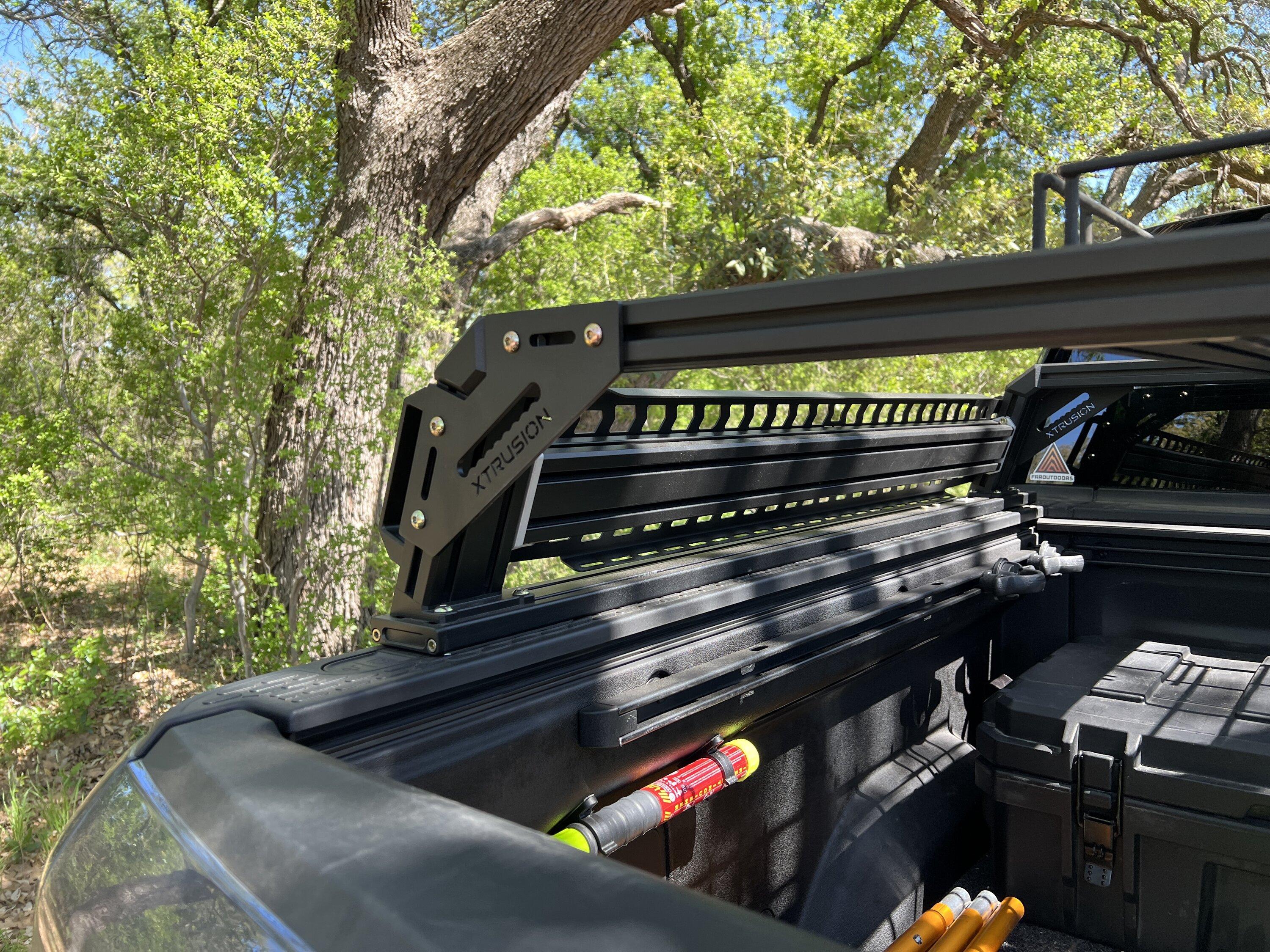

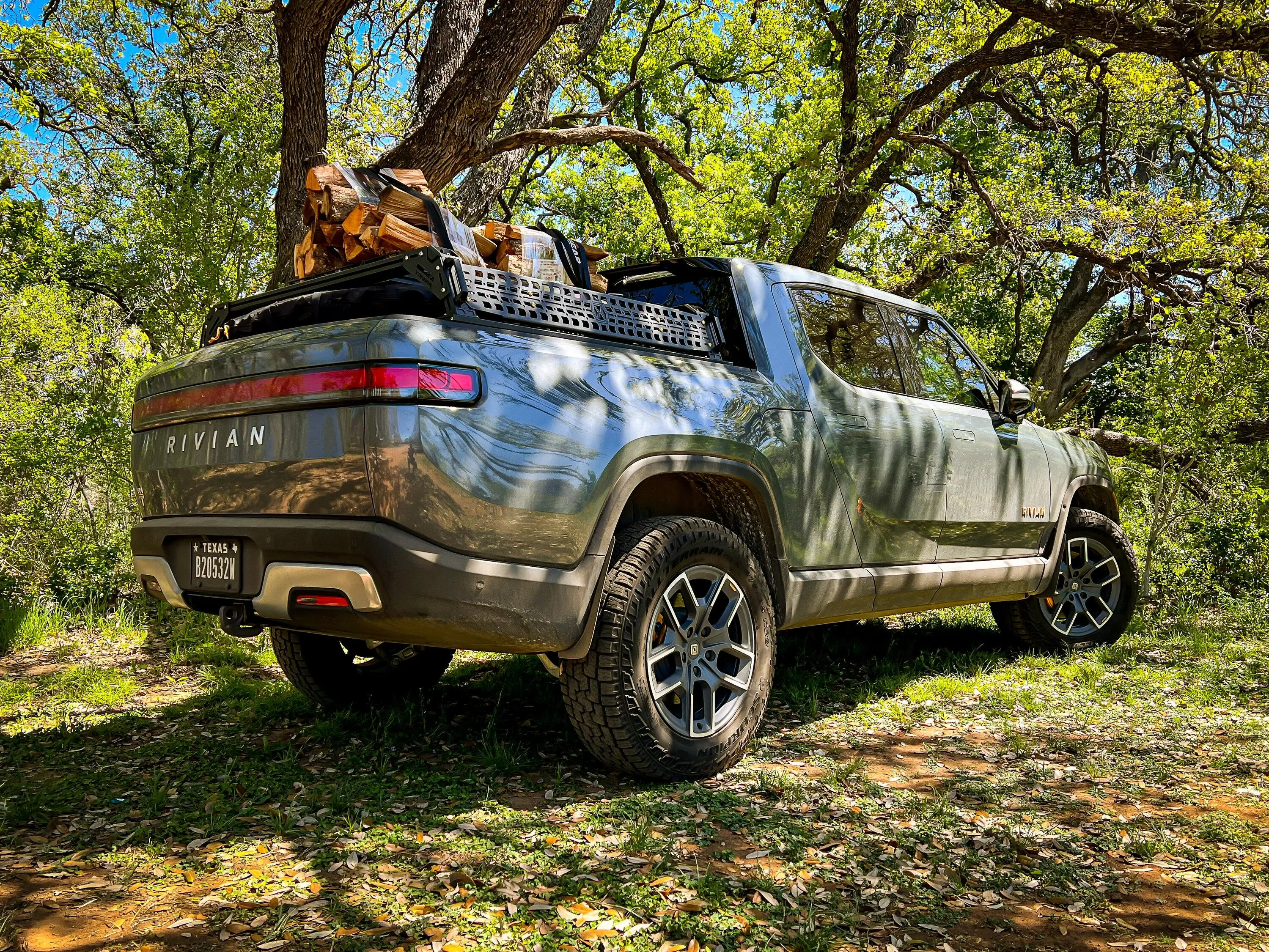

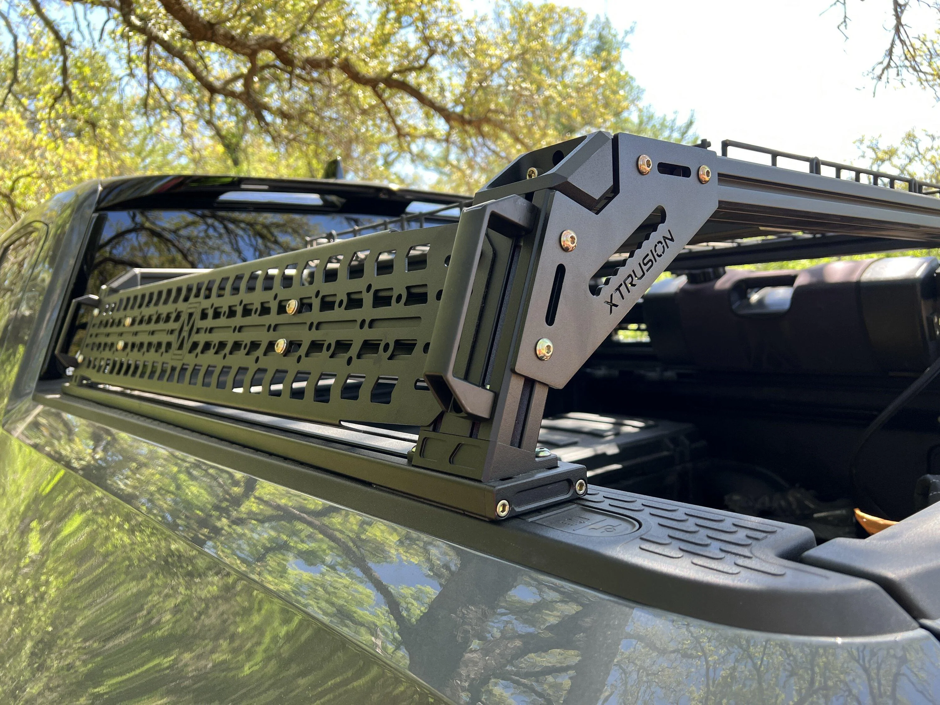

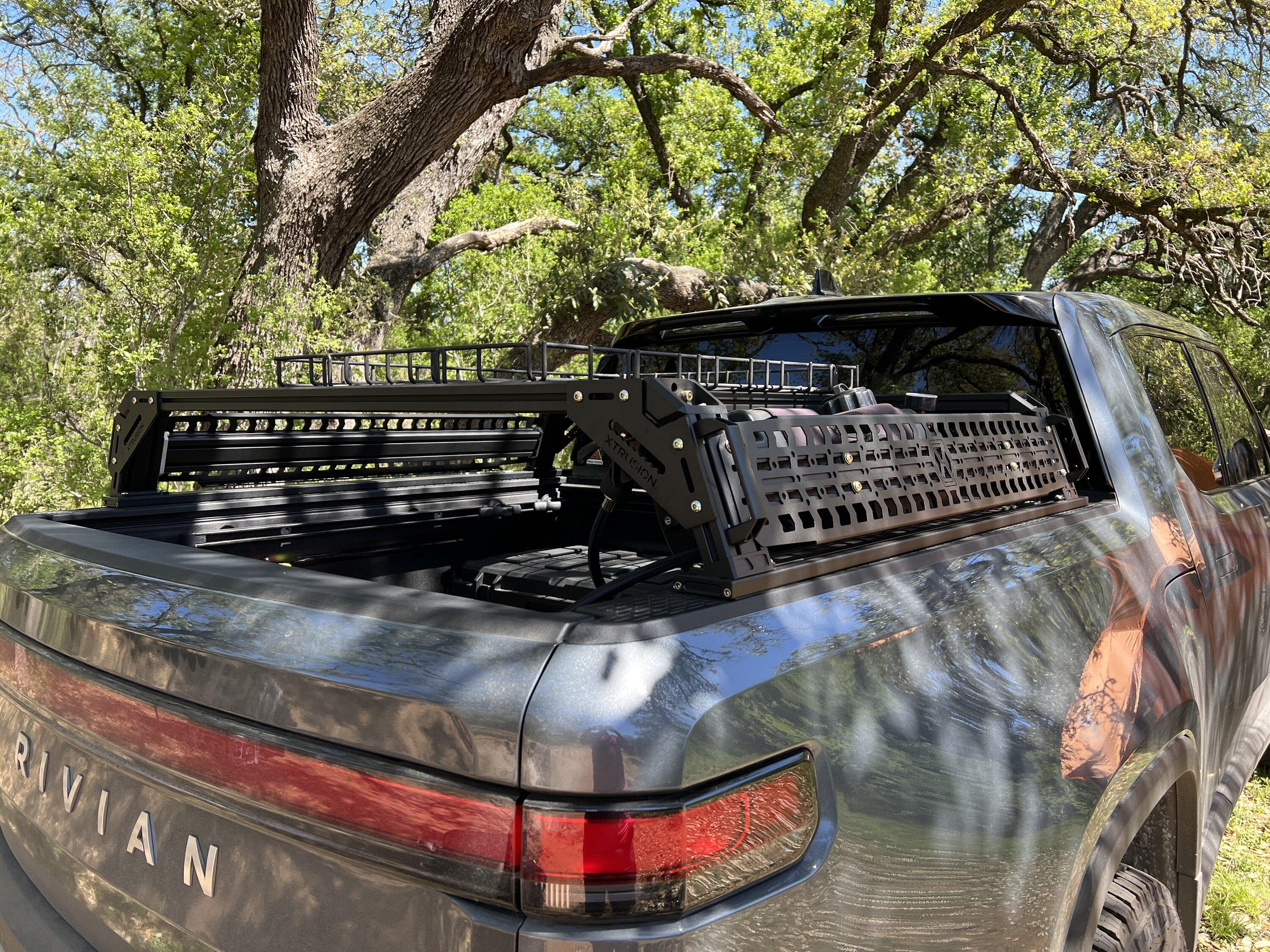

Sure did, received and installed on Thursday. Used this weekend for camping. Over the moon with this setup. I have a bunch of brackets/mounts on order for axe/shovel, tred pros, antenna, etc.
So far I've added the Yakima basket and Waterport.
A few pics:

OOF!!! That is FIYAHHH!!! Love love love it. Excellent choice. Got me amped for my delivery. Heard word that I'm in the queue. Exciting times! Thanks for sharing pics! ENJOY!

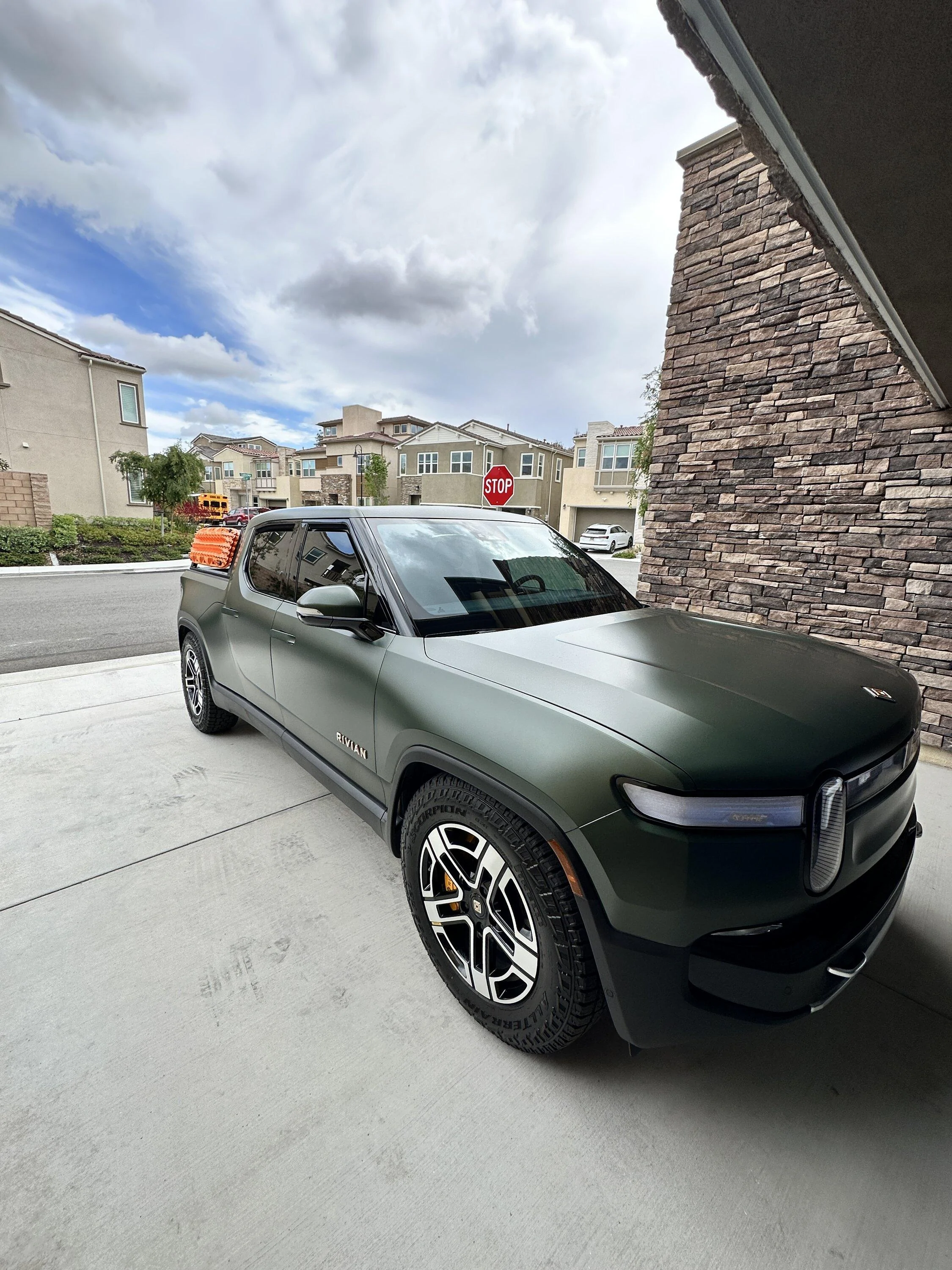

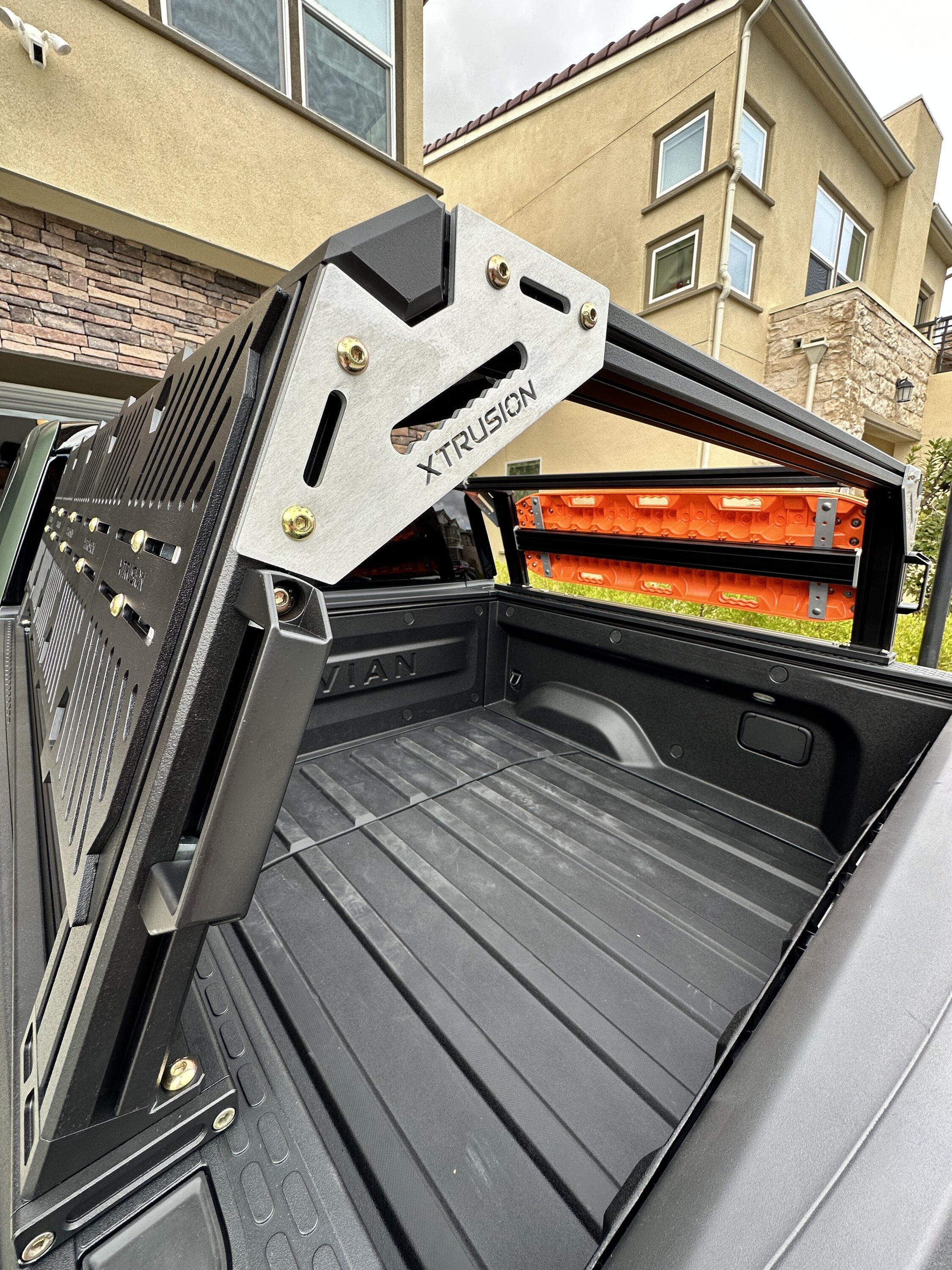

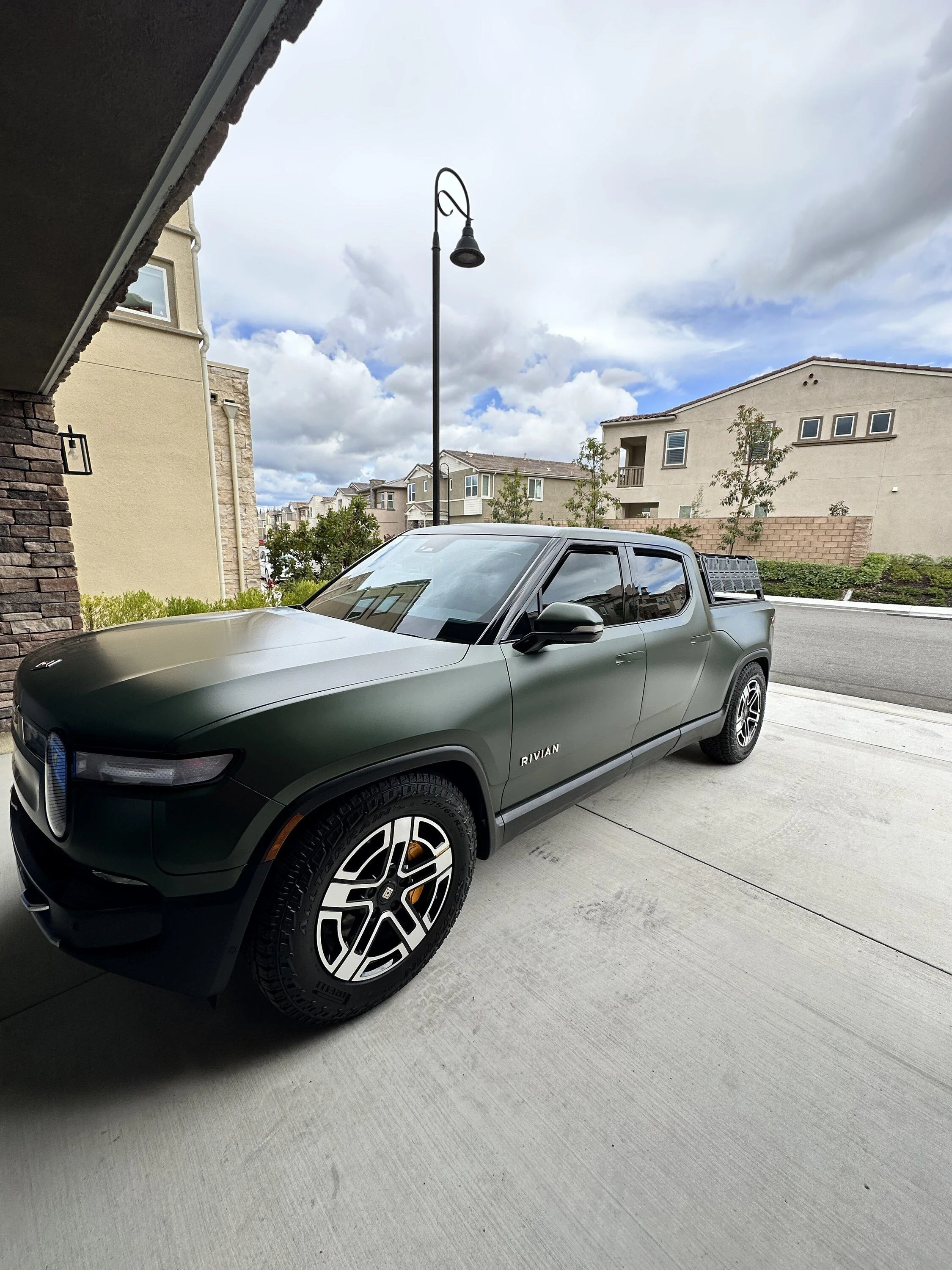

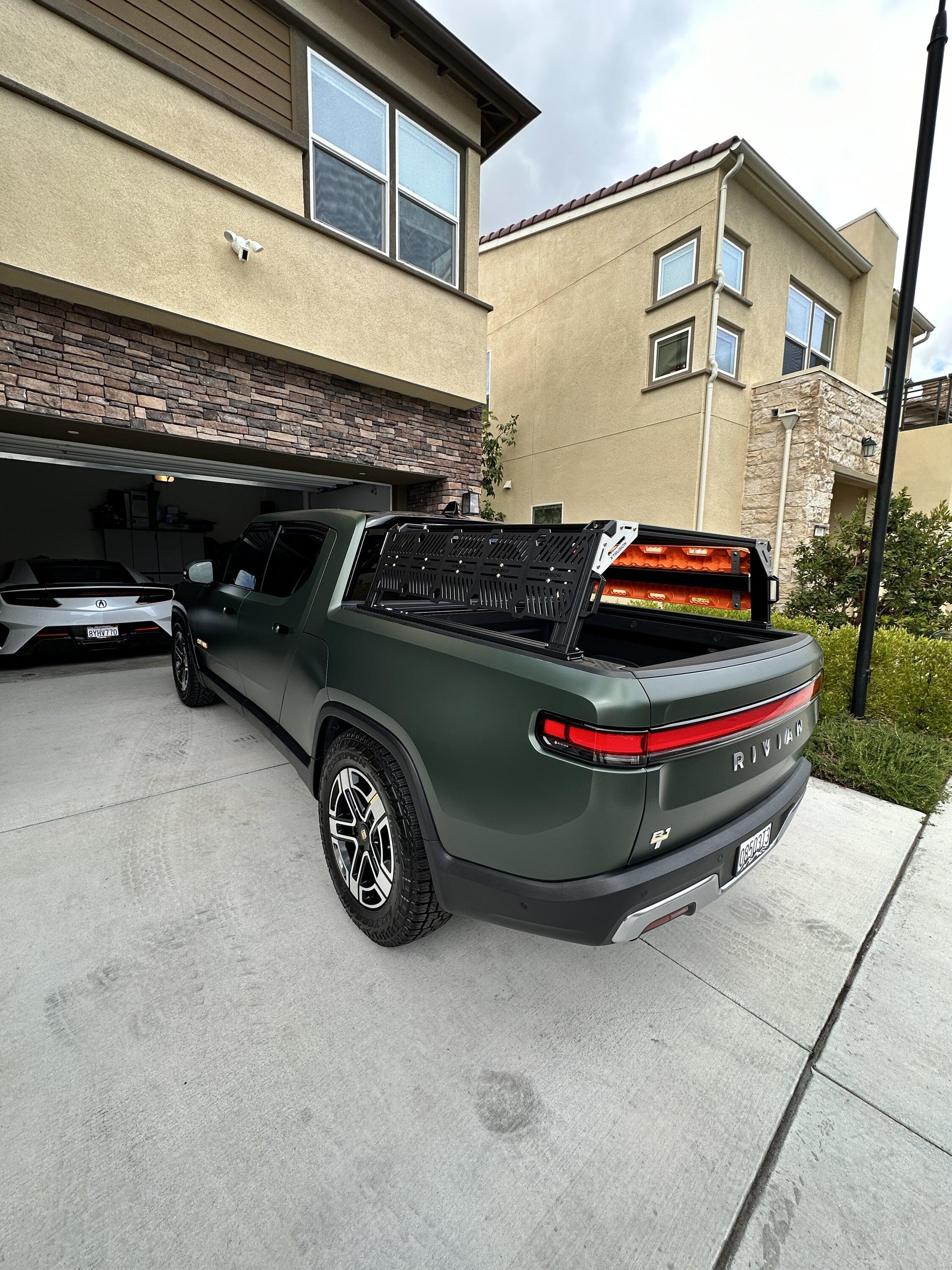

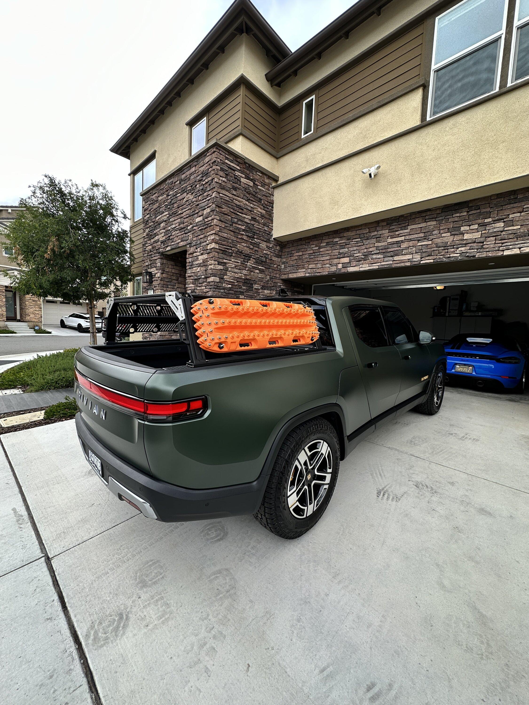

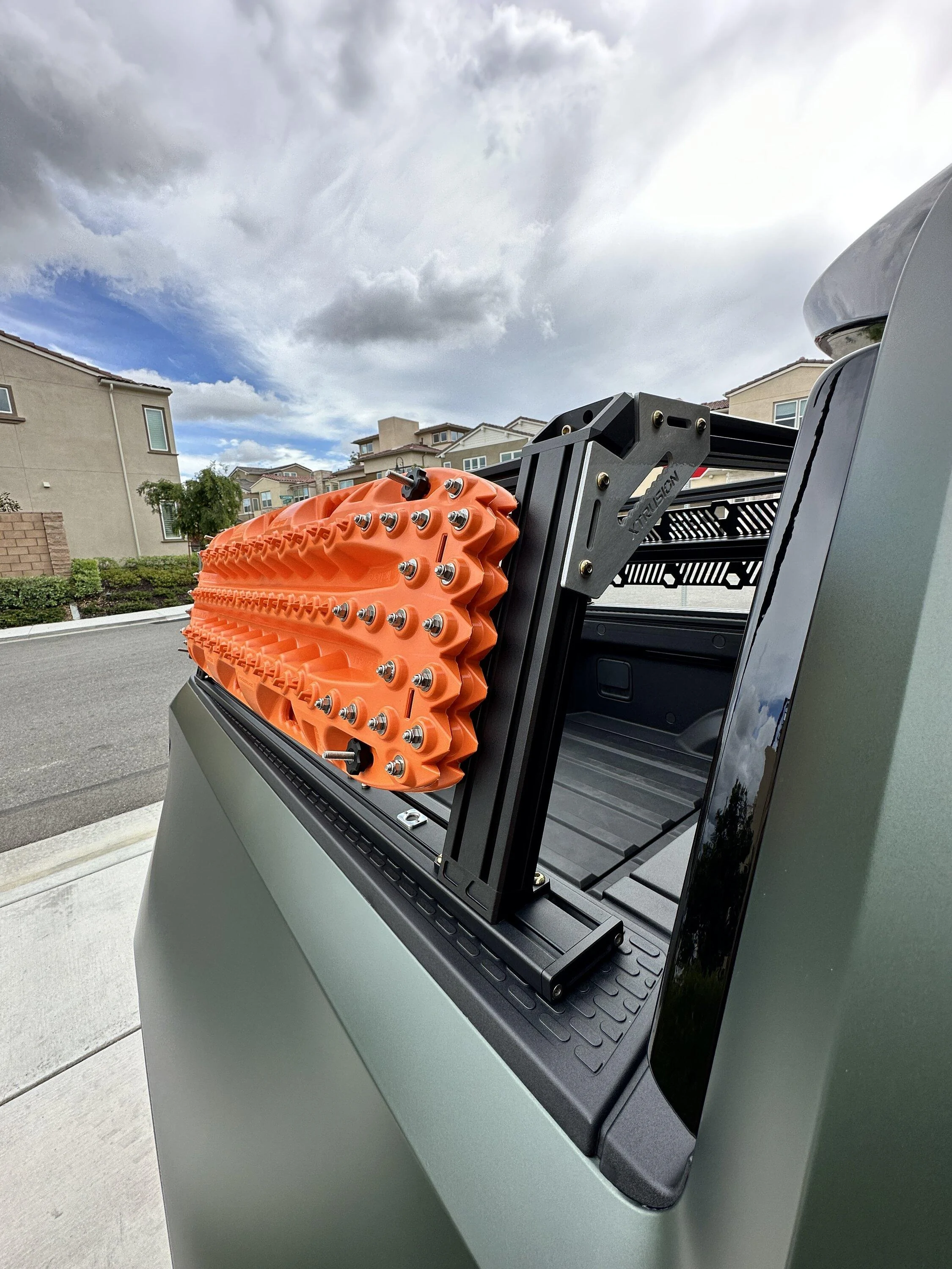

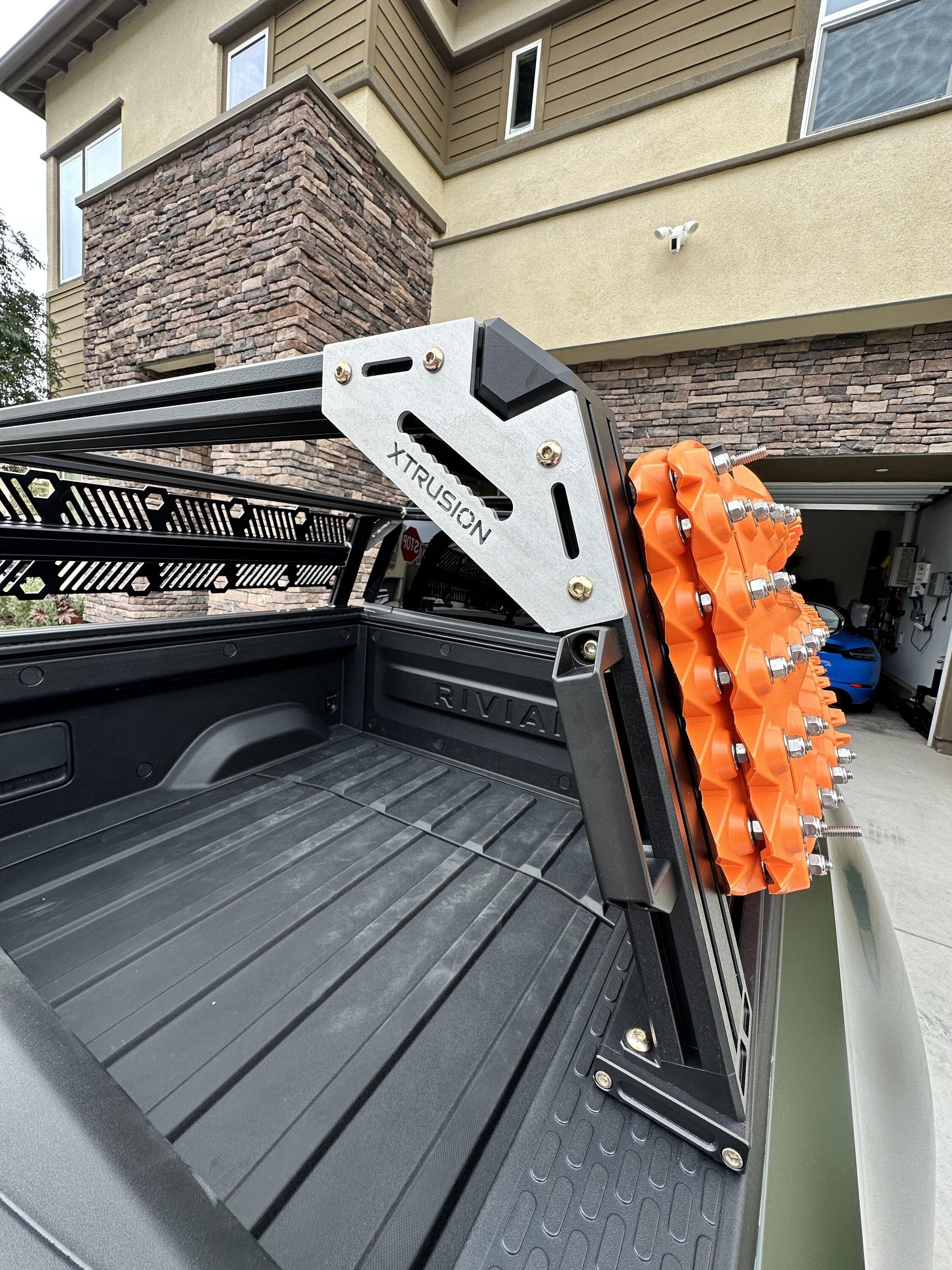

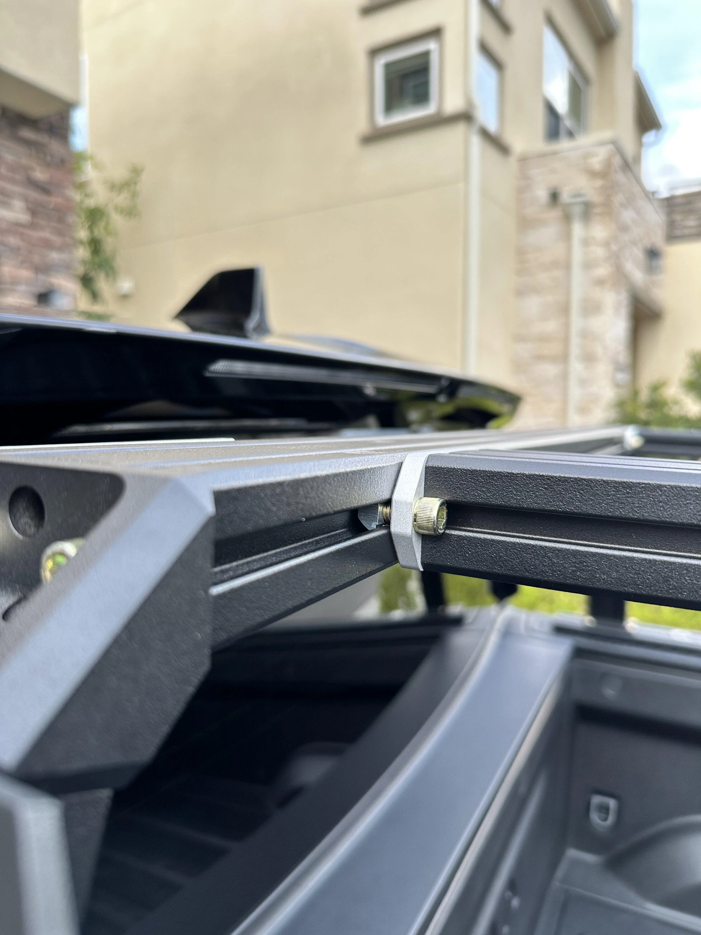

Just received my Xtrusion rack as well. Still a few weeks away from our first camping trip so more to come.
In the meantime, here are some shots. Enjoy!

Looks great! What height rack did you go with, 16/17? Would love to see what it looks like from the over the bed camera.

and those end-caps with Xtrusion written on them, did you choose the unfinished for contrast vs the powdercoated?
sonystyle02
Sony
Feb 1, 2023
Orange County, CA
‘22 Porsche Spyder, ‘22 NSX Type S, ‘20 Rubicon
Exactly. I’m all about the contrast ?

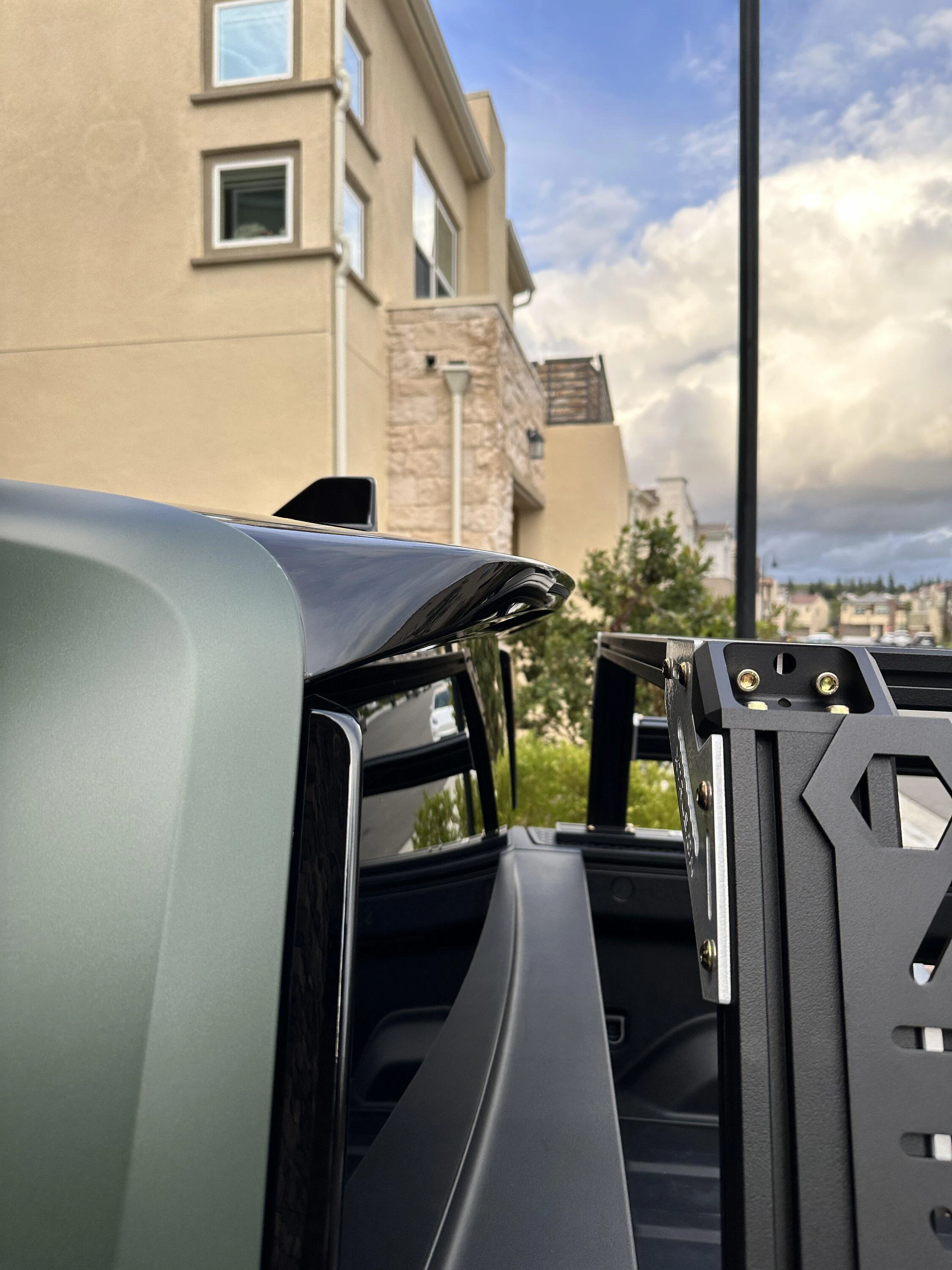

like krockett, wondering what the over bed camera looks like and what height you went with. Trying to go as tall as possible in the 16-18 range without blocking the camera completely. Camera looks to be about 18" from the bed.

I went with a 16” setup. Here’s some more detailed shots -
