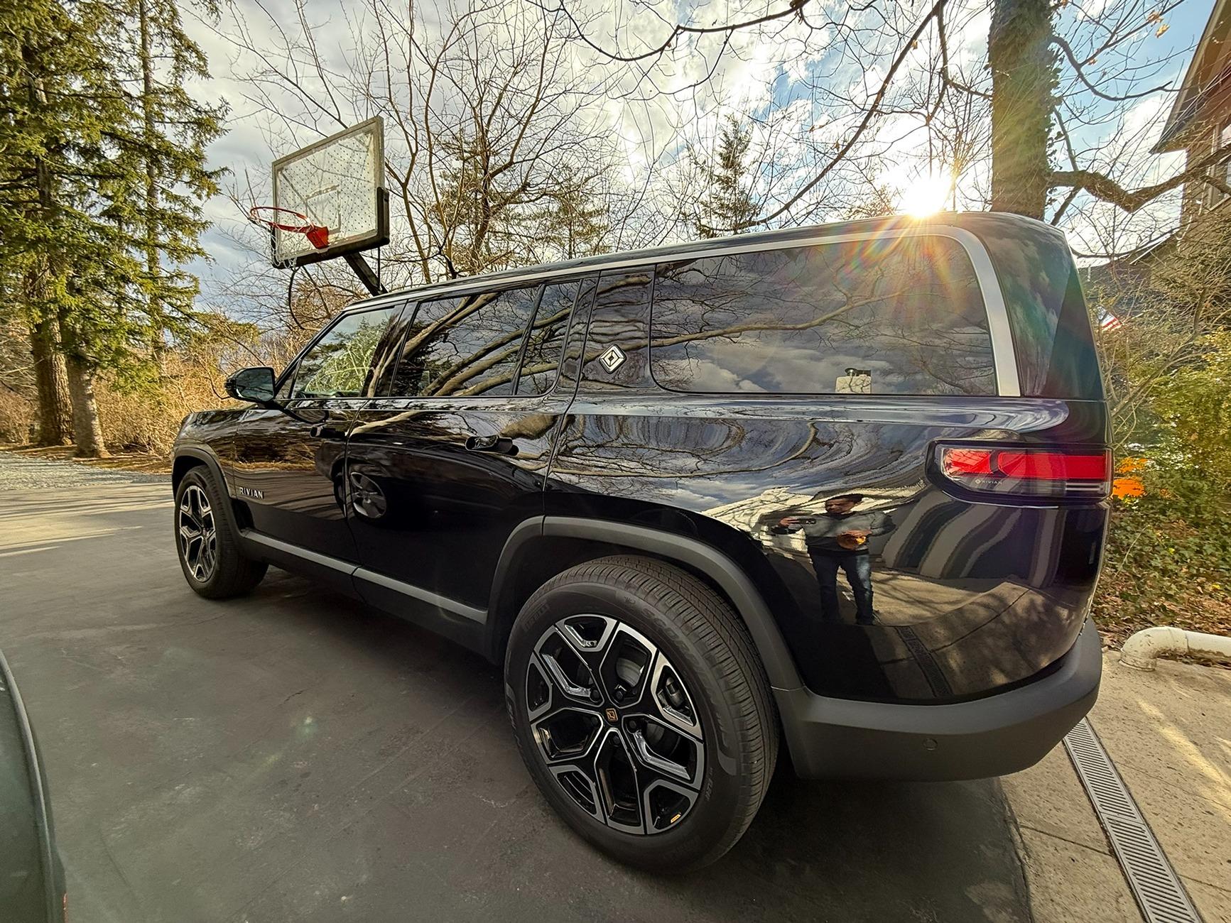

Just put on a coat of Chemical Guys Carbon Force Ceramic this weekend. Key is to work on small sections - say a half a door or 1/3 of the hood - at a time so you can buff off as soon as it flashes. If it sits too long it's a bit of a hassle to buff off.
Link: https://amzn.to/3Dhx2IM

Ironically my Dual Large delivered two weeks ago has the worst orange peel I've ever seen on a vehicle in 35+ years of driving. Paint depth is all over the place, orange peel basically everywhere. Must have gotten a late Friday afternoon build, it's horrendous.
