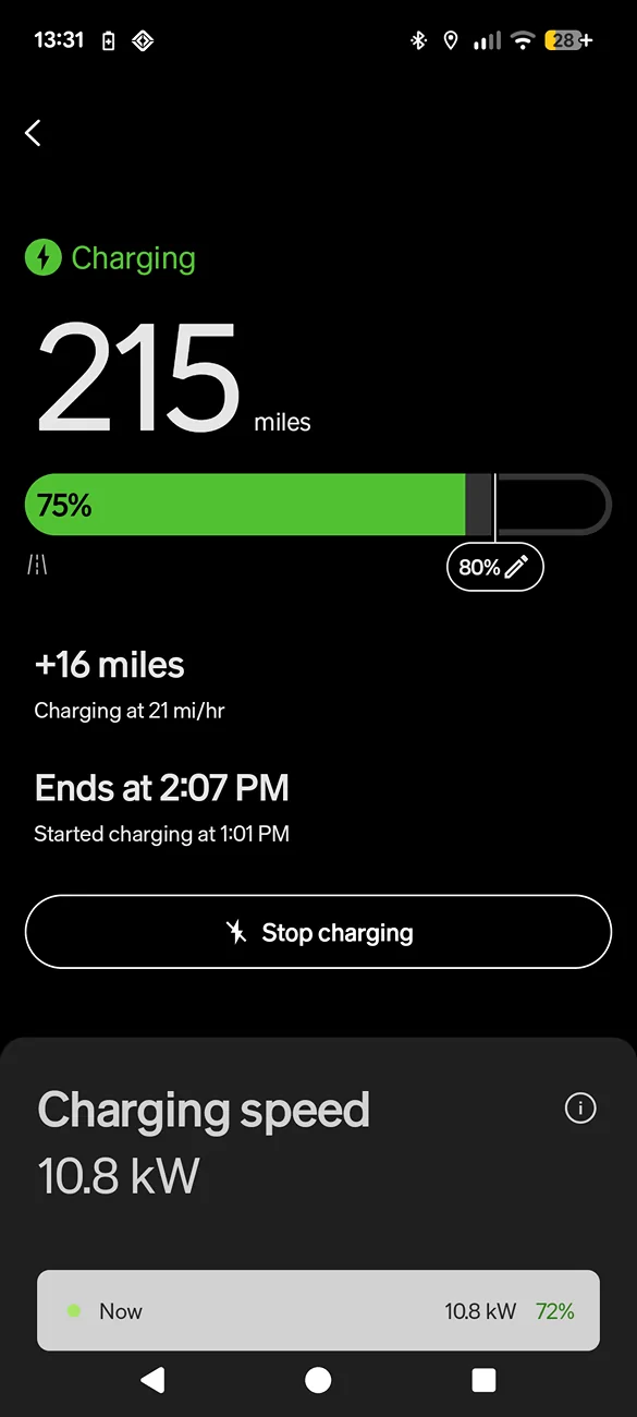

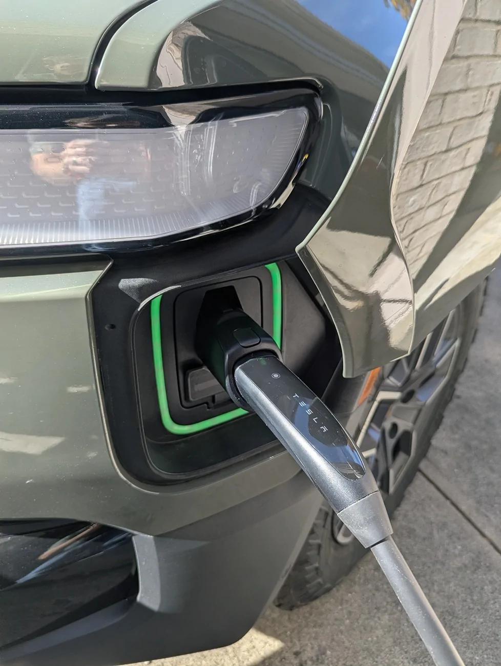

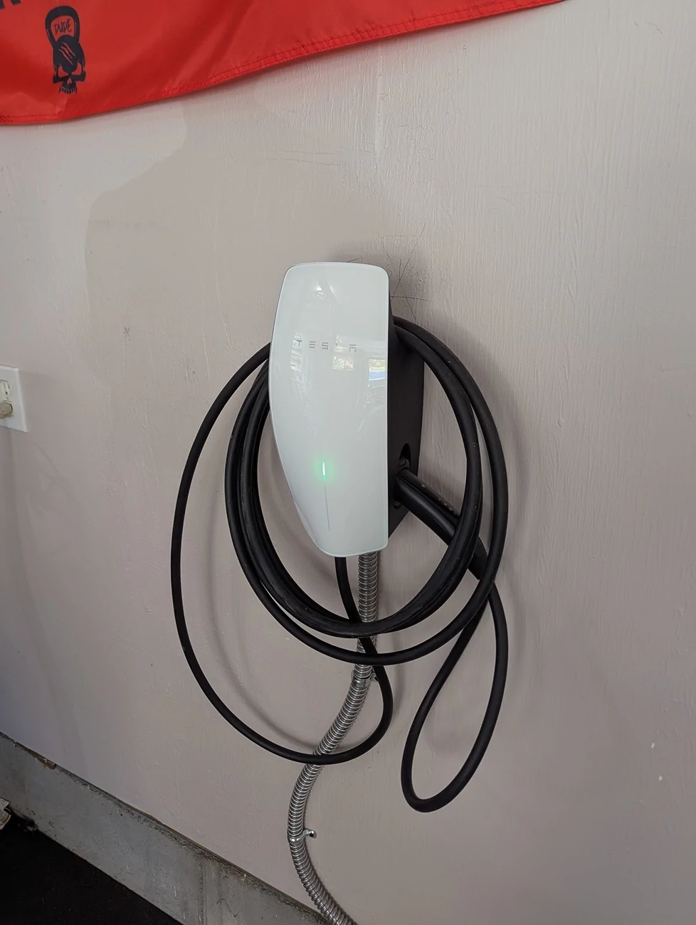

Just got my 48A Tesla UWC installed and the car is showing +17mi in 30 mins charging at 10.8kW but only 5.4kWh added (5.2 kWh to battery). Truck shows average efficiency over my 260mi ownership as 1.9mi/kW.
Super happy with the charge rate but the math doesn't seem to be mathing well?

Miles are not a unit of capacity - so don't look at things that way.
If you charged for 30 minutes at a steady rate of 10.8kW, gaining 5.4 kWh of energy totally lines up (the truck ate .2 kWh to run electronics while you charged).
