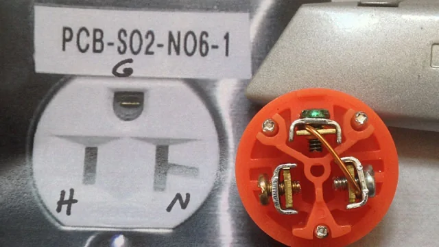

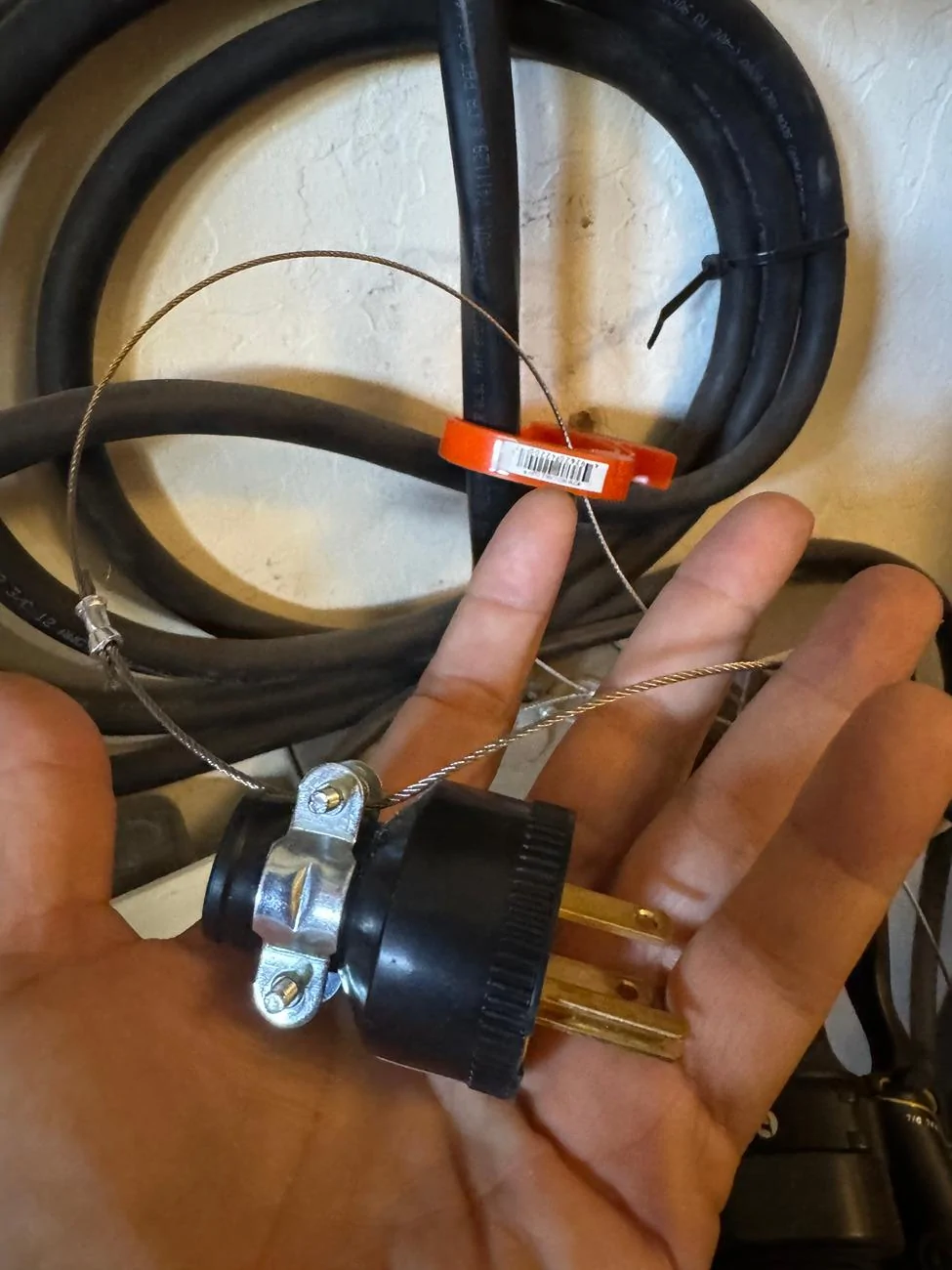

What is the process for this? Like say I have a generator with a 30A plug and some 15A plugs as well. What else would I need to use it to charge my Rivian? (say it is a multi-way power outage and I’ve used the Rivian a dozen times to go buy gas or something and now feel like I should charge it up a little...or maybe it is a few months after the outage and I have all this gas that I don’t otherwise use and want to burn it before it gets too much water and can’t be used in the generator...)
Generators have a floating ground/neutral, and EVSEs will refuse to work on it. So you just need to bond the neutral to the ground. You can do this with a home-made plug in any of the generator outlets. The safest way is with a resistor, but you can just use a small wire. I just keep this hanging from the generator, and plug it in if I want to use the EVSE.
Rivian R1T R1S Charging at RV sites? 1748187775906-dl
The reason it's floating is that an RV or house has its own bonding, and you should never bond neutral to ground in two places.
Ok, so absolutely don’t use it if I’m powering the house with the generator, only use it with the EVSE.
Also: it is absolutely expected that this’ll go into the 15A plug while the EVSE goes into the 30A plug and they two are not electrically isolated (and if they are it won’t work and the EVSE will complain).
Exactly, all that, do not power a house or RV with that on. And I've never run into a generator with isolated plugs, seems impossible really. So bonding one plug bonds them all.

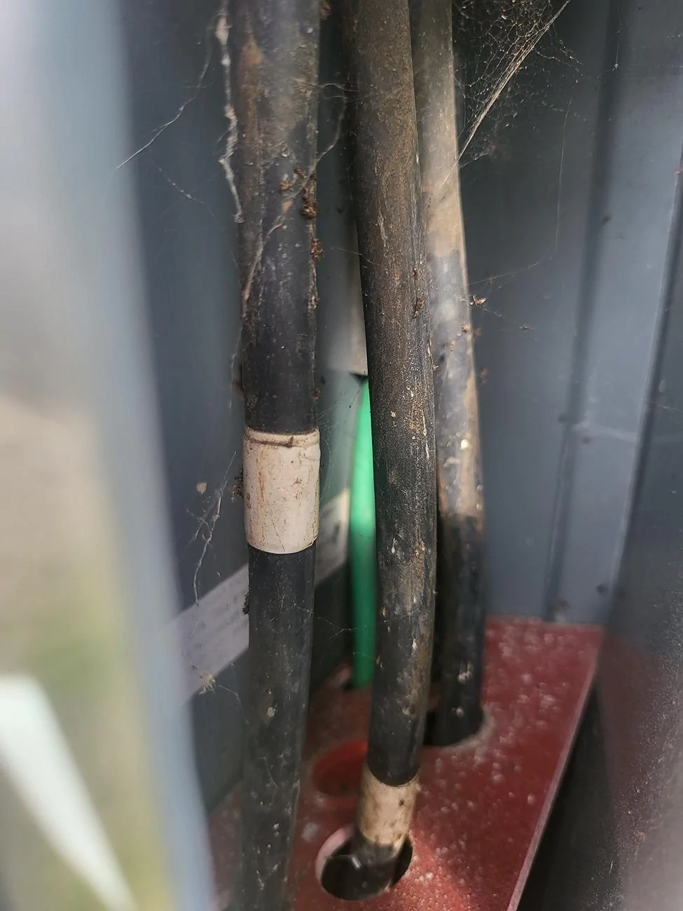

Be careful doing this. My understanding is that the 30 amp uses one of the legs of the 50 amp, so using both the 30 amp and the 50 amp at the same time can seriously overload the shared leg. They are not installed with the intent for them to be used at the same time.
The stands I've looked inside are wired with 1/0 aluminum feeder good for at least 135A.
